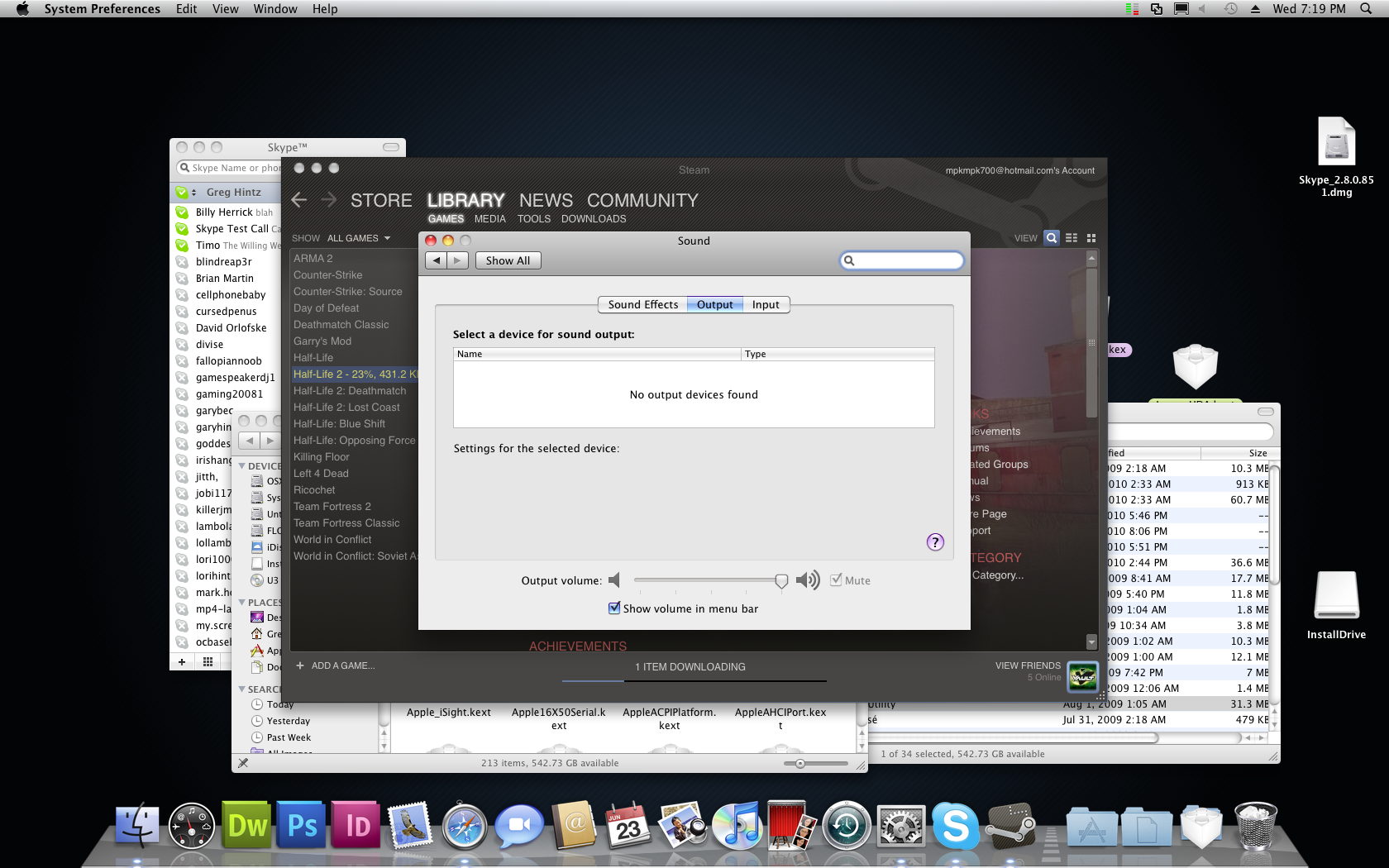

Iv tried the new kexts off kexts.com and nothing when i go to repair i get all kinds of errors saying applehda.kext was not installed right and will not work... I installed using kakewalk pretty impresed audio is the only thing not woking considering it recognized my GTX 275 co-op

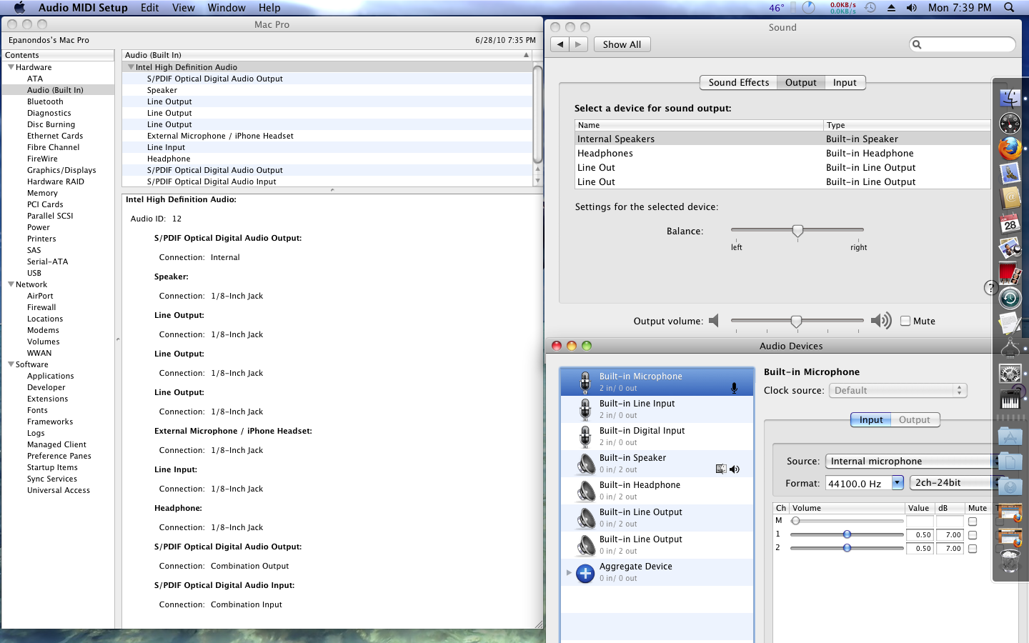

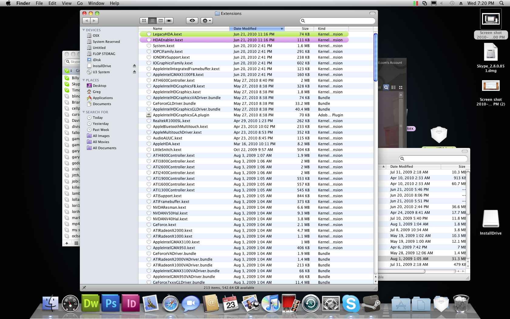

I think I've found the easisest solution for ALC889 in my X58A-UD7 Kakewalk install.
It was already updated to 10.6.4 with combo.
Just download [url="http://www.insanelymac.com/forum/topic/279450-why-insanelymac-does-not-support-tonymacx86/"]#####[/url] from the link:
Before install, delete the LegacyHDA.kext from Extra/Extensions folder.
During the install, select both LegacyHDA & HDA Enabler option for ALC889 along with Rebuild & Repair Permissions options.
WARNING: DO NOT SELECT ANY OTHER OPTIONS. IT MAY CORRUPT THE KAKEWALK INSTALLATION.
Then reboot. Select "Internal Speakers" from the System Preferences > Sound > Output.
Voila!
