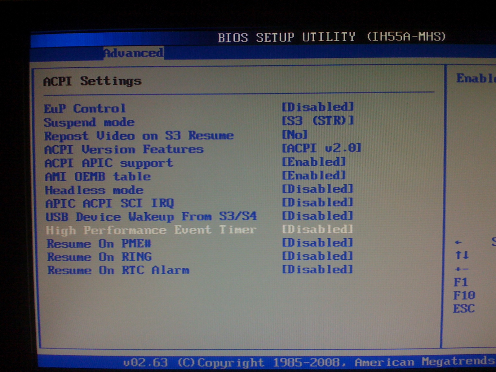

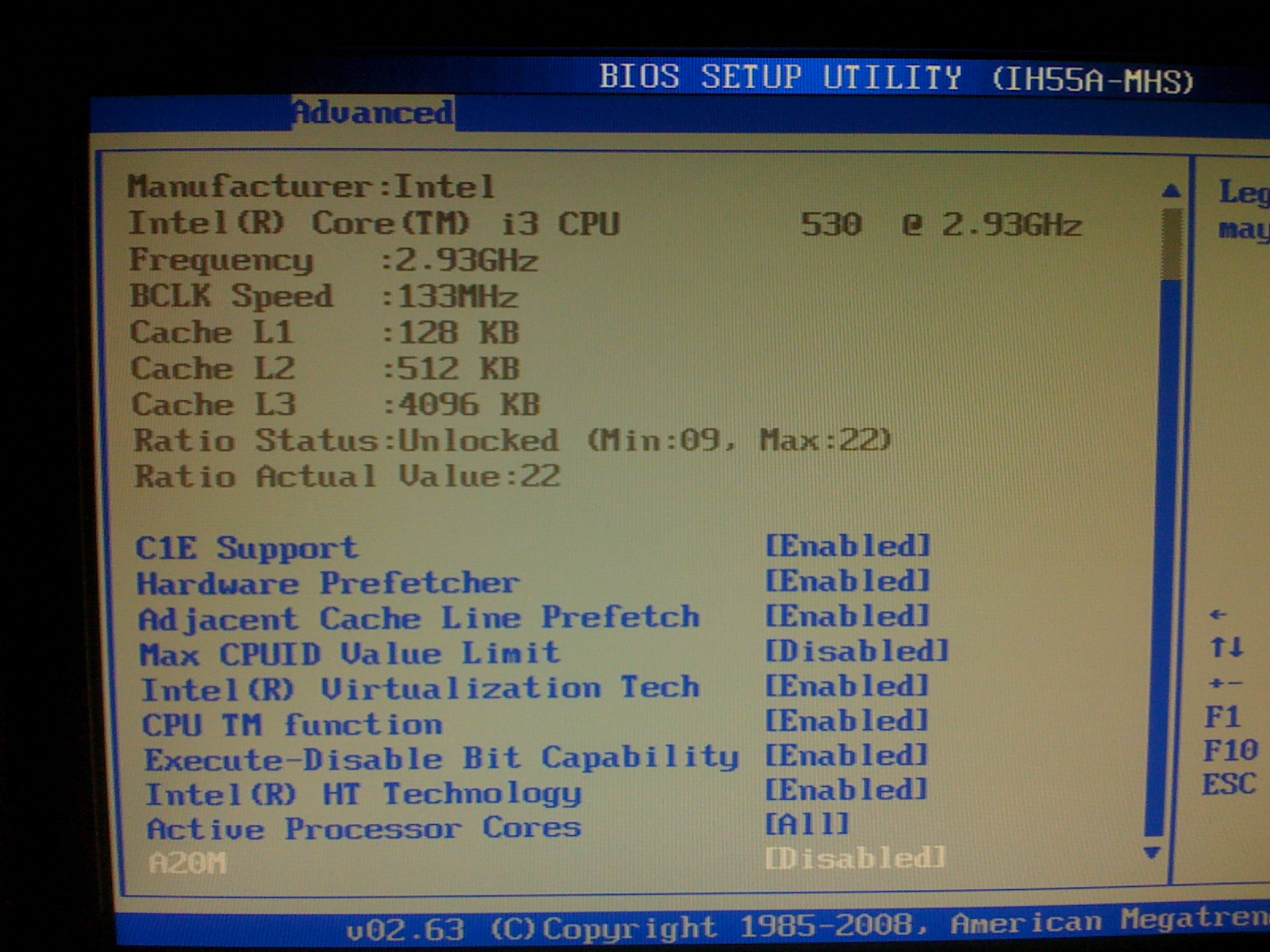

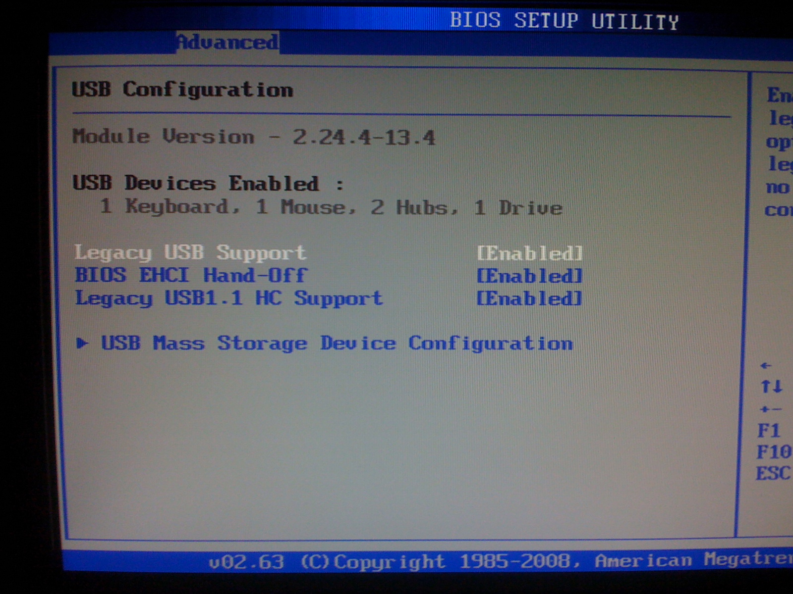

damis648 Posted June 20, 2010 Share Posted June 20, 2010 So, I decided to try out installing Slow Leopard on a Biostar H55 HD. It belongs to a friend of mine, and he wanted to try it out. The basic specs: Intel Core i3-530 nVidia 9400GT ALC662 Audio Realtek Something NIC I'm a bit new at this, having only followed guides to Hackintosh a few computers in the past, but I think I have a pretty good handle on it but need some help. This board seems surprisingly good for installing Snow Leopard. I have succeeded in getting almost everything to work with the following: /Extra/Extensions: IONetworkingFamily.kext FakeSMC.kext OSXRestart.kext /System/Library/Extensions: VoodooHDA.kext Removed AppleHDA.kext No DSDT override. I've attached my current files onto this post. This setup pretty much has everything working, leave only a few problems with sleep. Sleep works fine, except that after wakeup, sometimes USB doesn't work. Sometimes nothing works, and I need to put it back to sleep and wake it up again (via the power button, which I have patched into a DSDT that I've been using just for that purpose), and sometimes only a few things will work, and what doesn't needs to be unplugged and replugged. I've tried various USB fixes around the net, and nothing seems to work. Also, what doesn't work quite correctly is audio after sleep. It sounds garbled and weird, and I've seen that this is a common problem with VoodooHDA, and the only way to fix it is to reload the extension after sleep. I wanted to patch in the audio to the DSDT instead, and use ALC662.kext, except that the audio is nowhere to be found in the DSDT. What should I do? The last issue (only a question, really) is that I'm not sure if SpeedStep is really working. I haven't put anything in the DSDT for the i3-530, and I'm not using NullCPUPowerManagement.kext, and yet MSRTools says that Speedstep and TM1 are functioning. Interestingly, though, the frequency seems to be stuck at 0.9Ghz. (Also, the temperatures are always under 30C, so I have a feeling it's at least working partially.) I've attached the DSDT I pulled from a Linux livecd, and also a modified one which contains these modifications: 1. Removed CPU Aliases 2. Added DTGP Method 3. HPET Fix (don't know if needed) 4. Removed IRQs from RTC 5. Power Button fix 6. Set to always load Vista defaults Thanks if anyone can answer any of my questions. EDIT: Also, a few things. This is running 10.6.4, which I am told is why I can use the vanilla kernel. For 10.6.3 and lower, the Qoopz kernel (or similar) must be used to run on an unsupported cpu. If PS2 or ATA support is needed, the corresponding Kexts can be found in the ExtraKexts.zip. DSDTs.zip WorkingFiles.zip ExtraKexts.zip Link to comment Share on other sites More sharing options...

damis648 Posted July 17, 2010 Author Share Posted July 17, 2010 I used retail with myHack, I think. This was a while ago... I haven't done anything with it since since nobody can shed any light on the sleep + usb issue. After installing, I just installed Chameleon and started using that (with the provided kexts linked in my first post...), and nothing else (no myHack installer or [url="http://www.insanelymac.com/forum/topic/279450-why-insanelymac-does-not-support-tonymacx86/"]#####[/url]). Also, bsd43, I'm pretty sure I had HPET off. I will have to look though. EDIT: Yup. Here are the relevant sections. Link to comment Share on other sites More sharing options...

taicyber Posted July 30, 2010 Share Posted July 30, 2010 Hi damis648 I found the way to fix usb problem on Biostart TH55 mobo. I used [url="http://www.insanelymac.com/forum/topic/279450-why-insanelymac-does-not-support-tonymacx86/"]#####[/url] from tomosx86 and choosed Roll back to 10.6.3 usb fix. Link to comment Share on other sites More sharing options...

_Jay_ Posted August 27, 2010 Share Posted August 27, 2010 Interesting, I'll have to try that. http://www.tonymacx86.com/dsdt.php Check that link often for updated DSDTs. Google 'minimal edits for DSDT'. That should show you the sleep fix which will fix Sleep/Restart/Shutdown issues. Edit: Your bios setting for HPET should be set to 64-bit support instead of Off. Jay Link to comment Share on other sites More sharing options...
