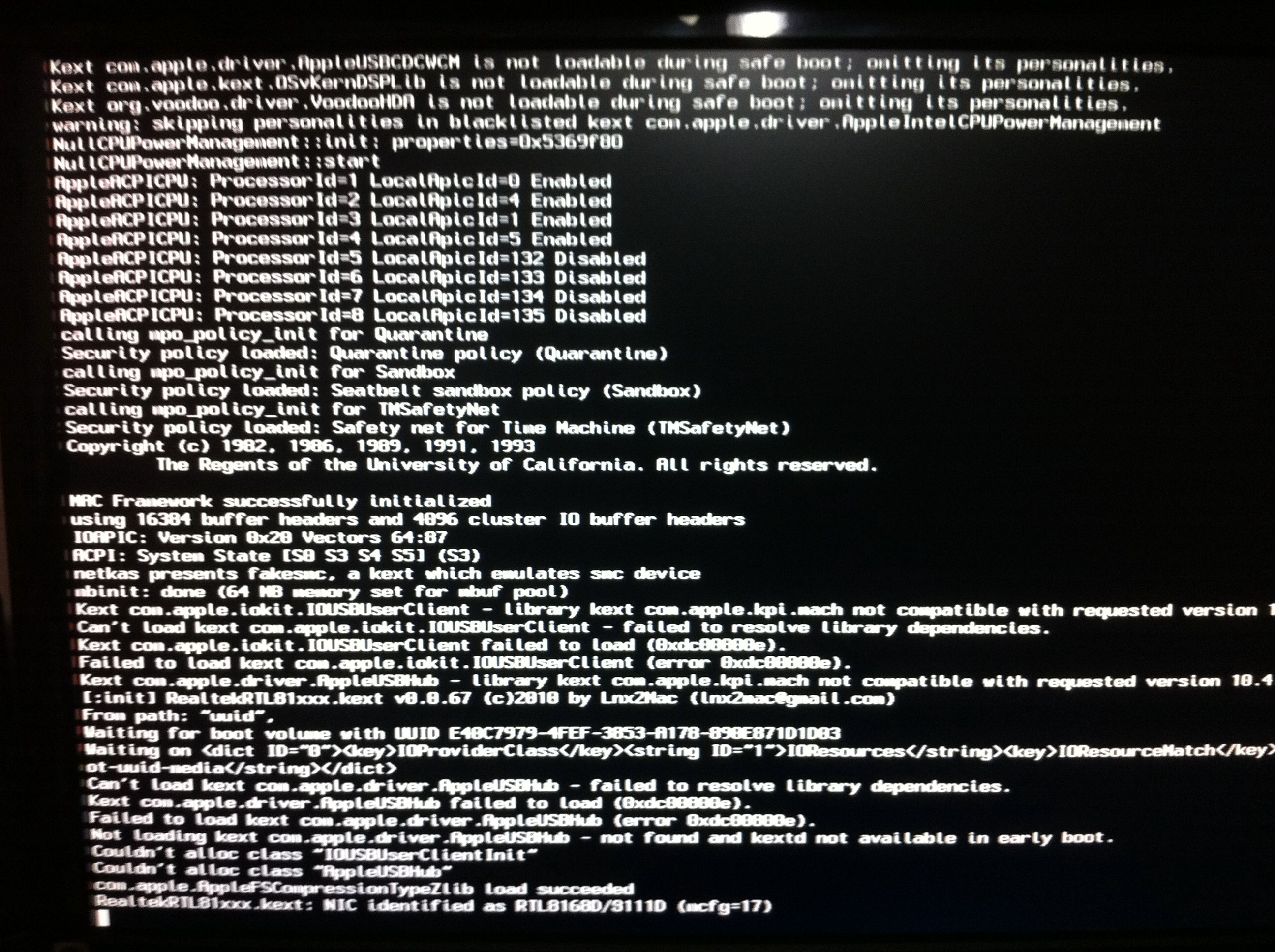

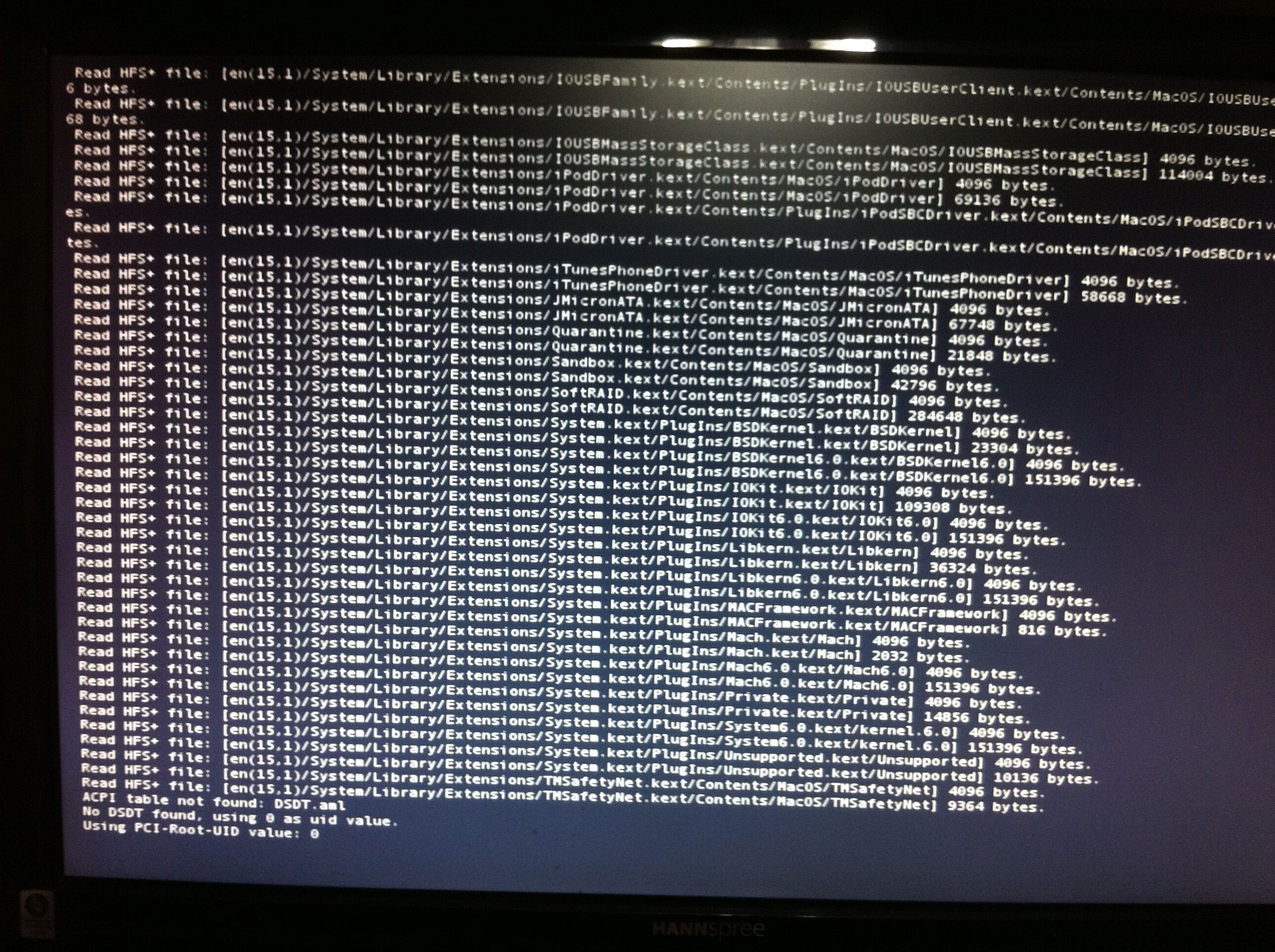

onggiadzit Posted May 6, 2011 Share Posted May 6, 2011 Hello, What is wrong????? I am a newbie, and having problems with my first HACKINTOSH. Hardware: Mother board: Biostar H55 HD CPU: I5 K655 Video: On board MEM: 4 GB USB Keyboard and Mouse Bios: ASTA = AHCI ACPI Supend type = S3 (STR) HPET = Disable MAC OSX Snow Leopard 10.6.3 (Retail DVD) After started up with [url="http://www.insanelymac.com/forum/topic/279450-why-insanelymac-does-not-support-tonymacx86/"]#####[/url] and selected to start OSX it's hung -- see pic attached Link to comment https://www.insanelymac.com/forum/topic/221870-biostar-h55-hd/page/2/#findComment-1679723 Share on other sites More sharing options...

TheExpertComputerRepairs Posted May 16, 2011 Share Posted May 16, 2011 Hello, What is wrong????? I am a newbie, and having problems with my first HACKINTOSH. Hardware: Mother board: Biostar H55 HD CPU: I5 K655 Video: On board MEM: 4 GB USB Keyboard and Mouse Bios: ASTA = AHCI ACPI Supend type = S3 (STR) HPET = Disable MAC OSX Snow Leopard 10.6.3 (Retail DVD) After started up with [url="http://www.insanelymac.com/forum/topic/279450-why-insanelymac-does-not-support-tonymacx86/"]#####[/url] and selected to start OSX it's hung -- see pic attached On your first boot you need to use the "-f" flag. I would use "-v -f -s PCIRootUID=1" Single user mode is important for making sure permissions are set correctly. It will pause during the boot sequence, and give you a > prompt. Type "/sbin/fsck -fy" then after that finishes type "/sbin/mount -uw /". That will finish, then type "logout" to continue the boot. Also, pretty sure you need the HPET turned ON in BIOS, otherwise you get problems with ElliotForceLegacyRTC.kext I think Link to comment https://www.insanelymac.com/forum/topic/221870-biostar-h55-hd/page/2/#findComment-1684310 Share on other sites More sharing options...
