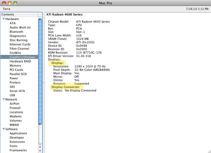

errandwolfe Posted July 27, 2010 Author Share Posted July 27, 2010 Here is something I noticed though and maybe this will help send you down the right path. If you take a look at the screen shot I have posted.... OS X is in fact picking up both display ports....BUT...It looks like it is trying to read an Apple Display Connector rather then VGA, DVI, or HDMI. Perhaps the data you need to be looking for is the definition of what each port actually DOES (VGA.DVI, etc..) rather then it being a power issue. If you could find that section that defines the second connection as ADC and instead describe it as VGA or DVI then perhaps the port would actually initialize and power on properly. Link to comment https://www.insanelymac.com/forum/topic/221342-radeon-4650-1064-still-no-dual-screen/#findComment-1519491 Share on other sites More sharing options...
