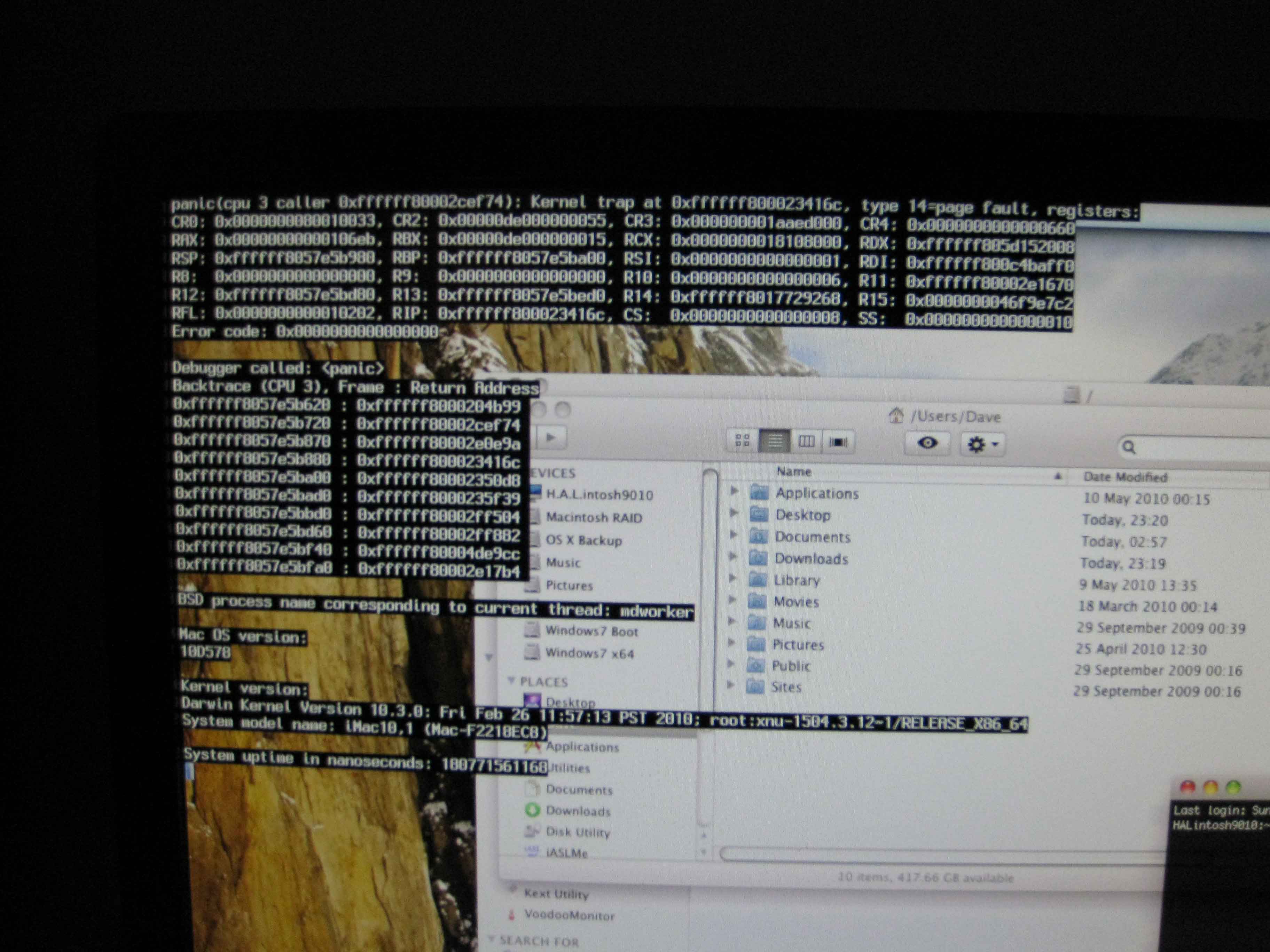

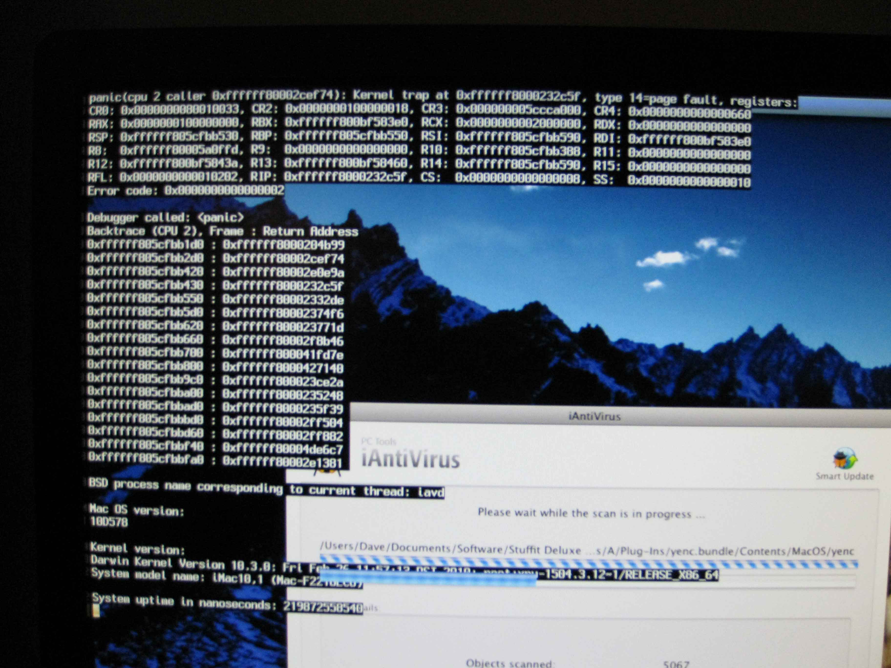

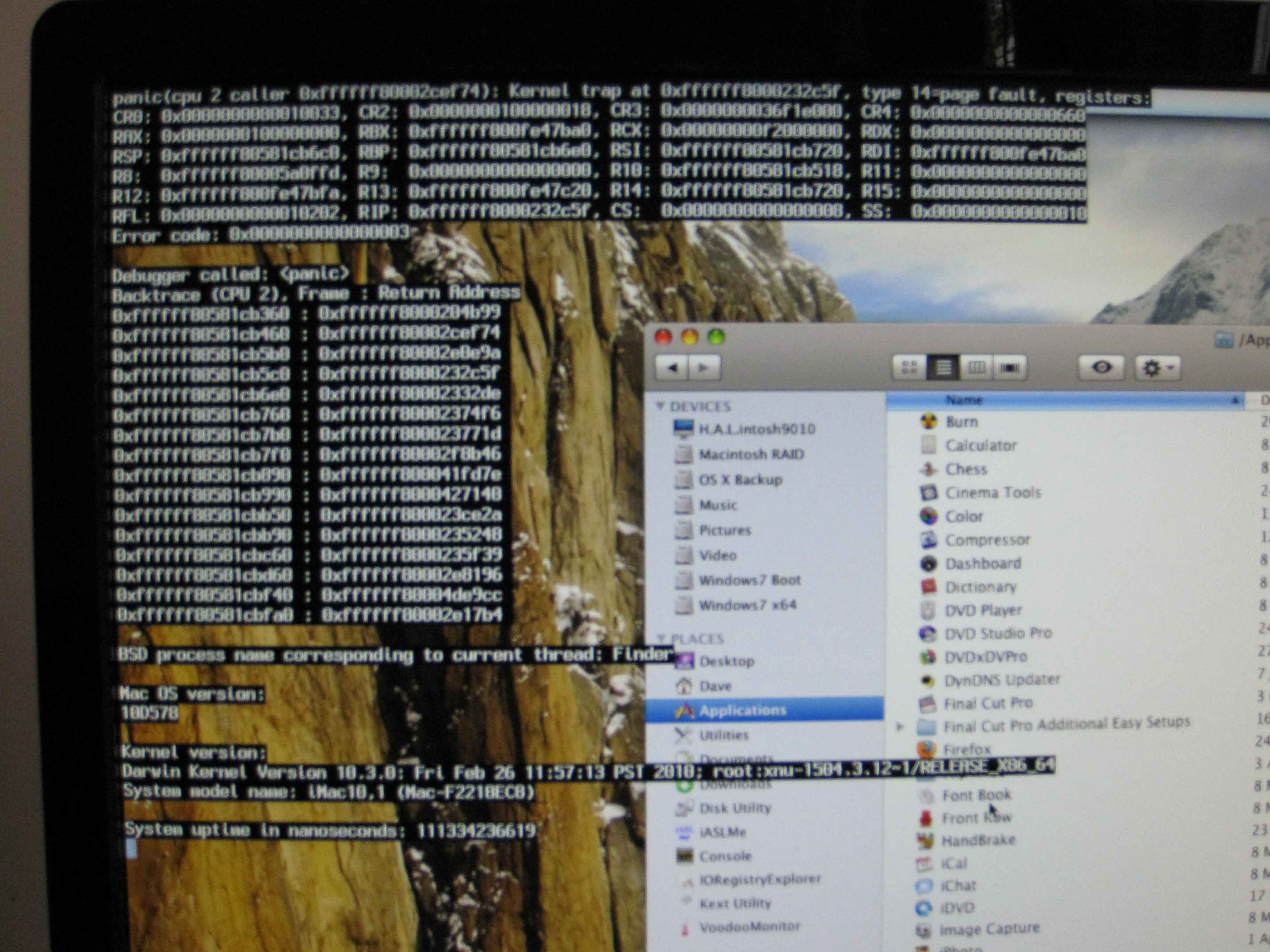

FKA Posted May 17, 2010 Author Share Posted May 17, 2010 It aint firefox .. Ok I've had 4 KP's during normal operation, all relating to different processes: And one for firefox.bn that i didn't take a snap of .. Really stumped .... last ditch (well second to last as last ditch is a reinstall in case I've royally screwed something up.) is to try without paragon NTFS ... but noone has reported LP64 issues with the latest paragon build !!! ??? Virus ?? Arrrgh .... I love it ... ! ... i think Link to comment https://www.insanelymac.com/forum/topic/217874-solved-msi-neo3-fr-p45-lp64-niggles/#findComment-1469898 Share on other sites More sharing options...
FKA Posted May 29, 2010 Author Share Posted May 29, 2010 Still struggling with random KP on shutdown and during normal operation. Am currently testing with a fresh bare-bones install on single HDD with minimal DSDT edits. Posting this more as a memo to myself: Suspect RAM issue, System Profiler > Diagnostics reports failed test, RAM error. KP seems to corrolate with RAM hungry processes. mds for example. Can garantee a KP when using Crabon Cloner to backup to internal HDD so will test by running this process. (Again the KP is relating to differant processes each time. NOT CCCloner.) ToDo - Run Rember check for errors - remove OC jumpers and test un clocked. - check RAM timing - currently set manually to RAM spec 4, 4, 4, 12 - maybe try 'auto' - test with just one 2GB stick - alternate RAM sticks removed. And sticks in A then B channel - test with spare 500MB 667 stick. - Phone a friend - Use get out of jail free card ! D Link to comment https://www.insanelymac.com/forum/topic/217874-solved-msi-neo3-fr-p45-lp64-niggles/#findComment-1478063 Share on other sites More sharing options...
FKA Posted May 31, 2010 Author Share Posted May 31, 2010 OK - doesn't matter what i try RAM wise I still get the KP's. Don't ever complete REMBER test In fact memtest.exe shows no errors unclocked or with my original BIOS settings. I already knew this!!! Currently only hvae fakeSMC.kext in E/E. now using 2.5 rev93 edited for iMac9,1 (thanks Beerkext'd + slice, netkas et al.) but had same issue with iMac10,1 and faceSMC 2.5 from netkas blog . Attached Rember log, DSDT, boot.plist and smbios ... as ever, any help appreciated log from restart to crash to restart running rember 31/05/2010 22:49:07 SMARTReporter[247] Error: GetMACAddress returned 0x00000005 31/05/2010 22:49:07 SMARTReporter[247] Drive: 'SAMSUNG HD322HJ ( | S17AJ90S110087 | disk2)' Status: SMARTOK (S.M.A.R.T. condition not exceeded, drive OK) 31/05/2010 22:49:08 SMARTReporter[247] Drive: 'SAMSUNG HD321KJ ( | S0MQJDWQ182486 | disk1)' Status: SMARTOK (S.M.A.R.T. condition not exceeded, drive OK) 31/05/2010 22:49:08 SMARTReporter[247] Drive: 'Hitachi HDT725025VLA380 (Windows7 Boot, Windows7 x64 | VFL101R6CL2RHT | disk0)' Status: SMARTOK (S.M.A.R.T. condition not exceeded, drive OK) 31/05/2010 22:49:08 SMARTReporter[247] Drive: 'ExcelStor Technology J9250S (OS X Backup | GEK230T2ABW51B | disk4)' Status: SMARTOK (S.M.A.R.T. condition not exceeded, drive OK) 31/05/2010 22:49:08 SMARTReporter[247] Drive: 'SAMSUNG HD103UJ (Music, Pictures, Video | S13PJDWS256292 | disk3)' Status: SMARTOK (S.M.A.R.T. condition not exceeded, drive OK) 31/05/2010 22:49:44 WindowServer[197] kCGErrorFailure: Set a breakpoint @ CGErrorBreakpoint() to catch errors as they are logged. 31/05/2010 22:49:44 com.apple.WindowServer[197] Mon May 31 22:49:44 Daves-iMac.local WindowServer[197] : kCGErrorFailure: Set a breakpoint @ CGErrorBreakpoint() to catch errors as they are logged. 31/05/2010 22:49:45 com.apple.launchd.peruser.501[115] (com.apple.AirPortBaseStationAgent[241]) Exited: Killed 31/05/2010 22:49:45 loginwindow[196] DEAD_PROCESS: 196 console 31/05/2010 22:49:45 com.apple.kextd[10] Error reconsidering volume /Volumes/Windows7 Boot. 31/05/2010 22:49:45 shutdown[254] reboot by Dave: 31/05/2010 22:49:45 shutdown[254] SHUTDOWN_TIME: 1275342585 351328 31/05/2010 22:49:45 com.apple.SecurityServer[58] Session 0x402d81 dead 31/05/2010 22:49:45 com.apple.SecurityServer[58] Killing auth hosts 31/05/2010 22:49:45 com.apple.SecurityServer[58] Session 0x402d81 destroyed 31/05/2010 22:49:45 DirectoryService[15] BUG in libdispatch: 10D578 - 1960 - 0x10004004 31/05/2010 22:49:45 mDNSResponder[62] mDNSResponder mDNSResponder-214.3 (Feb 11 2010 04:49:16) stopping 31/05/2010 22:49:45 WindowServer[197] hidd died. Reestablishing connection. 31/05/2010 22:49:45 WindowServer[197] bootstrap_look_ip failed: Unknown service name 31/05/2010 22:49:45 kernel systemShutdown true 31/05/2010 22:50:13 kernel npvhash=4095 31/05/2010 22:50:13 kernel PAE enabled 31/05/2010 22:50:13 kernel 64 bit mode enabled 31/05/2010 22:50:13 kernel Darwin Kernel Version 10.3.0: Fri Feb 26 11:58:09 PST 2010; root:xnu-1504.3.12~1/RELEASE_I386 31/05/2010 22:50:13 kernel vm_page_bootstrap: 973180 free pages and 75396 wired pages 31/05/2010 22:50:13 kernel standard timeslicing quantum is 10000 us 31/05/2010 22:50:13 kernel mig_table_max_displ = 73 31/05/2010 22:50:13 kernel AppleACPICPU: ProcessorId=1 LocalApicId=0 Enabled 31/05/2010 22:50:13 kernel AppleACPICPU: ProcessorId=2 LocalApicId=1 Enabled 31/05/2010 22:50:13 kernel AppleACPICPU: ProcessorId=3 LocalApicId=2 Enabled 31/05/2010 22:50:13 kernel AppleACPICPU: ProcessorId=4 LocalApicId=3 Enabled 31/05/2010 22:50:13 kernel calling mpo_policy_init for Quarantine 31/05/2010 22:50:13 kernel Security policy loaded: Quarantine policy (Quarantine) 31/05/2010 22:50:13 kernel calling mpo_policy_init for Sandbox 31/05/2010 22:50:13 kernel Security policy loaded: Seatbelt sandbox policy (Sandbox) 31/05/2010 22:50:13 kernel calling mpo_policy_init for TMSafetyNet 31/05/2010 22:50:13 kernel Security policy loaded: Safety net for Time Machine (TMSafetyNet) 31/05/2010 22:50:13 kernel Copyright © 1982, 1986, 1989, 1991, 1993 31/05/2010 22:50:13 kernel The Regents of the University of California. All rights reserved. 31/05/2010 22:50:13 kernel MAC Framework successfully initialized 31/05/2010 22:50:13 kernel using 16384 buffer headers and 4096 cluster IO buffer headers 31/05/2010 22:50:13 kernel VoodooMonitor: © 2009 Mojodojo, All Rights Reserved. Based on VoodooPower code by superhai. Special thanks to markswell for cpuid utilities. 31/05/2010 22:50:13 kernel IOAPIC: Version 0x20 Vectors 64:87 31/05/2010 22:50:13 kernel ACPI: System State [s0 S3 S4 S5] (S3) 31/05/2010 22:50:13 kernel RTC: Only single RAM bank (128 bytes) 31/05/2010 22:50:13 kernel FakeSMC: Opensource SMC device emulator by netkas © 2009 31/05/2010 22:50:13 kernel FakeSMC: Monitoring plugins support by mozodojo © 2010 31/05/2010 22:50:13 kernel FakeSMC: Original idea of plugins and code sample by usr-sse2 © 2010mbinit: done (64 MB memory set for mbuf pool) 31/05/2010 22:50:13 kernel From path: "uuid", 31/05/2010 22:50:13 kernel Waiting for boot volume with UUID D2F1710B-A362-3B19-9988-CA6E9447FB72 31/05/2010 22:50:13 kernel Waiting on IOProviderClassIOResourcesIOResourceMatchboot-uuid-media 31/05/2010 22:50:13 kernel com.apple.AppleFSCompressionTypeZlib load succeeded 31/05/2010 22:50:13 kernel AppleIntelCPUPowerManagementClient: ready 31/05/2010 22:50:13 kernel Got boot device = IOService:/AppleACPIPlatformExpert/PCI0@0/AppleACPIPCI/SATA@1F,2/AppleAHCI/CHN0@0/IOAHCIDevice@0/AppleAHCIDiskDriver/IOAHCIBlockStorageDevice/IOBlockStorageDriver/SAMSUNG HD322HJ Media/IOGUIDPartitionScheme/Raid Partition 1@2/AppleRAIDMember/AppleRAIDStripeSet/Macintosh RAID@0 31/05/2010 22:50:13 kernel BSD root: disk5, major 14, minor 19 31/05/2010 22:50:13 kernel USBMSC Identifier (non-unique): 1738401AE1C27DAA 0x781 0x5408 0x200 31/05/2010 22:50:10 com.apple.launchd[1] *** launchd[1] has started up. *** 31/05/2010 22:50:10 com.apple.launchd[1] *** Verbose boot, will log to /dev/console. *** 31/05/2010 22:50:14 kernel systemShutdown false 31/05/2010 22:50:14 configd[13] network configuration changed. 31/05/2010 22:50:14 configd[13] setting hostname to "Daves-iMac.local" 31/05/2010 22:50:15 kernel AppleIntelCPUPowerManagement: initialization complete 31/05/2010 22:50:19 kernel NTFS driver 3.2 [Flags: R/W]. 31/05/2010 22:50:19 kernel NTFS volume name Windows7 Boot, version 3.1. 31/05/2010 22:50:19 kernel NTFS volume name Windows7 x64, version 3.1. 31/05/2010 22:50:19 kernel NVDANV50HAL loaded and registered. 31/05/2010 22:50:20 kernel Warning - kext com.apple.iokit.CHUDKernLib has immediate dependencies on both com.apple.kernel* and com.apple.kpi.* components; use only one style. 31/05/2010 22:50:20 bootlog[80] BOOT_TIME: 1275342610 0 31/05/2010 22:50:20 kernel Warning - kext com.apple.iokit.CHUDProf has immediate dependencies on both com.apple.kernel* and com.apple.kpi.* components; use only one style. 31/05/2010 22:50:20 kernel DSMOS has arrived 31/05/2010 22:50:20 kernel AppleRTL8169Ethernet: Ethernet address 00:21:85:1c:85:1b 31/05/2010 22:50:20 mDNSResponder[68] mDNSResponder mDNSResponder-214.3 (Feb 11 2010 04:49:16) starting 31/05/2010 22:50:22 com.apple.usbmuxd[61] usbmuxd-190 built for iTunesNineOne on Mar 8 2010 at 20:25:36, running 32 bit 31/05/2010 22:50:23 com.apple.SecurityServer[64] Session 0x5fbff962 created 31/05/2010 22:50:23 /System/Library/CoreServices/loginwindow.app/Contents/MacOS/loginwindow[69] Login Window Application Started 31/05/2010 22:50:23 com.apple.SecurityServer[64] Entering service 31/05/2010 22:50:23 configd[13] network configuration changed. 31/05/2010 22:50:23 kernel IPv6 packet filtering initialized, default to accept, logging disabled 31/05/2010 22:50:23 configd[13] network configuration changed. 31/05/2010 22:50:23 configd[13] network configuration changed. 31/05/2010 22:50:32 com.apple.SecurityServer[64] Session 0x414f2f created 31/05/2010 22:50:32 com.apple.SecurityServer[64] Session 0x414f2f attributes 0x30 31/05/2010 22:50:32 loginwindow[69] Login Window Started Security Agent 31/05/2010 22:50:32 SecurityAgent[113] User info context values set for Dave 31/05/2010 22:50:32 SecurityAgent[113] Login Window login proceeding 31/05/2010 22:50:32 SecurityAgent[113] Login Window done 31/05/2010 22:50:32 loginwindow[69] Login Window - Returned from Security Agent 31/05/2010 22:50:32 loginwindow[69] USER_PROCESS: 69 console 31/05/2010 22:50:32 com.apple.launchd.peruser.501[114] (com.apple.ReportCrash) Falling back to default Mach exception handler. Could not find: com.apple.ReportCrash.Self 31/05/2010 22:50:33 com.apple.launchd.peruser.501[114] (com.apple.Kerberos.renew.plist[141]) Exited with exit code: 1 31/05/2010 22:50:33 SMARTReporter[148] Error: GetMACAddress returned 0x00000005 31/05/2010 22:50:33 SMARTReporter[148] Error: GetMACAddress returned 0x00000005 31/05/2010 22:50:33 SMARTReporter[148] Error: GetMACAddress returned 0x00000005 31/05/2010 22:50:33 SMARTReporter[148] Drive: 'SAMSUNG HD322HJ ( | S17AJ90S110087 | disk1)' Status: SMARTOK (S.M.A.R.T. condition not exceeded, drive OK) 31/05/2010 22:50:34 SMARTReporter[148] Drive: 'SAMSUNG HD321KJ ( | S0MQJDWQ182486 | disk2)' Status: SMARTOK (S.M.A.R.T. condition not exceeded, drive OK) 31/05/2010 22:50:34 SMARTReporter[148] Drive: 'Hitachi HDT725025VLA380 (Windows7 Boot, Windows7 x64 | VFL101R6CL2RHT | disk0)' Status: SMARTOK (S.M.A.R.T. condition not exceeded, drive OK) 31/05/2010 22:50:34 SMARTReporter[148] Drive: 'ExcelStor Technology J9250S (OS X Backup | GEK230T2ABW51B | disk4)' Status: SMARTOK (S.M.A.R.T. condition not exceeded, drive OK) 31/05/2010 22:50:34 SMARTReporter[148] Drive: 'SAMSUNG HD103UJ (Music, Pictures, Video | S13PJDWS256292 | disk3)' Status: SMARTOK (S.M.A.R.T. condition not exceeded, drive OK) 31/05/2010 22:50:55 Rember[154] Got process:loginwindow 31/05/2010 22:50:55 Rember[154] Not quitting loginwindow 31/05/2010 22:50:55 Rember[154] Got process:Dock 31/05/2010 22:50:55 Rember[154] Not quitting Dock 31/05/2010 22:50:55 Rember[154] Got process:SystemUIServer 31/05/2010 22:50:55 Rember[154] Not quitting SystemUIServer 31/05/2010 22:50:55 Rember[154] Got process:Finder 31/05/2010 22:50:55 Rember[154] Got Finder 31/05/2010 22:50:55 Rember[154] Got process:Quick Look Helper 31/05/2010 22:50:55 Rember[154] Quitting:Quick Look Helper 31/05/2010 22:50:55 Rember[154] Got process:AirPort Base Station Agent 31/05/2010 22:50:55 Rember[154] Quitting:AirPort Base Station Agent 31/05/2010 22:50:55 Rember[154] Got process:SMARTReporter 31/05/2010 22:50:55 Rember[154] Quitting:SMARTReporter 31/05/2010 22:50:55 com.apple.launchd.peruser.501[114] (com.apple.AirPortBaseStationAgent[143]) Exited: Terminated 31/05/2010 22:50:55 Rember[154] Not quitting ourselves 31/05/2010 22:50:55 com.apple.launchd.peruser.501[114] ([0x0-0xa00a].org.corecode.SMARTReporter[148]) Exited: Terminated 31/05/2010 22:50:55 Rember[154] Got process:loginwindow 31/05/2010 22:50:55 Rember[154] Not quitting loginwindow 31/05/2010 22:50:55 Rember[154] Got process:Dock 31/05/2010 22:50:55 Rember[154] Not quitting Dock 31/05/2010 22:50:55 Rember[154] Got process:SystemUIServer 31/05/2010 22:50:55 Rember[154] Not quitting SystemUIServer 31/05/2010 22:50:55 Rember[154] Got process:Finder 31/05/2010 22:50:55 Rember[154] Got Finder 31/05/2010 22:50:55 Rember[154] Not quitting ourselves 31/05/2010 22:50:55 Rember[154] Quitting Finder 31/05/2010 22:50:55 com.apple.launchd.peruser.501[114] (com.apple.Finder[120]) Exited: Terminated 31/05/2010 22:50:57 Rember[154] Detected test sequence: 1 31/05/2010 23:00:16 com.apple.kextcache[174] Created prelinked kernel /System/Library/Caches/com.apple.kext.caches/Startup/kernelcache_i386.A801000D. 31/05/2010 23:07:44 kernel npvhash=4095 31/05/2010 23:00:33 /System/Library/CoreServices/CCacheServer.app/Contents/MacOS/CCacheServer[146] No valid tickets, timing out 31/05/2010 23:07:44 kernel PAE enabled 31/05/2010 23:07:44 kernel 64 bit mode enabled 31/05/2010 23:07:44 kernel Darwin Kernel Version 10.3.0: Fri Feb 26 11:58:09 PST 2010; root:xnu-1504.3.12~1/RELEASE_I386 31/05/2010 23:07:44 kernel vm_page_bootstrap: 973180 free pages and 75396 wired pages 31/05/2010 23:07:44 kernel standard timeslicing quantum is 10000 us Obviously not doing this with i386 (i know its in boot.plist just is current.) EDIT - sorry being a bit of an idiot here - clearly that log shows booting i386 .... and yes it is crashing with 32bit kernel and 64 bit kernel when running anything that stresses the machine , CPU test, rember , HDD backup operation .. ! Have tried various Cameleon 2 RC3 and 4 and PCEFI10.5 's current RD5 pre12 trunk com.apple.Boot.plist.zip SMBIOS.plist.zip DSDT26_05_10.dsl.zip D Link to comment https://www.insanelymac.com/forum/topic/217874-solved-msi-neo3-fr-p45-lp64-niggles/#findComment-1479385 Share on other sites More sharing options...
