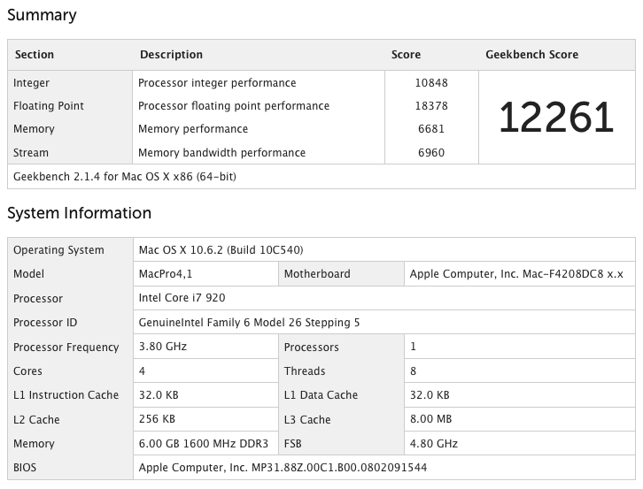

smeared Posted February 6, 2010 Share Posted February 6, 2010 my quick suggestion for you. asus p6t, core i7 920, 6gb corsair 1600 ram, etc etc.. You won't be sorry.. that's all you really need. Link to comment https://www.insanelymac.com/forum/topic/209773-ssd-corei7-dual-boot-awesometastic/#findComment-1405108 Share on other sites More sharing options...
icedrake Posted February 6, 2010 Share Posted February 6, 2010 my quick suggestion for you. asus p6t, core i7 920, 6gb corsair 1600 ram, etc etc.. You won't be sorry.. that's all you really need. I'll second the call for the P6T, though more specifically look at the Deluxe V2 or the SE -- I haven't been able to find anything about getting the base P6T to work, but I can tell you that as of six days ago, the Deluxe V2 has been doing (mostly) great for me. The front-side USB ports aren't functional at the moment, but I haven't tried overly hard to fix them yet. Also, I'm unable to boot without going through the Chameleon CD, but I have strong suspicions that's not due to the motherboard. Link to comment https://www.insanelymac.com/forum/topic/209773-ssd-corei7-dual-boot-awesometastic/#findComment-1405121 Share on other sites More sharing options...

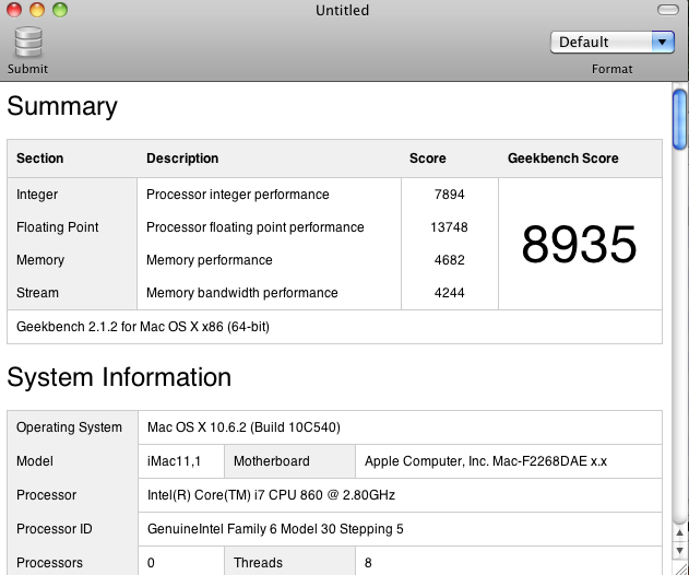

PunkHop Posted February 15, 2010 Author Share Posted February 15, 2010 Here's what I ended up building. Antec P183 Black Aluminum Case Intel Core i7 860 6GB OCZ Gold RAM Gigabyte GA-P55A-UD3 EVGA 9800 GTX 2 x 60GB OCZ Vertex Turbo SSDs I've got everything working (!), used tonymacx86's install guide. 10.6.2 and Windows 7, both in 64bit. Awesome. Here's my Geekbench score. Is that what I should be getting for a system like this? I've never used it before so I don't have anything to compare it to. Edit: Just found this page, I guess my score is pretty good? http://www.primatelabs.ca/blog/mac-benchmarks/ Link to comment https://www.insanelymac.com/forum/topic/209773-ssd-corei7-dual-boot-awesometastic/#findComment-1410945 Share on other sites More sharing options...
klh6686 Posted February 19, 2010 Share Posted February 19, 2010 any plans for overclocking? IMO that is one of the biggest draws for running a hackintosh, being able to do something the mac elitist's can't. score: Link to comment https://www.insanelymac.com/forum/topic/209773-ssd-corei7-dual-boot-awesometastic/#findComment-1413049 Share on other sites More sharing options...
PunkHop Posted February 19, 2010 Author Share Posted February 19, 2010 any plans for overclocking? IMO that is one of the biggest draws for running a hackintosh, being able to do something the mac elitist's can't. score: I suppose I should, yeah... as I've read that the i7 is ripe for overclocking. I don't have the technical skill to just go into the BIOS and know what to change to keep everything clean and copacetic, I'd have to follow a guide. Any tips or links to the best guide for my setup with my 860 and 6GB RAM? Link to comment https://www.insanelymac.com/forum/topic/209773-ssd-corei7-dual-boot-awesometastic/#findComment-1413052 Share on other sites More sharing options...
