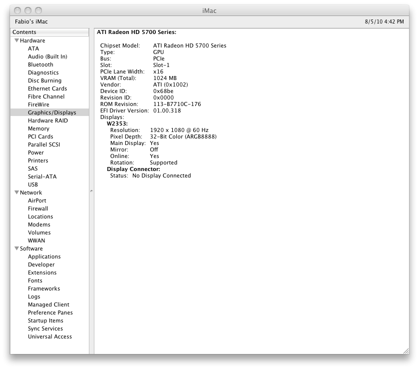

redvulps Posted August 5, 2010 Share Posted August 5, 2010 Ooooook, good news for 5750 users. Now i have my XFX Radeon 5750 working with both DVI at 1920x1080. Used this amazing tutorial: https://docs.google.com/fileview?id=0B8c6FQ...4MDEy&hl=en But changed my ATY_Init to use Vervet(i'll be attaching). GraphicsEnabler=No and only tested 32bit, aaand still not tested the HDMI output. i'll be doing some tests later and updating here. ATY_Init.kext.zip Link to comment https://www.insanelymac.com/forum/topic/203959-radeon-hd-5750/page/2/#findComment-1525345 Share on other sites More sharing options...

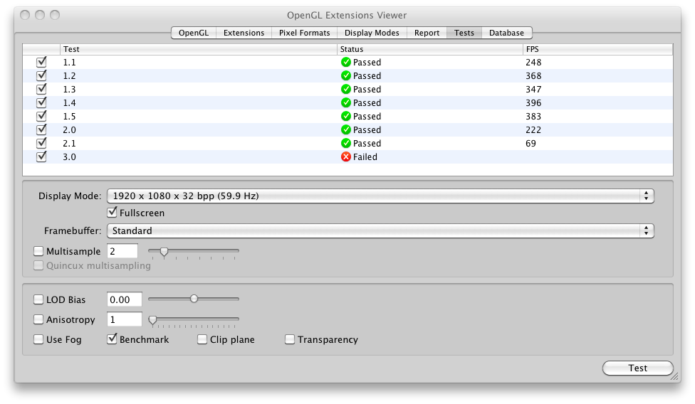

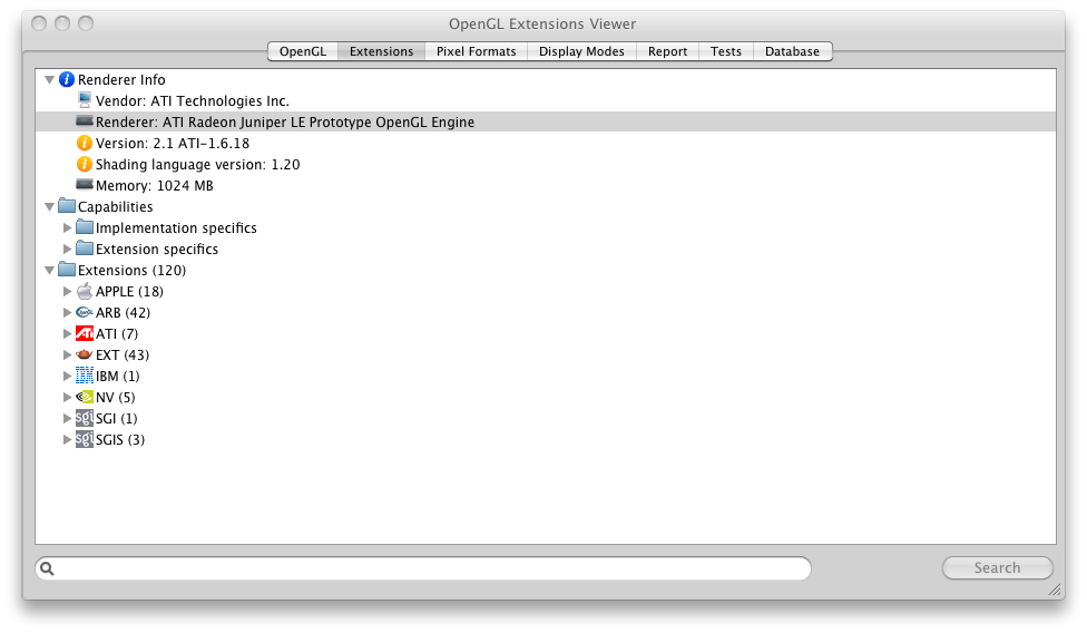

redvulps Posted August 5, 2010 Share Posted August 5, 2010 Well, tested alone HDMI output and HDMI + both DVI and also worked. Only OGL3 isn't working, OpenCL looks to be working too. i'll be posting some screens =) Link to comment https://www.insanelymac.com/forum/topic/203959-radeon-hd-5750/page/2/#findComment-1525381 Share on other sites More sharing options...
cachemir Posted August 5, 2010 Share Posted August 5, 2010 Well, tested alone HDMI output and HDMI + both DVI and also worked. Only OGL3 isn't working, OpenCL looks to be working too. i'll be posting some screens =) How did you get this? Could you help me please? Do you have a manual or something? Link to comment https://www.insanelymac.com/forum/topic/203959-radeon-hd-5750/page/2/#findComment-1525414 Share on other sites More sharing options...
redvulps Posted August 6, 2010 Share Posted August 6, 2010 How did you get this? Could you help me please? Do you have a manual or something? My post before have a link to a google docs manual. the only thing that you''l do different it's use the ATY_init.kext that i have attached in the post. if doesn't work, tell me, i did the installation with success more than twice XD Link to comment https://www.insanelymac.com/forum/topic/203959-radeon-hd-5750/page/2/#findComment-1525538 Share on other sites More sharing options...

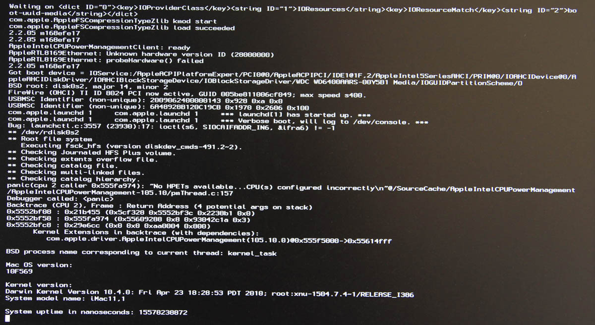

Nargilem Posted September 28, 2010 Share Posted September 28, 2010 When I Reboot My Computer Starts The Apple Shows And The Loading Ring Spins Like Its Booting Just Fine But Then The Screen Goes All To Scrambles And It Just Sits There. Exact same situation here, so far I've found 3 other owners of a 5750 card with the same problems. Tried kabyl's bootloader and Mohamed's. So far nothing works.. EDIT: Succes! I've managed to get it working like the post above mentions: inject device-id 0x68be1002 in the ATI5000 info.plist. Link to comment https://www.insanelymac.com/forum/topic/203959-radeon-hd-5750/page/2/#findComment-1556008 Share on other sites More sharing options...
