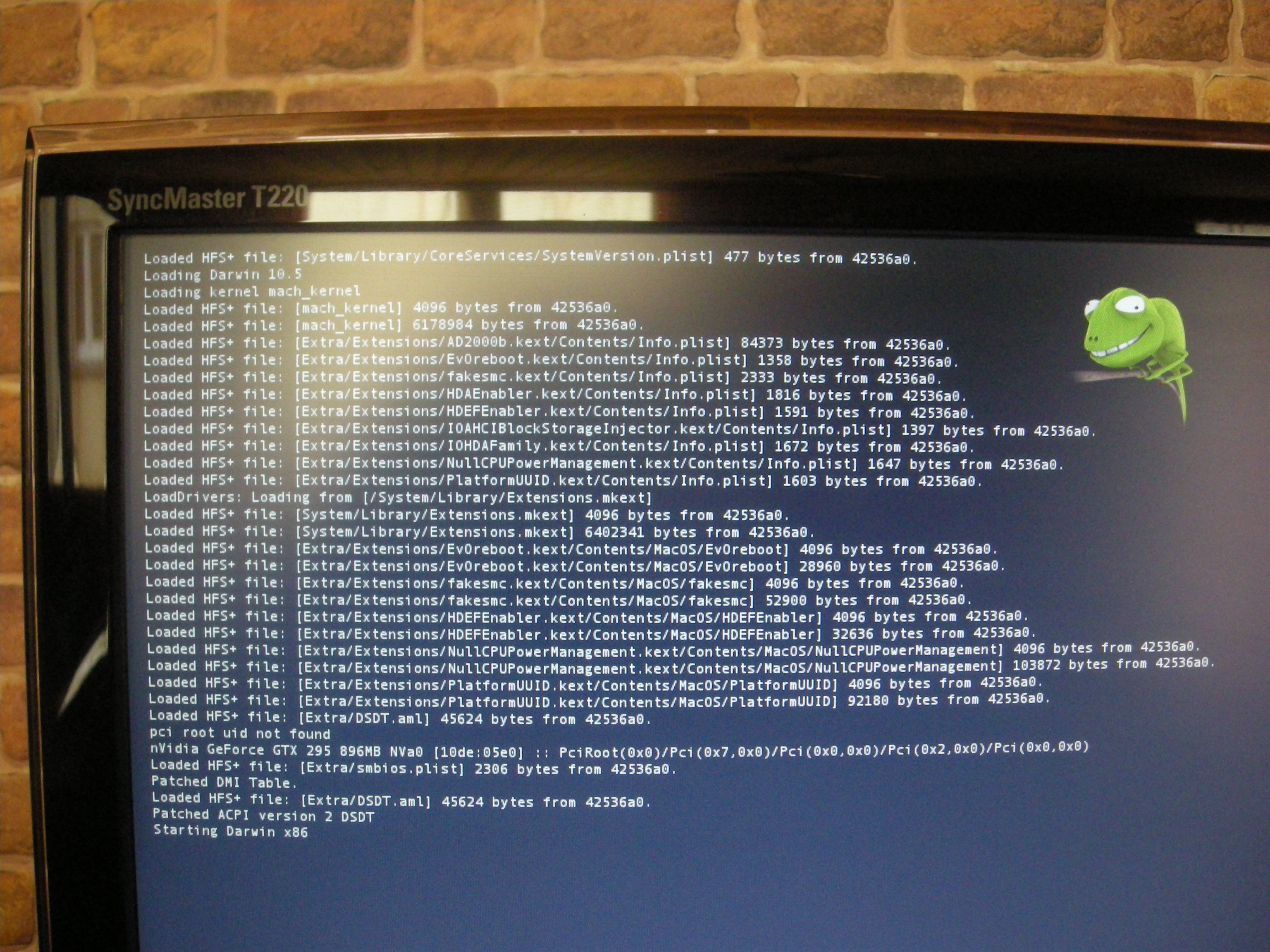

demonfox13x Posted May 26, 2010 Share Posted May 26, 2010 Just adding to this thread i just did an install P6t6 ws revolution I7 920 6gb ram Ati 4870 Used an external drive to put sl disc on Installed chameleon onto drive with sl disc restored Added neccessary kexts to extra folder - (removed all hda kexts bc i used voodoo 2.52 installer after i installed and updated to 10.6.3) Booted the install drive w/ acpi 2.0 and apic enabled, bios ehci handoff enabled. Storage mode is ahci. Everything else is default) Installed osx then installed chameleon on to the drive copying the extra folder from install drive Updated to 10.6.3 and everythings smooth so far *****only hiccup i had was trying to get my 4870 working (graphicsenabler=yes in boot plist) without hot plugging it.. I tried a different pci-e slot (3rd) and it booted right up without hot plugging. **I used chameleon osx installer from tonymacx86 website, i believe his rc5 build was the one i used w/ netkas 10.6 boot file I believe i still have orange icons but havent bothered to fix it yet. Btw guys plz search the forums before pming, im always ready to help bc we were all noobs once (still am) Link to comment https://www.insanelymac.com/forum/topic/202132-asus-p6t6-ws-revolution-how-i-did-it/page/2/#findComment-1475750 Share on other sites More sharing options...

LordofMuck Posted July 27, 2010 Share Posted July 27, 2010 Hi all. My first post here & first attempt at making a hackintosh... I have restored a working RETAIL snow leo to an 8gb usb stick, that i have afterwards installed the usb flash bootloader, that you have linked to Der Puma. Problem is: When i boot from this usb stick, my screen goes black and gives me the message: "Input Signal Out Of Range"! I dont know how to fix this. Any ideas? I am a total noob, but willing to try any advice. I REALLY would like to run os x 10.6 on my Ws Revo i7 rig. My sweet goal. Link to comment https://www.insanelymac.com/forum/topic/202132-asus-p6t6-ws-revolution-how-i-did-it/page/2/#findComment-1519860 Share on other sites More sharing options...

gameace99 Posted December 26, 2010 Share Posted December 26, 2010 Below is a reply to an mail sent to me, basically outlines how I did it: Ok, glad to help. Merry Christmas btw. Anyway, (from what I can remember) I did not use a patched DSDT or anything of the sort. What I did do was modify the com.apple.boot.plist to add arch=x86_32. (ill clarify if you need help on that. The kexts I used (installed on the usb and then thus onto the system) were (in Extensions): AD2000b EvOreboot fakesmc HDAEnabler HDEFEnabler IOAHCIBlockStorageInjector IOHDAFamily NullCPUPowerManagement PlatformUUID And on the USB in S/L/E I have: AppleHDA HDAEnabler IONetworkingFamily RealtekR1000SL To install chameleon I did it manually via terminal, all the other ways didn't work (on the actual machine). I believe I used some program for the USB... don't really remember. Last, the SOUND (capitals because it took forever to get working) is done via these four kexts, and you need to install them every time you update to 10.6.4, etc. Not a hassle. They are: AD2000b AppleHDA HDAEnabler HDEFEnabler Took forever, but it is completely stable and working, not one problem since then. Good luck Link to comment https://www.insanelymac.com/forum/topic/202132-asus-p6t6-ws-revolution-how-i-did-it/page/2/#findComment-1608962 Share on other sites More sharing options...
