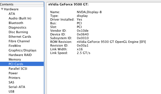

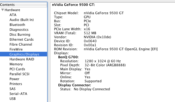

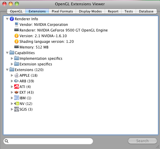

VampireMI2 Posted April 30, 2010 Share Posted April 30, 2010 I use 9500GT 512mb and fully working. I edit my DSDT with gfx0 and my NVCAP. This is my code Device (PEGP) { Name (_ADR, 0x00010000) Device (GFX0) { Name (_ADR, Zero) Name (_SUN, One) Method (_DSM, 4, NotSerialized) { Store (Package (0x16) { "@0,compatible", Buffer (0x0B) { "NVDA,NVMac" }, "@0,device_type", Buffer (0x08) { "display" }, "@0,name", Buffer (0x0F) { "NVDA,Display-A" }, "@1,compatible", Buffer (0x0B) { "NVDA,NVMac" }, "@1,device_type", Buffer (0x08) { "display" }, "@1,name", Buffer (0x0F) { "NVDA,Display-B" }, "NVCAP", Buffer (0x18) { /* 0000 */ 0x04, 0x00, 0x00, 0x00, 0x00, 0x00, 0x03, 0x00, /* 0008 */ 0x04, 0x00, 0x00, 0x00, 0x00, 0x00, 0x00, 0x07, /* 0010 */ 0x00, 0x00, 0x00, 0x00 }, "VRAM,totalsize", Buffer (0x04) { 0x00, 0x00, 0x00, 0x20 }, "device_type", Buffer (0x0D) { "NVDA,Parent" }, "model", Buffer (0x17) { "nVidia GeForce 9500 GT" }, "rom-revision", Buffer (0x2B) { "nVidia GeForce 9500 GT OpenGL Engine [EFI]" } }, Local0) DTGP (Arg0, Arg1, Arg2, Arg3, RefOf (Local0)) Return (Local0) } } } and my screen shot Link to comment https://www.insanelymac.com/forum/topic/201777-9500-gt-snow-leopard-106-drivers/page/2/#findComment-1458781 Share on other sites More sharing options...
