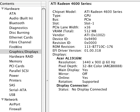

cliveren131 Posted November 24, 2009 Share Posted November 24, 2009 Ok so my HIS radeon hd4760 1 gig video card just showed up from newegg its part of thier pre-black friday deal of 64.99 a really big card, anyway plugged it in to my jetway mobo i31gm4 a real good solid board im using SL 10.6.2 it booted connected via a dvi to hdmi cable no pic at first so i ran a hdmi to hdmi cable instead and everything booted up fine i was amazed here is a screen shot radeon.tiff Link to comment Share on other sites More sharing options...

motrix Posted November 26, 2009 Share Posted November 26, 2009 Hi to all ! My experience with a Sapphire Radeon HD 4670 512 Mb GDDR3 equipped with D-Sub (vga), HDMI and DVI connectors: - SL 10.6.2 + chameleon 2 rc3 + boot beta + vanilla kexts = kp on x2000.kext - SL 10.6.2 + chameleon 2 rc3 + boot 10.5 + vanilla kexts = all ok but video out only on D-Sub (VGA) connector - SL 10.6.2 +chameleon 2 rc3 + boot beta + 4600.kext (irc.osx86) in extra/extensions = all ok but video out only on HDMI connector. Cheers Link to comment Share on other sites More sharing options...
set77 Posted November 27, 2009 Share Posted November 27, 2009 motrix thank you for sharing !!!!!!! My Saphire ATI 4670 dual-DVI now works with DVI2VGA dongle at native resolution and all QE/CI goodies. My problem was not using PC EFI 10.5 and only switching between 10.3 and 10.5 Beta. Downloaded correct boot file from netkas http://netkas.org/?cat=5 and my system is setup as follows 1. GraphicsEnabler must be set to y in com.apple.Boot.plist 2. Replaced Chameleon2 boot file with PC EFI 10.5 from netkas 3. all vanilla ATI kexts 4. SL 10.6.2 kernel 10.2.0 Link to comment Share on other sites More sharing options...

BatcOuntrY Posted November 28, 2009 Share Posted November 28, 2009 Can someone else report working 4670 card (besides and including) HIS and Saphire brand? I finally got my HIS 4670 working using netkas' betabooter and kext files DVI2DVI. Thank you netkas. EDIT: I went back and removed the the kext files and instead used the Vanilla kexts and it works so all I am using at this point is the netkas betabooter. Also I have to have my monitor plugged into the second DVI port it wouldn't work if I booted up with it plugged into the first one. So if you are getting the black screen try using the other dvi port it just might work. Also I had to boot up using the second dvi port, if I booted using the first port and then tried to move the connection to the second port I still had a black screen. Chipset Model: ATI Radeon 4670 Series Type: GPU Bus: PCIe Slot: Slot-1 PCIe Lane Width: x16 VRAM (Total): 512 MB Vendor: ATI (0x1002) Device ID: 0x9490 Revision ID: 0x0000 ROM Revision: 113-B7710C-176 EFI Driver Version: 01.00.318 Displays: SyncMaster: Resolution: 1440 x 900 @ 60 Hz Pixel Depth: 32-Bit Color (ARGB8888) Main Display: Yes Mirror: Off Online: Yes Rotation: Supported Display Connector: Status: No Display Connected Link to comment Share on other sites More sharing options...
jehrot Posted November 29, 2009 Share Posted November 29, 2009 My Sapphire 4670 is working too. Vanilla kexts, pc efi 10.5 boot loader. Only works (so far) through DVI with something plugged into HDMI. I'm getting mouse jumps and stutters which I wasn't before though. Very annoying. Any ideas anyone? Link to comment Share on other sites More sharing options...

sandsax Posted December 1, 2009 Share Posted December 1, 2009 ITs Working!!!!!!! with boot netkas 10.5 published in the post below. ATIRadeonX2000.kext and typing "GraphicsEnabler"="yes" on the boot prompt Function in 64 bits and 32 bits. I need to use a dongle DVI2VGA but ok !!! PowerColor ATI HD 4670 521 Mb DDR, dual dvi but just test a div one with dongle DIV2VGA With QE/QI working fully and beauty!!!!!! Thanks I love .. love .... love yours ......... Link to comment Share on other sites More sharing options...
