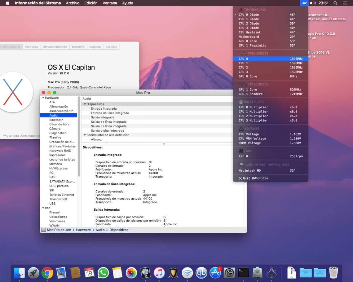

kosakgroove Posted March 19, 2017 Share Posted March 19, 2017 I must say after searching far and wide this was the best solution for me! thanks so much for your work! Also to MasterChief. I built a custom Hackintosh for merely 200€ with a Gigabyte EP45 UD3LR and running Mac OS X El Capitan on a Quad Core Q6600. I will be making a post describing such success. The case is a recycled one form a 1995 Pentium heavily modified by me. Thanks to this DSDT Shutdown and Sleep work perfect now, which had been the last remaining issue in this build! Got myself a perfect "Mac Pro" now! Thanks ever so much Link to comment https://www.insanelymac.com/forum/topic/199194-dsdt-gigabytes-motherboards-macpro-style/page/3/#findComment-2387520 Share on other sites More sharing options...
