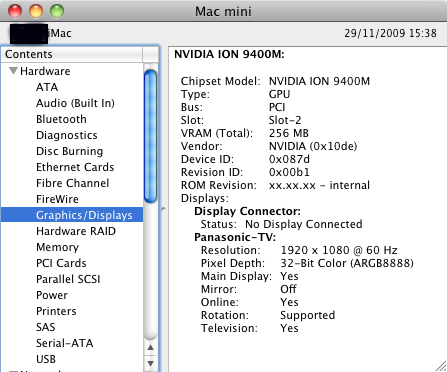

splonk Posted November 29, 2009 Share Posted November 29, 2009 Well, this is what SysProf is reporting QE is working OK. As for the resolution thing - yes it seems to only like full 1080p if attached to my Panasonic. However, I did try changing it and then pulling out the hdmi cable and reattaching after the screen turned blue. I got it to stick on 720p eventually which was easier to work with from a distance. It seems to be a hdmi issue (not tried vga) as when you pull the cable out/in you can briefly see the actual screen underneath the blue. I think I have made some headway on my usb woes. Changing the symbios.plist to Mac Mini instead of iMac and turning off legacy usb in the com.apple.Boot.plist (don't try that in the bios, whatever you do!) has improved matters somewhat. Link to comment https://www.insanelymac.com/forum/topic/195438-acer-aspire-revo-hackintosh/page/2/#findComment-1345743 Share on other sites More sharing options...
splonk Posted November 30, 2009 Share Posted November 30, 2009 I have replaced the Atheros card with a Broadcom 4321, now I have native Airport at 802.11n speed. Even better is the fact that I can now switch screen resolution without bluescreening. These are the magic words in my boot.plist, shamelessly filched from another thread in here: <key>Kernel</key> <string>mach_kernel</string> <key>Kernel Flags</key> <string>debug=0x100</string> <key>Timeout</key> <string>2</string> <key>Legacy Logo</key> <string>Yes</string> <key>arch</key> <string>x86</string> <key>GraphicsEnabler</key> <string>yes</string> <key>EthernetBuiltIn</key> <string>yes</string> <key>USBLegacyOff</key> <string>yes</string> <key>VBIOS</key> <string>yes</string> </dict> Doubt if the VBIOS key is the solution, since I have not extracted the graphics card ROM, so I suspect that maybe the usb was buggering up things, but I am not sure why. Won't have time to play with the dsdt until the weekend, but I have spotted something that might work on the Revo to get rid of the stuttering on audio. Link to comment https://www.insanelymac.com/forum/topic/195438-acer-aspire-revo-hackintosh/page/2/#findComment-1347021 Share on other sites More sharing options...
