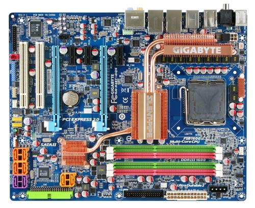

holyfield Posted October 12, 2009 Share Posted October 12, 2009 Success: Gigabyte X48T-DQ6 & Intel Q9550 + Snow Leopard I have great success on installing Mac OS X Snow Leopard on Gigabyte GA-X48T-DQ6 & Intel Q9550 based computer. Everything is working really fine. This hardware can be used with EFI-X dongle or without it, just by using some patching techniques. Read detailed review of GA-X48T-DQ6. System specification System consist from: * Gigabyte GA-X48T-DQ6 * Intel Core 2 Quad Q9550 Yorkfield 2.83GHz, 12MB L2 Cache, LGA 775 * 2x 2GB DDR3 1333 MHz * Asus NVIDIA GeForce 9800GTX+ 512MB (Dark Knight edition), Accelero S1 Rev. 2 * Samsung 1TB HD103UJ (Good silent HD) * Zalman CNPS9900A (Not so silent as expected) Installation with EFI-X dongle If you have EFI-X dongle, then you can install your Mac OS X 10.5 just from original DVD. I believe that EFI-X dongle is overpriced, as it has only $10 hardware inside. Normal price should be between $59-$99, depending at support plan. How to install Snow Leopard (without EFI-X dongle) This is short list how to install Snow Leopard on X48T-DQ6 & Intel Q9550 based computer. I will update within few weeks this post by adding detailed instructions for each step. 1. Buy original Snow Leopard DVD (I recommend to buy Mac Box Set, which is great software bundle and costs less than Windows OS) 2. Create bootable USB installation media from original DVD 3. Install Snow Leopard from USB installation media 4. Make new installation bootable 5. Create your DSDT patch 6. Apply modifications and 7. Boot your new system Network issues (RTL8111C) X48T-DQ6 motherboard has RTL8111C network chip. This chip does not work properly with Apple drives. Download Realtek R1000 driver for Snow Leopard and install with Kext Helper. Also you can try to install Realtek original drivers for RTL8111C network chip. Audio issues (ALC889A) X48T-DQ6 motherboard has 8 channel ALC889A audio controller. List of audio channels: * Line Out Green * Line Out Orange * Line Out Black * Line Out Grey * Line Out Digital * Line Out on Front Panel (Headphones) * Line In Blue * Line In Digital * Mic In Red * Mic In on Front Panel I haven't found yet a fully working solution for this controller. There are different solution's which are providing access to some channels. Any solution does not provide all channels available by board yet. Try different options, which best suits your needs. Some useful links: * Various ALC889A Gigabyte solutions - different options * 5.1 surround solution DSDT - gives 6 ch on back panel (can be used for 5.1) * DSDT solution from Evosx86 forum Recommended Tools * Kext Helper NOTE (Nov 12, 2009) Just updated to 10.6.2 with success. Board Specification 00:00.0 Host bridge [0600]: Intel Corporation 82X38/X48 Express DRAM Controller [8086:29e0] (rev 01) 00:01.0 PCI bridge [0604]: Intel Corporation 82X38/X48 Express Host-Primary PCI Express Bridge [8086:29e1] (rev 01) 00:06.0 PCI bridge [0604]: Intel Corporation 82X38/X48 Express Host-Secondary PCI Express Bridge [8086:29e9] (rev 01) 00:1a.0 USB Controller [0c03]: Intel Corporation 82801I (ICH9 Family) USB UHCI Controller #4 [8086:2937] (rev 02) 00:1a.1 USB Controller [0c03]: Intel Corporation 82801I (ICH9 Family) USB UHCI Controller #5 [8086:2938] (rev 02) 00:1a.2 USB Controller [0c03]: Intel Corporation 82801I (ICH9 Family) USB UHCI Controller #6 [8086:2939] (rev 02) 00:1a.7 USB Controller [0c03]: Intel Corporation 82801I (ICH9 Family) USB2 EHCI Controller #2 [8086:293c] (rev 02) 00:1b.0 Audio device [0403]: Intel Corporation 82801I (ICH9 Family) HD Audio Controller [8086:293e] (rev 02) 00:1c.0 PCI bridge [0604]: Intel Corporation 82801I (ICH9 Family) PCI Express Port 1 [8086:2940] (rev 02) 00:1c.3 PCI bridge [0604]: Intel Corporation 82801I (ICH9 Family) PCI Express Port 4 [8086:2946] (rev 02) 00:1c.4 PCI bridge [0604]: Intel Corporation 82801I (ICH9 Family) PCI Express Port 5 [8086:2948] (rev 02) 00:1c.5 PCI bridge [0604]: Intel Corporation 82801I (ICH9 Family) PCI Express Port 6 [8086:294a] (rev 02) 00:1d.0 USB Controller [0c03]: Intel Corporation 82801I (ICH9 Family) USB UHCI Controller #1 [8086:2934] (rev 02) 00:1d.1 USB Controller [0c03]: Intel Corporation 82801I (ICH9 Family) USB UHCI Controller #2 [8086:2935] (rev 02) 00:1d.2 USB Controller [0c03]: Intel Corporation 82801I (ICH9 Family) USB UHCI Controller #3 [8086:2936] (rev 02) 00:1d.7 USB Controller [0c03]: Intel Corporation 82801I (ICH9 Family) USB2 EHCI Controller #1 [8086:293a] (rev 02) 00:1e.0 PCI bridge [0604]: Intel Corporation 82801 PCI Bridge [8086:244e] (rev 92) 00:1f.0 ISA bridge [0601]: Intel Corporation 82801IR (ICH9R) LPC Interface Controller [8086:2916] (rev 02) 00:1f.2 SATA controller [0106]: Intel Corporation 82801IR/IO/IH (ICH9R/DO/DH) 6 port SATA AHCI Controller [8086:2922] (rev 02) 00:1f.3 SMBus [0c05]: Intel Corporation 82801I (ICH9 Family) SMBus Controller [8086:2930] (rev 02) 01:00.0 VGA compatible controller [0300]: nVidia Corporation G92 [GeForce 9800 GTX] [10de:0612] (rev a2) 04:00.0 SATA controller [0106]: JMicron Technology Corp. 20360/20363 Serial ATA Controller [197b:2363] (rev 02) 04:00.1 IDE interface [0101]: JMicron Technology Corp. 20360/20363 Serial ATA Controller [197b:2363] (rev 02) 05:00.0 Ethernet controller [0200]: Realtek Semiconductor Co., Ltd. RTL8111/8168B PCI Express Gigabit Ethernet controller [10ec:8168] (rev 02) 06:00.0 Ethernet controller [0200]: Realtek Semiconductor Co., Ltd. RTL8111/8168B PCI Express Gigabit Ethernet controller [10ec:8168] (rev 02) 07:06.0 FireWire (IEEE 1394) [0c00]: Texas Instruments TSB43AB23 IEEE-1394a-2000 Controller (PHY/Link) [104c:8024] Link to comment https://www.insanelymac.com/forum/topic/191683-success-gigabyte-x48t-dq6-intel-q9550-snow-leopard-106-1061/ Share on other sites More sharing options...
