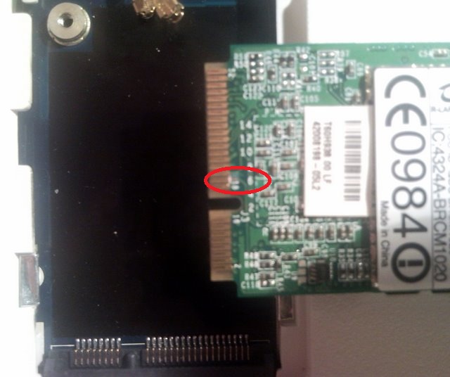

SomniusX Posted March 13, 2010 Share Posted March 13, 2010 I've tried to "tap" pin 20 with sellotape (photos here http://www.flickr.com/photos/8594621@N02/s...57623611399692/ ) but with no luck.. i didn't remove the inside atheros wifi card, must i ? help guys, when you say "tap" or sometimes "tape" you mean realy tape the pin, or something else ? Thanx! Link to comment https://www.insanelymac.com/forum/topic/191547-install-snow-leopard-106-on-acer-aspire-one-d250/page/2/#findComment-1428252 Share on other sites More sharing options...

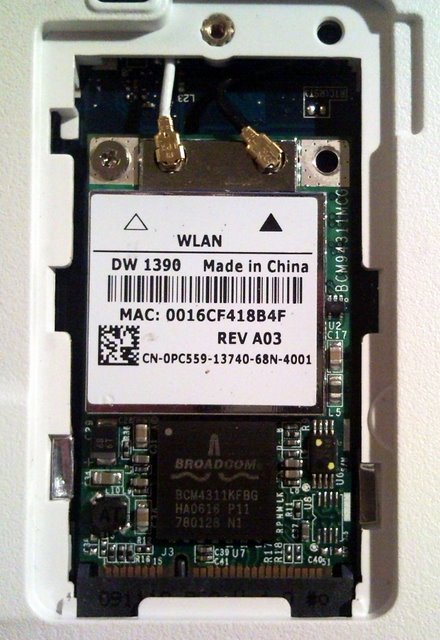

iVodka Posted March 23, 2010 Share Posted March 23, 2010 Working BCM43xx (including Dell 1390) : - Install kexts from "Archiwum" with kextloader - Repair permissions - Using kismac add Airport driver in active mode - Scan for networks (you have to do it only once) - Connect to your network using Airport - Enjoy! Download ... Link to comment https://www.insanelymac.com/forum/topic/191547-install-snow-leopard-106-on-acer-aspire-one-d250/page/2/#findComment-1433213 Share on other sites More sharing options...

dgeordgy21 Posted March 29, 2010 Share Posted March 29, 2010 Working BCM43xx (including Dell 1390) : - Install kexts from "Archiwum" with kextloader - Repair permissions - Using kismac add Airport driver in active mode - Scan for networks (you have to do it only once) - Connect to your network using Airport - Enjoy! Download ... I dont understand, this Kext work for the half-size pci-e card? or a standard pci-e card in the second slot? Thank in advance. I've tried to "tap" pin 20 with sellotape(photos here http://www.flickr.com/photos/8594621@N02/s...57623611399692/ ) but with no luck.. i didn't remove the inside atheros wifi card, must i ? help guys, when you say "tap" or sometimes "tape" you mean realy tape the pin, or something else ? Thanx! Hello! I have made this hack, and work fine! But it's a little more tricky. I have remove the half-seize card inside. See Post #6 I have notice that the "tape" method is not safe of problem... My method is simple and radical. I cut the pin 20. at your own risk!! I hope its help Link to comment https://www.insanelymac.com/forum/topic/191547-install-snow-leopard-106-on-acer-aspire-one-d250/page/2/#findComment-1436857 Share on other sites More sharing options...
SomniusX Posted March 30, 2010 Share Posted March 30, 2010 ...Hello! I have made this hack, and work fine! But it's a little more tricky. I have remove the half-seize card inside. See Post #6 I have notice that the "tape" method is not safe of problem... My method is simple and radical. I cut the pin 20. at your own risk!! I hope its help Is there any chance on making it work? Can you help with pictures or something..? Link to comment https://www.insanelymac.com/forum/topic/191547-install-snow-leopard-106-on-acer-aspire-one-d250/page/2/#findComment-1437339 Share on other sites More sharing options...

dgeordgy21 Posted April 19, 2010 Share Posted April 19, 2010 Is there any chance on making it work? Can you help with pictures or something..? I try to the picture, but fails " Upload failed. Please ask the administrator to check the settings and permissions" F***! I don't want to open my computer again. But I'll post pict soon I re-open it! Hope it help! Link to comment https://www.insanelymac.com/forum/topic/191547-install-snow-leopard-106-on-acer-aspire-one-d250/page/2/#findComment-1451396 Share on other sites More sharing options...
SomniusX Posted April 19, 2010 Share Posted April 19, 2010 ok.. i see it.. but the thing is i've located the same pin but only tried the tape version of the sollution and didn't seam to work.. so how can i permenently remove it without damaging the card? anyone? Link to comment https://www.insanelymac.com/forum/topic/191547-install-snow-leopard-106-on-acer-aspire-one-d250/page/2/#findComment-1451400 Share on other sites More sharing options...
dgeordgy21 Posted April 19, 2010 Share Posted April 19, 2010 ok.. i see it.. but the thing is i've located the same pin but only tried the tape version of the sollution and didn't seam to work.. so how can i permenently remove it without damaging the card? anyone? I think, you have to remove the other wifi card, the half-size! replace you tape with a strong one... Link to comment https://www.insanelymac.com/forum/topic/191547-install-snow-leopard-106-on-acer-aspire-one-d250/page/2/#findComment-1451881 Share on other sites More sharing options...

applejedi Posted April 25, 2010 Share Posted April 25, 2010 Working BCM43xx (including Dell 1390) : - Install kexts from "Archiwum" with kextloader - Repair permissions - Using kismac add Airport driver in active mode - Scan for networks (you have to do it only once) - Connect to your network using Airport - Enjoy! Download ... My D250 has a Broadcom BMC4312HMG card. I followed the steps above. I open Kismac and go to "File" and choose "New". Then I go to "Channel" and in the drop down it says "No Driver Loaded". I installed the Archiwum kexts (both of them in the zip file" using kextloader and I repaired permissions. Any ideas? As a back up, I bought a mini USB 802.11 b/g/n dongle that works great. It was only $10 with free shipping. If I can't get the internal card to work, this will do nicely. Link to comment https://www.insanelymac.com/forum/topic/191547-install-snow-leopard-106-on-acer-aspire-one-d250/page/2/#findComment-1455497 Share on other sites More sharing options...
