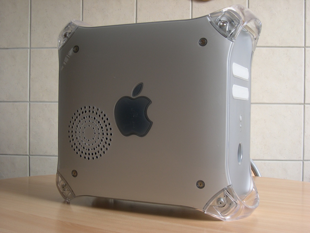

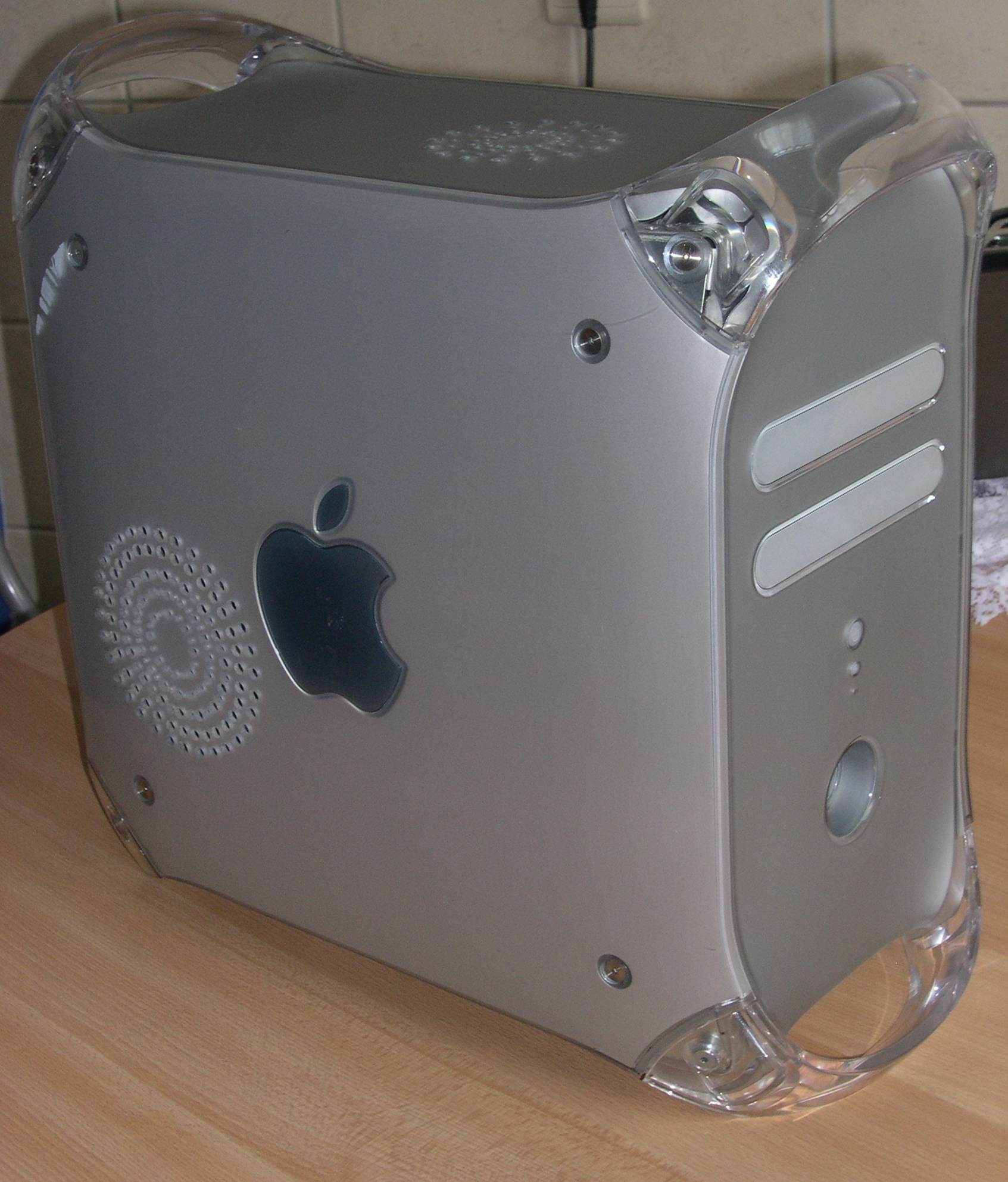

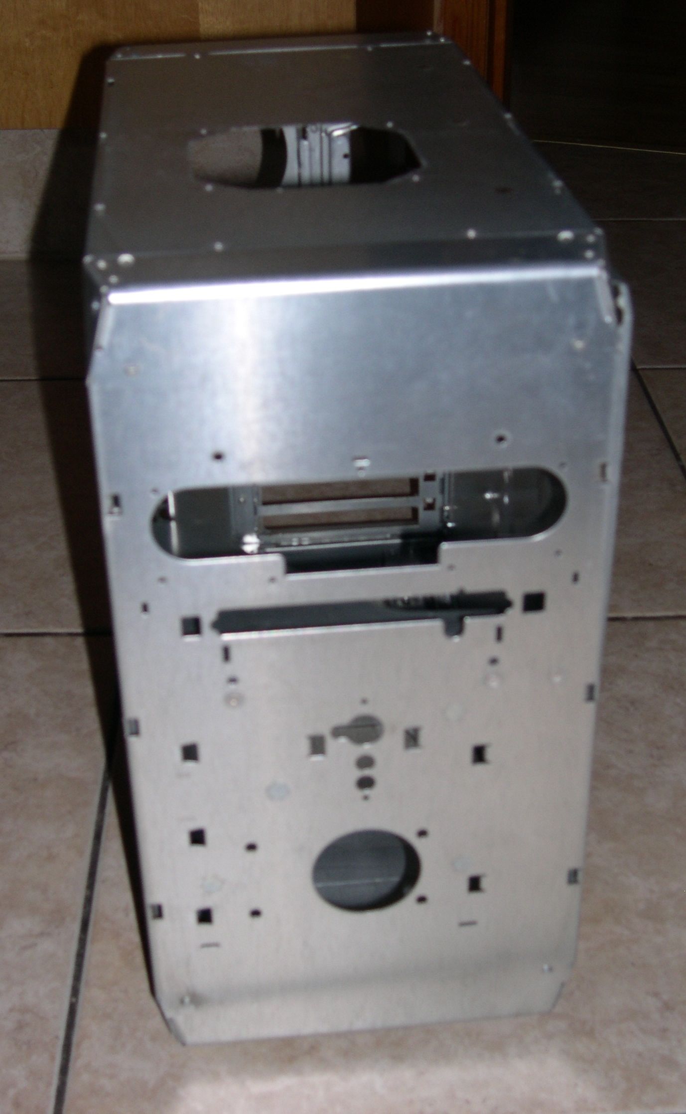

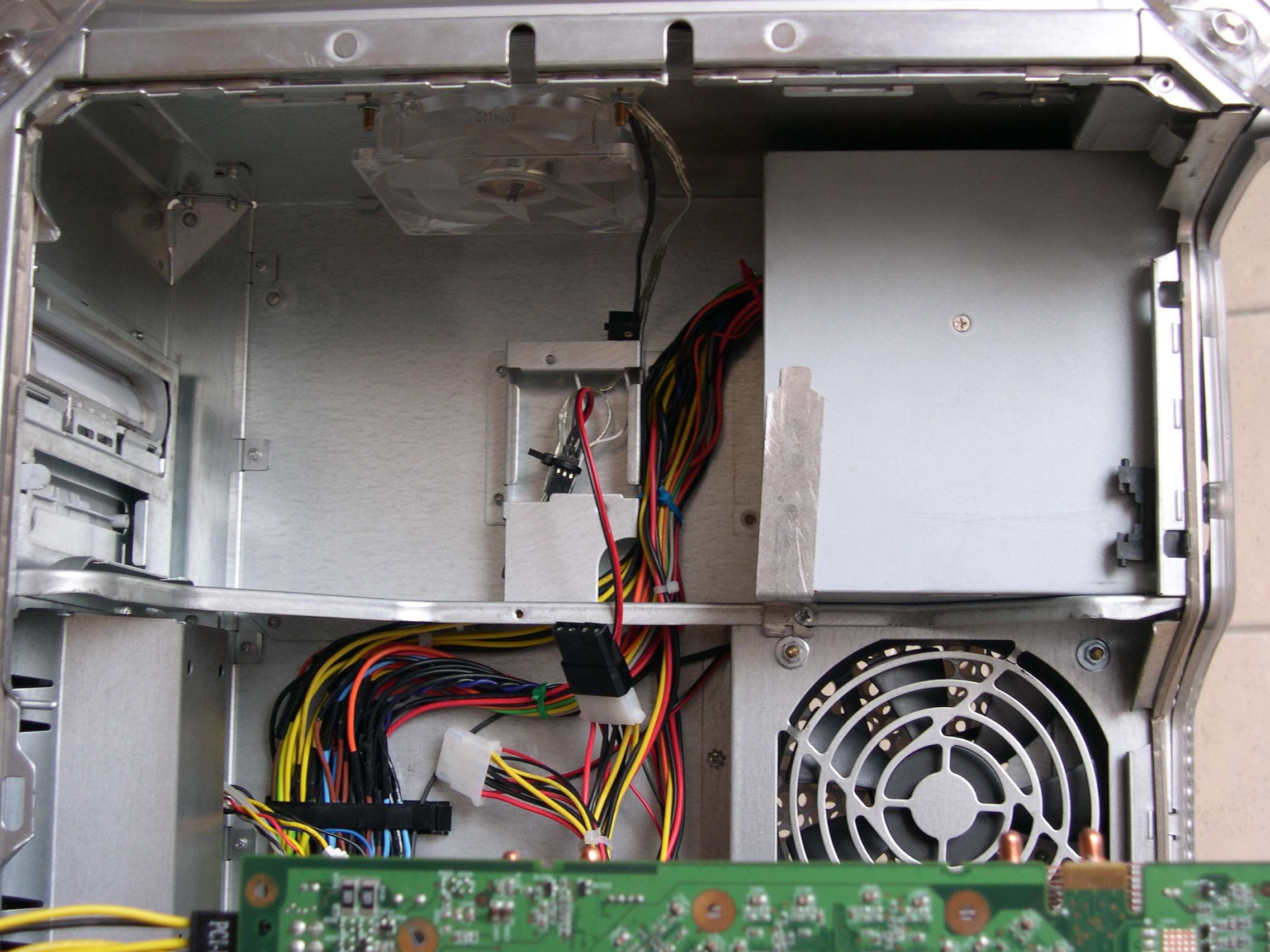

mobyte Posted October 5, 2009 Share Posted October 5, 2009 Hello, some pictures of my G4 mod... a lot of work Link to comment https://www.insanelymac.com/forum/topic/190707-another-hackintosh-g4-case/ Share on other sites More sharing options...

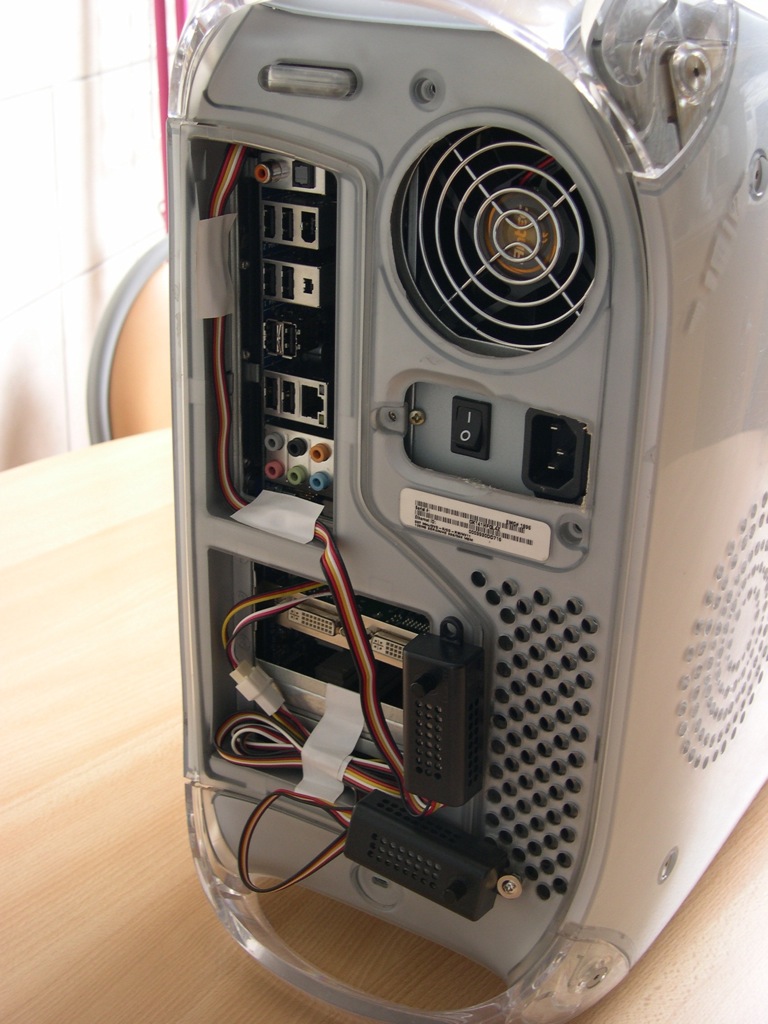

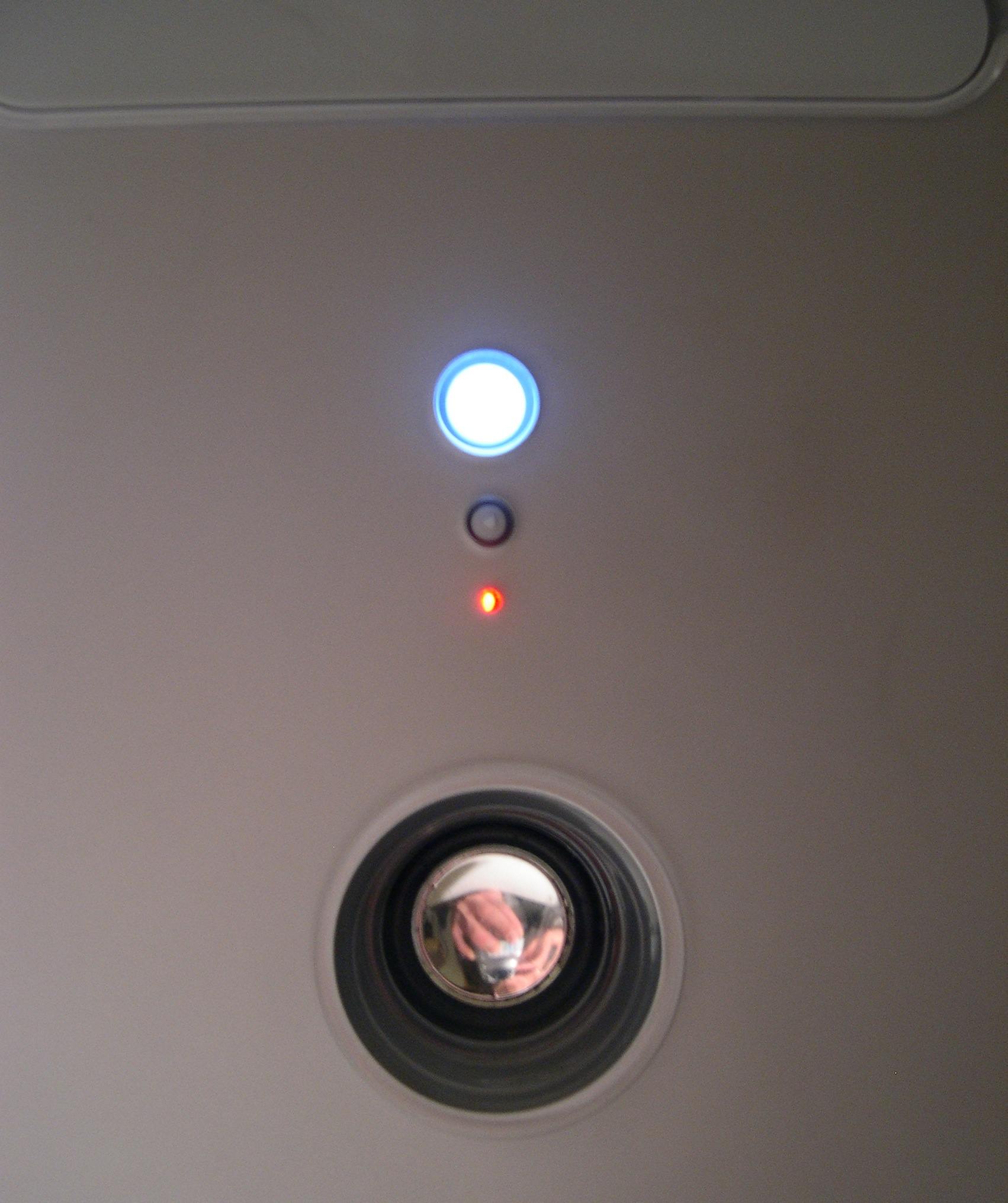

apple apple Posted October 5, 2009 Share Posted October 5, 2009 Nice job. I often miss my quicksilver. Looks great. Are the power and reset buttons on the back? Link to comment https://www.insanelymac.com/forum/topic/190707-another-hackintosh-g4-case/#findComment-1290750 Share on other sites More sharing options...
iawval Posted October 5, 2009 Share Posted October 5, 2009 Hello, some pictures of my G4 mod... a lot of work Glorious! very nice indeed, I'have got a couple of these around, including the beautiful B/W I'have been thinking to start this job for years and I did nothing yet. Very nice thing! bravo Link to comment https://www.insanelymac.com/forum/topic/190707-another-hackintosh-g4-case/#findComment-1290812 Share on other sites More sharing options...

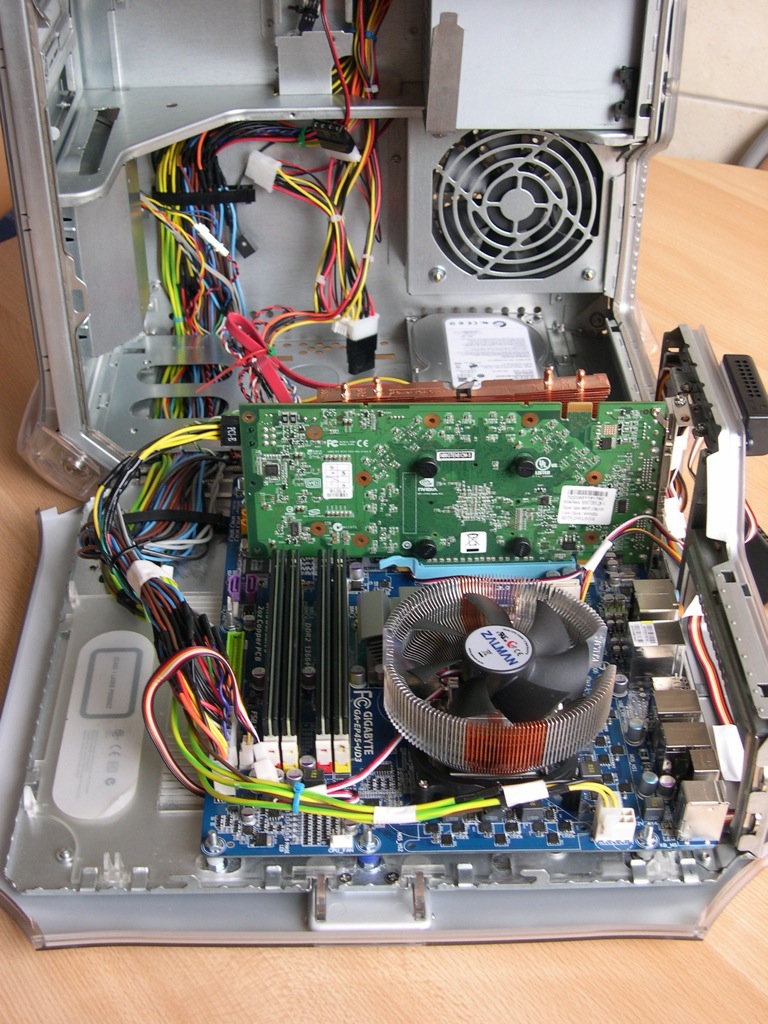

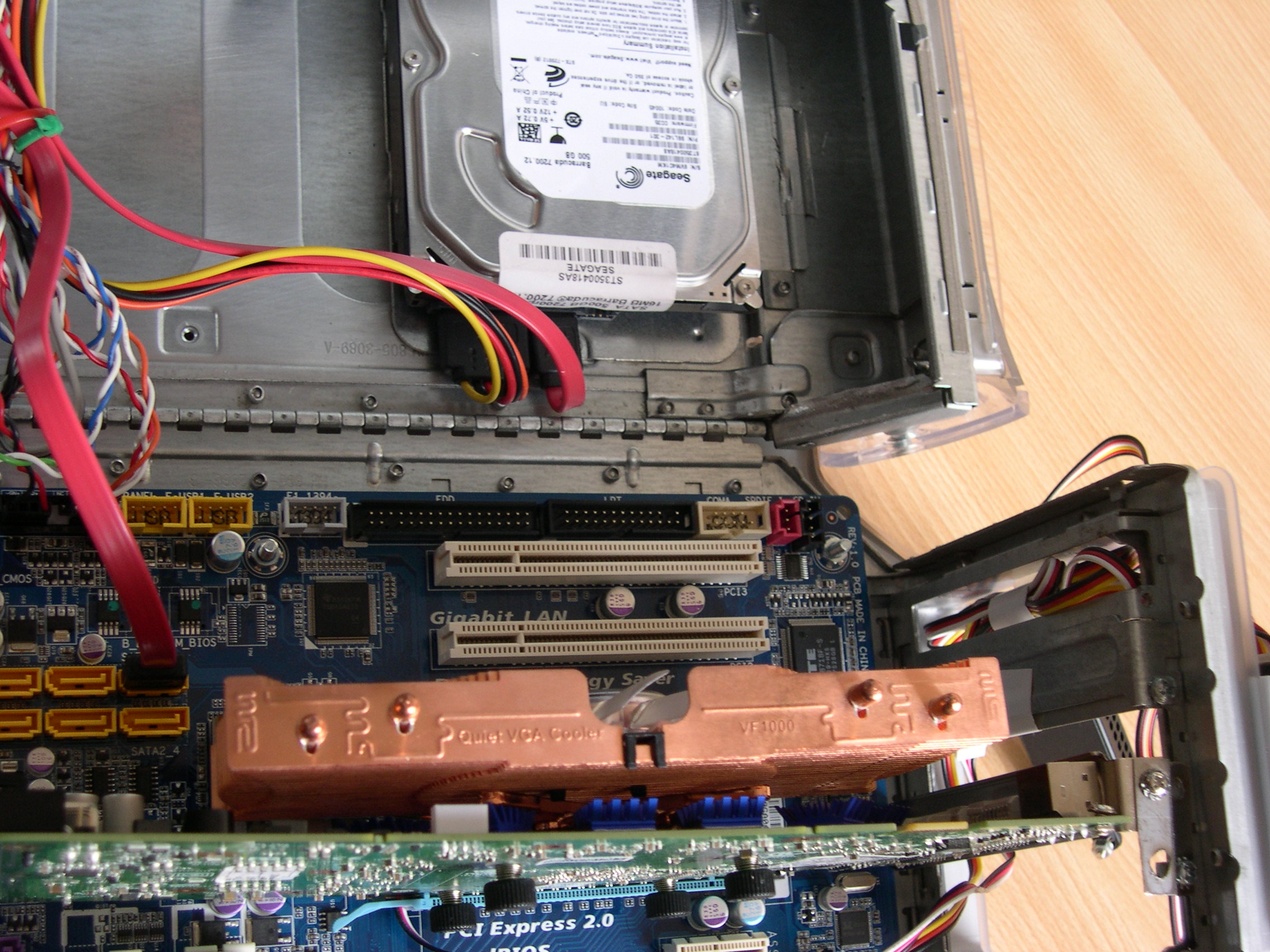

Roykjepolse Posted October 6, 2009 Share Posted October 6, 2009 Hello nice build. I´ve done the same thing. But i used a microATX board, Gigabyte EG41MF-USH2, i did not thought that it would be possible to use a full ATX board. Could you take some picture to show how it "fit" in the other end. Because i choose to use a DVD reader/writer i had to use a external DVD station that i placed in the original place. If you are interested i could upload some pictures of how i did it. Link to comment https://www.insanelymac.com/forum/topic/190707-another-hackintosh-g4-case/#findComment-1291065 Share on other sites More sharing options...

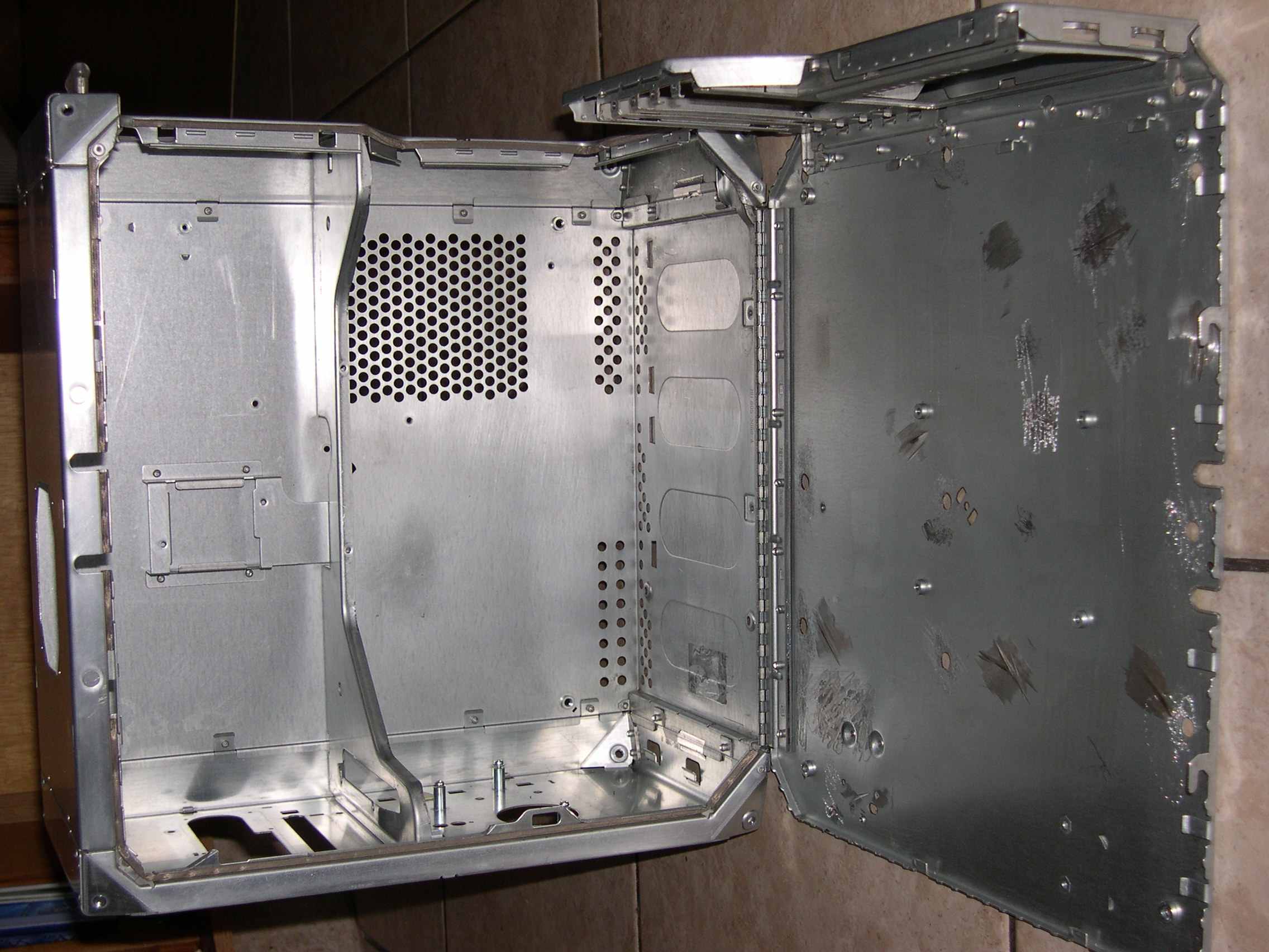

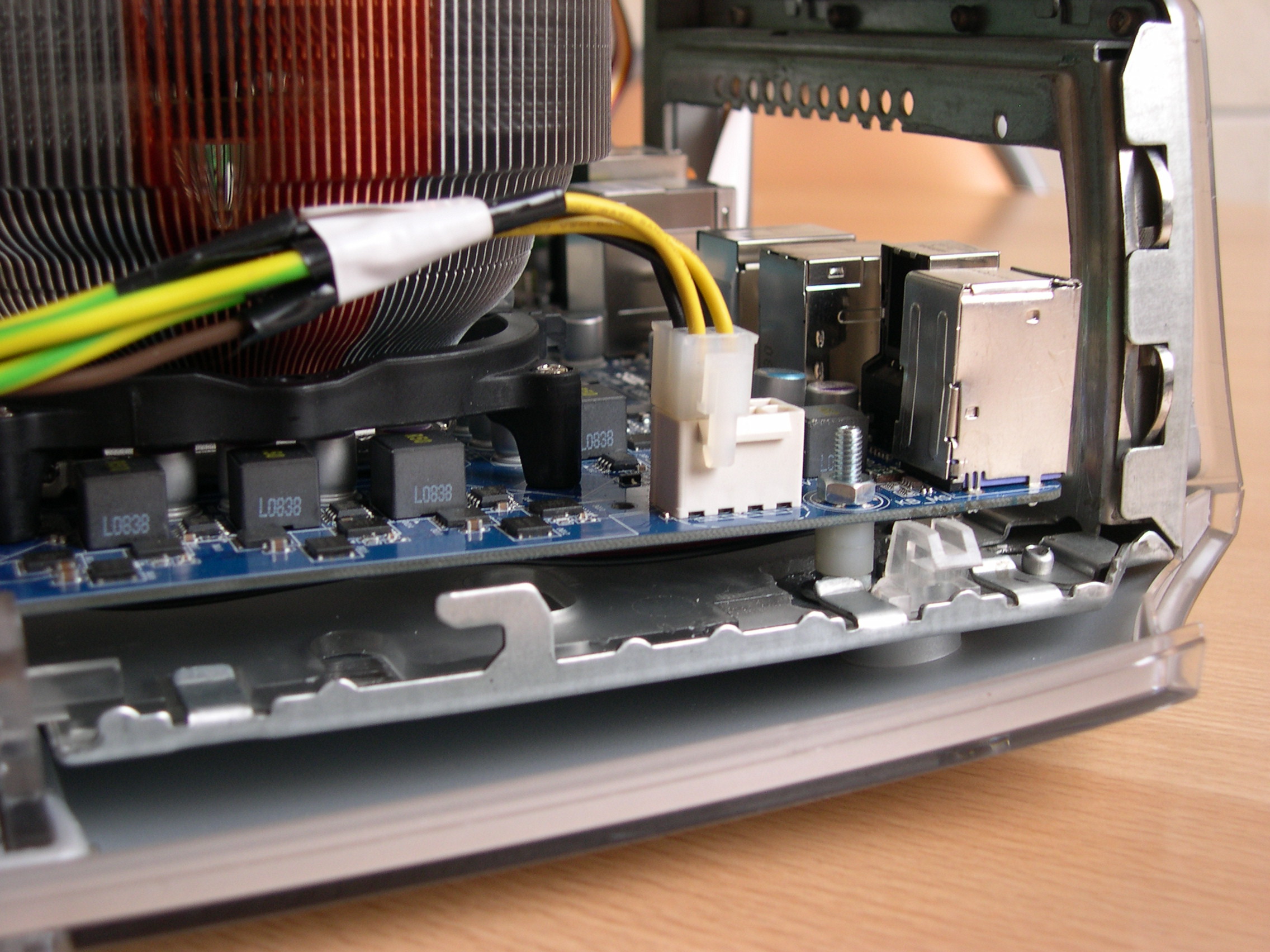

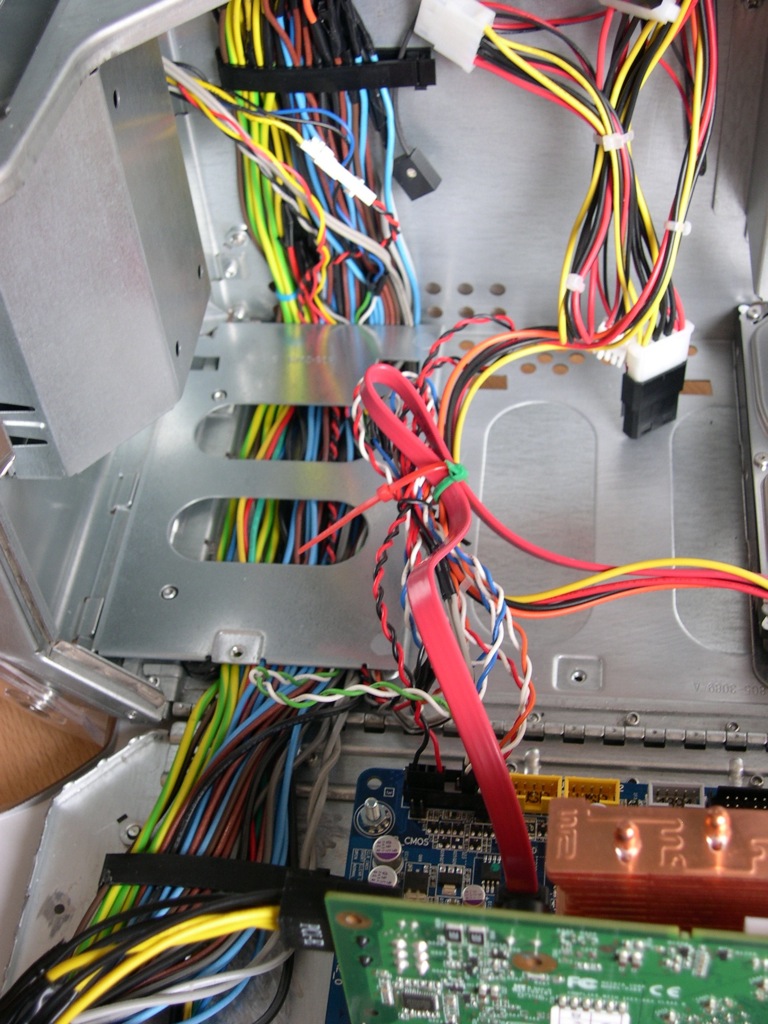

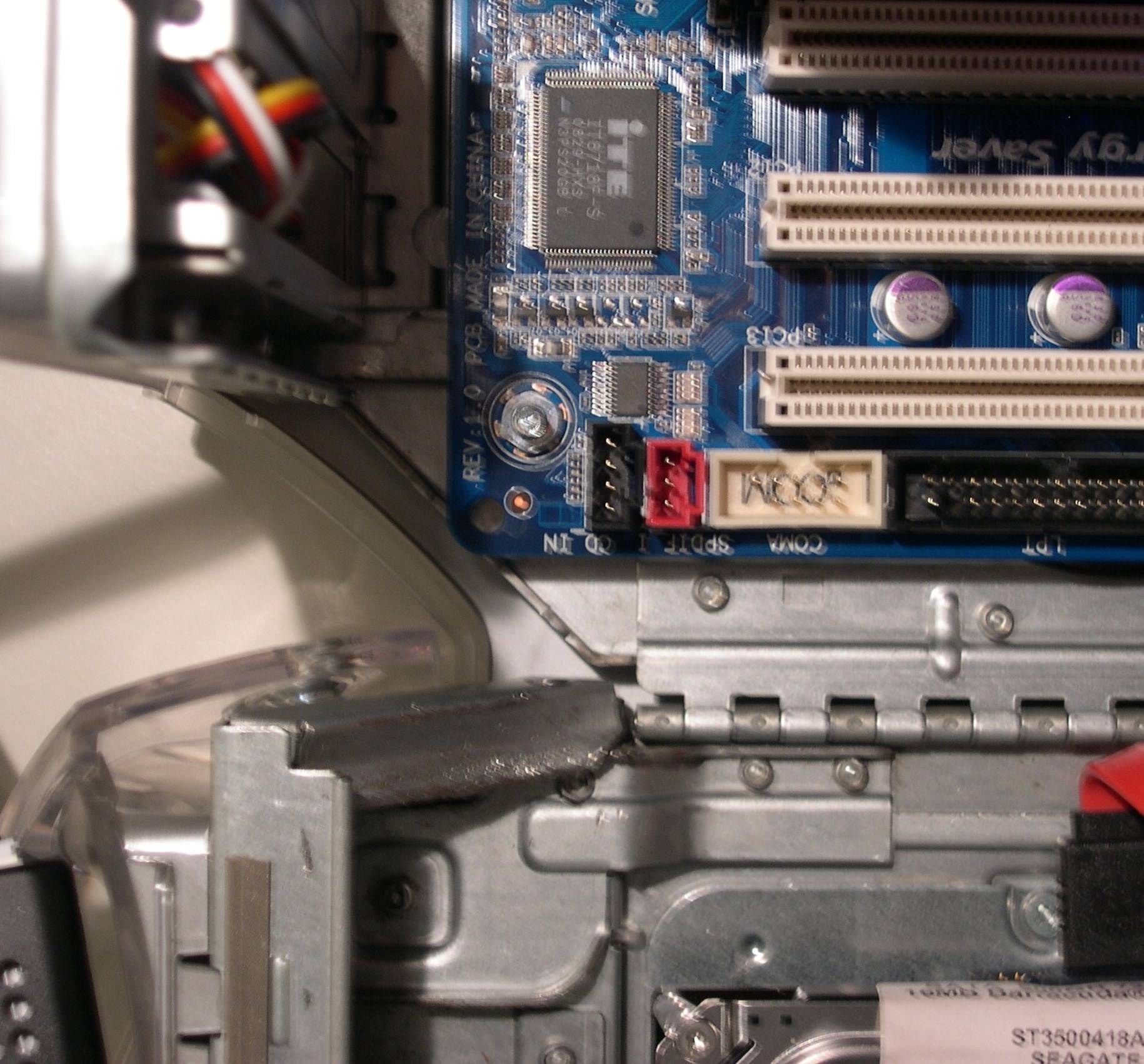

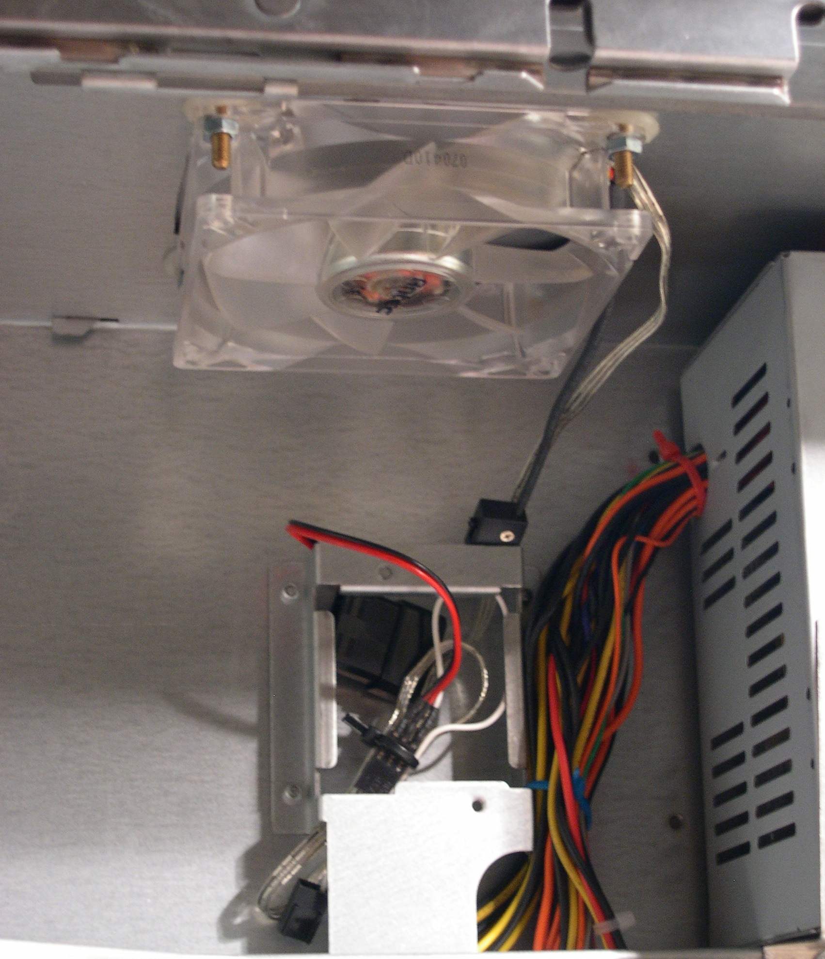

mobyte Posted October 6, 2009 Author Share Posted October 6, 2009 Hi, thank you for your compliments more pictures - - - - all piece of metal are cutted, no one fit to the MB (photo 01) the piece of plastic that retain the door need to be reduce to pass under the MB (photo 05) for the door to be closed without the PS/2 connexion toutch the up case, the MB must be pushed to the limit (photo 07) the power and reset buttons are used by soldering cable into the switchs (isolate the switchs by cutting all connexions) HD led added by drill the down plastic bouton For me the hard work is the +- 80 solderings... as you see the 24 pins - 6 pins - 4 pins are to short Rest the problem of DVD player... ther is no room for a standard one, solution is external or a slim one for laptop. in my case, all my stuff is on external hd... Roykjepolse, yes please post yours Thank you and long life InsanelyMac Link to comment https://www.insanelymac.com/forum/topic/190707-another-hackintosh-g4-case/#findComment-1291473 Share on other sites More sharing options...
