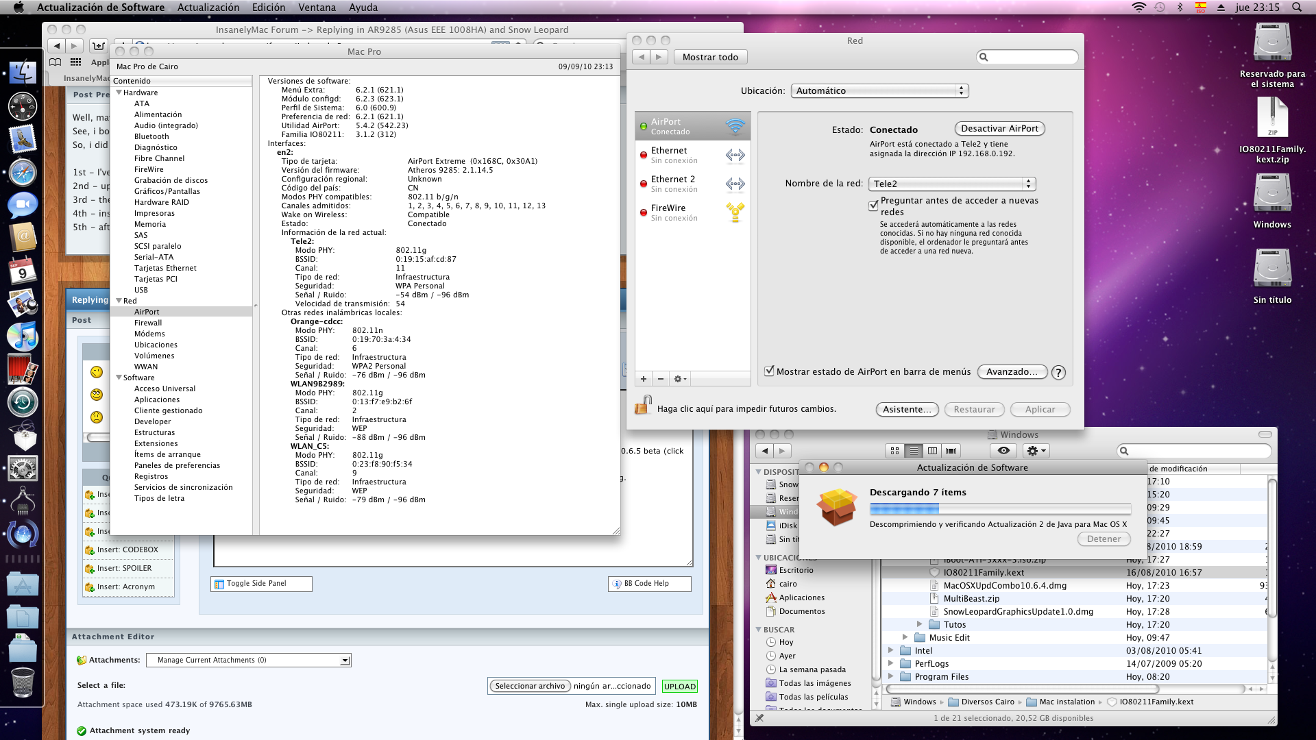

cairo_sc Posted September 16, 2010 Share Posted September 16, 2010 Dude do you have this running on your i7 setup. Yeap, and until now i just have some problems with my mouse, sometimes it disappears, but then from nothing, it comes back. Gonna by a Magic Mouse to fix it =D cairo_sc: Would also like to know if you have this working on an i7. Also, did you have to alter the i080211Family.kext at all. It seems many cards require including the device id to the plist, but I wanted to know if you really got this working out of box. thanks. And, yeap, i got it working out of box, no i080211Family.kext editing, all the work i did was, drag atheros kext into Kext Utility, and that's it =) and still working until now. here's a little screenshot Link to comment https://www.insanelymac.com/forum/topic/190289-solved-ar9285-asus-eee-1008ha-and-snow-leopard/page/2/#findComment-1549582 Share on other sites More sharing options...
bigwiger Posted September 16, 2010 Share Posted September 16, 2010 Cairo_sc: Couldn't wait for a response. Ordered the exact same card as you, followed your instructions, and got it working this morning. One of the easiest modifications yet on my Core i7 SL. Thanks!! Link to comment https://www.insanelymac.com/forum/topic/190289-solved-ar9285-asus-eee-1008ha-and-snow-leopard/page/2/#findComment-1549625 Share on other sites More sharing options...
