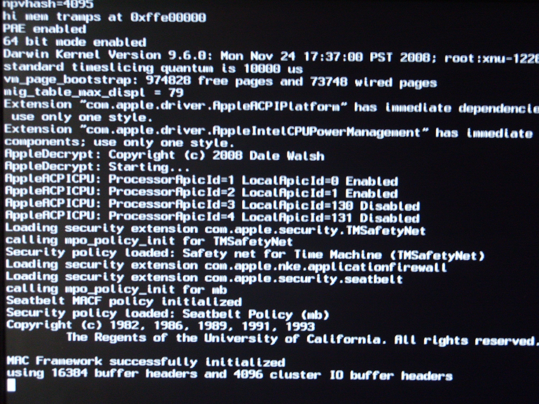

As for the problem itself, I managed to get myself a screenshot of the problem at the point where it just stops completely. Sorry for the quality, my hands were a bit shaky this morning and I had to compress the image to get it under 2MB
I tried these fixes and I still get the same issue.... Ive tried using the ACPI patches from all the DVDs... nothing. Also this AppleACPIPlatform.kext is a real pain to find.... I can't seem to get my hands on anything other than one from 10.5.5

Well I managed to somehow fix it. :)
There was a kext set that was just slightly out of my sight the last few times I tried installing OS X in the XxX Leo installer DVD. The kext set is in the Others category called "Old ACPI/APIC kexts". This along with the DSDT and Chameleon bootloader allows me to boot into OS X without the cpus=1 flag AND I no longer get the mac framework error.
Now the only downside is that Sys. Profiler is not registering my OC'd processor with the correct clock speed. Hopefully its just cosmetic, or at least easy to solve.
Anyway for those who don't have the XxX Leo installer DVD here are the kexts my system is running on atm
