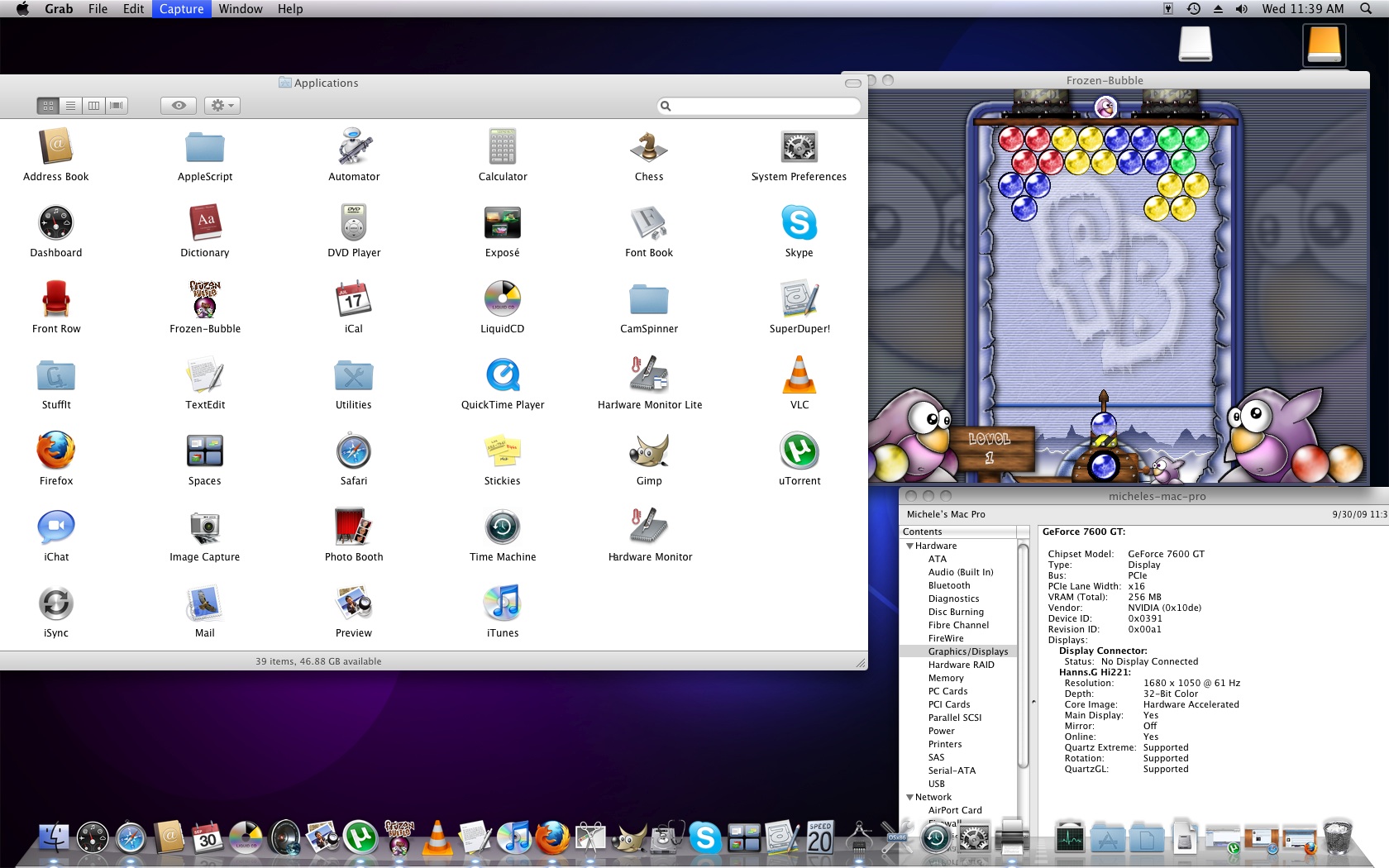

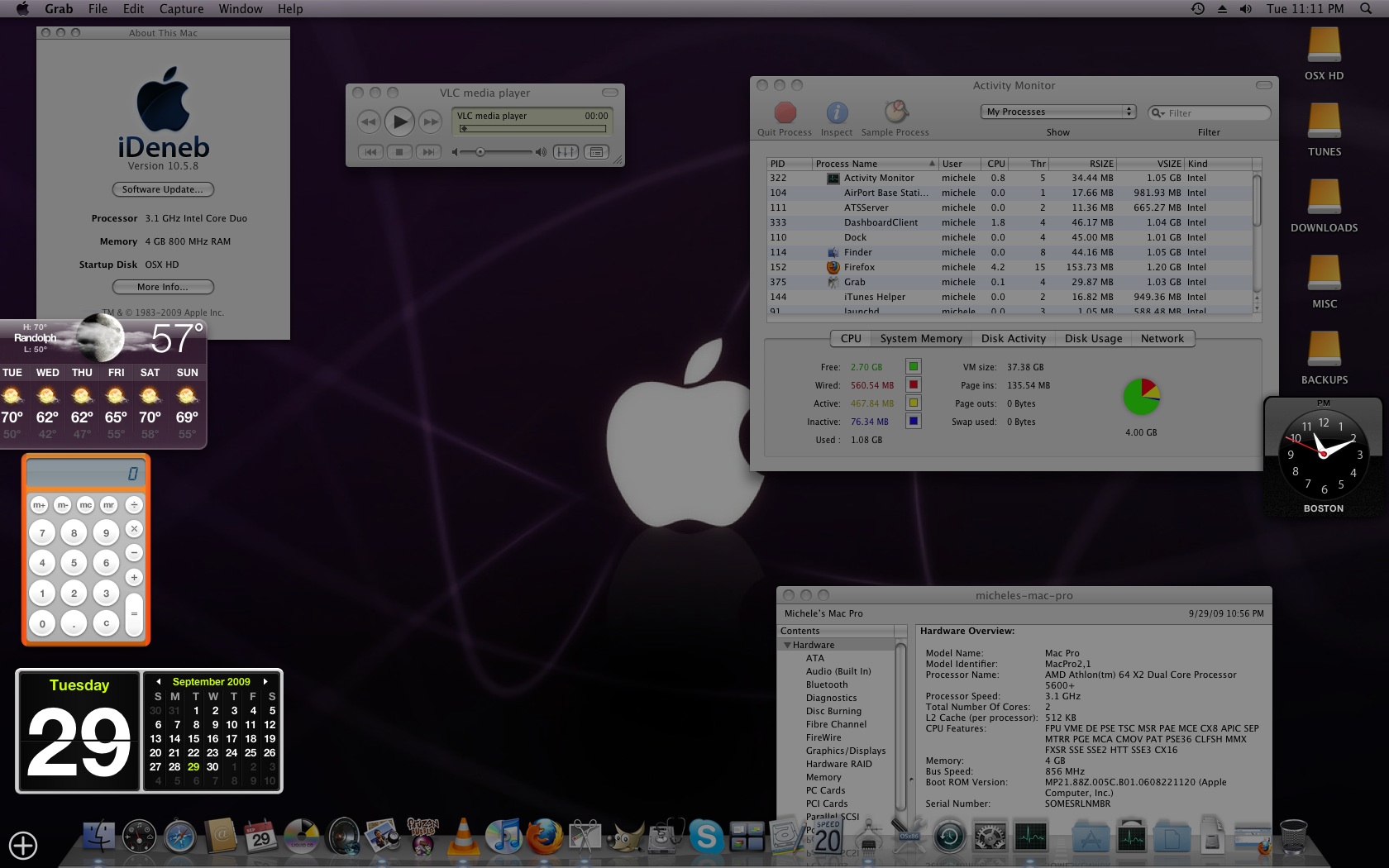

DappleBook Posted September 24, 2009 Share Posted September 24, 2009 After much reading and trying a bunch of different flavors, finally got a fully functional Hackintosh AMD desktop on my recent AMD build. This is my fourth Hackintosh machine, three being on an AMD box. I'm finding the iDeneb packages to work the best on AMD computers and I have tried several other flavors to be sure. Gigabyte GA-MA790X-UD4 w/F5 bios/Athlon 64X2 5600+/4GB Ram/GeForce 7600GT 256MB/250GB SATA HD/SATA DVDRW Installation: AHCI in bios - boot from Sata Drive, Chameleon 2, Apple AtiATA for SB chipset, Voodoo 9.5, NV Kush, Realtek 8169/8111 lan drivers, shutdown fix, seatbelt kext. Everything worked OOB except the ALC889A audio. Used a modded applehda.kext from a thread on this forum to get basic sound output/mic in but hoping for a simple/complete fix at some point. USB, QE/CI, shutdown/restart, etc all working oob. Note: After installation/reboot enter bios and change first boot device to HD, second boot device to Sata Drive, then restart again (leave DVD in drive until you boot fully to OSX). Link to comment https://www.insanelymac.com/forum/topic/188580-ideneb-1058-lite-version-gigabyte-ga-ma790x-ud4/ Share on other sites More sharing options...
