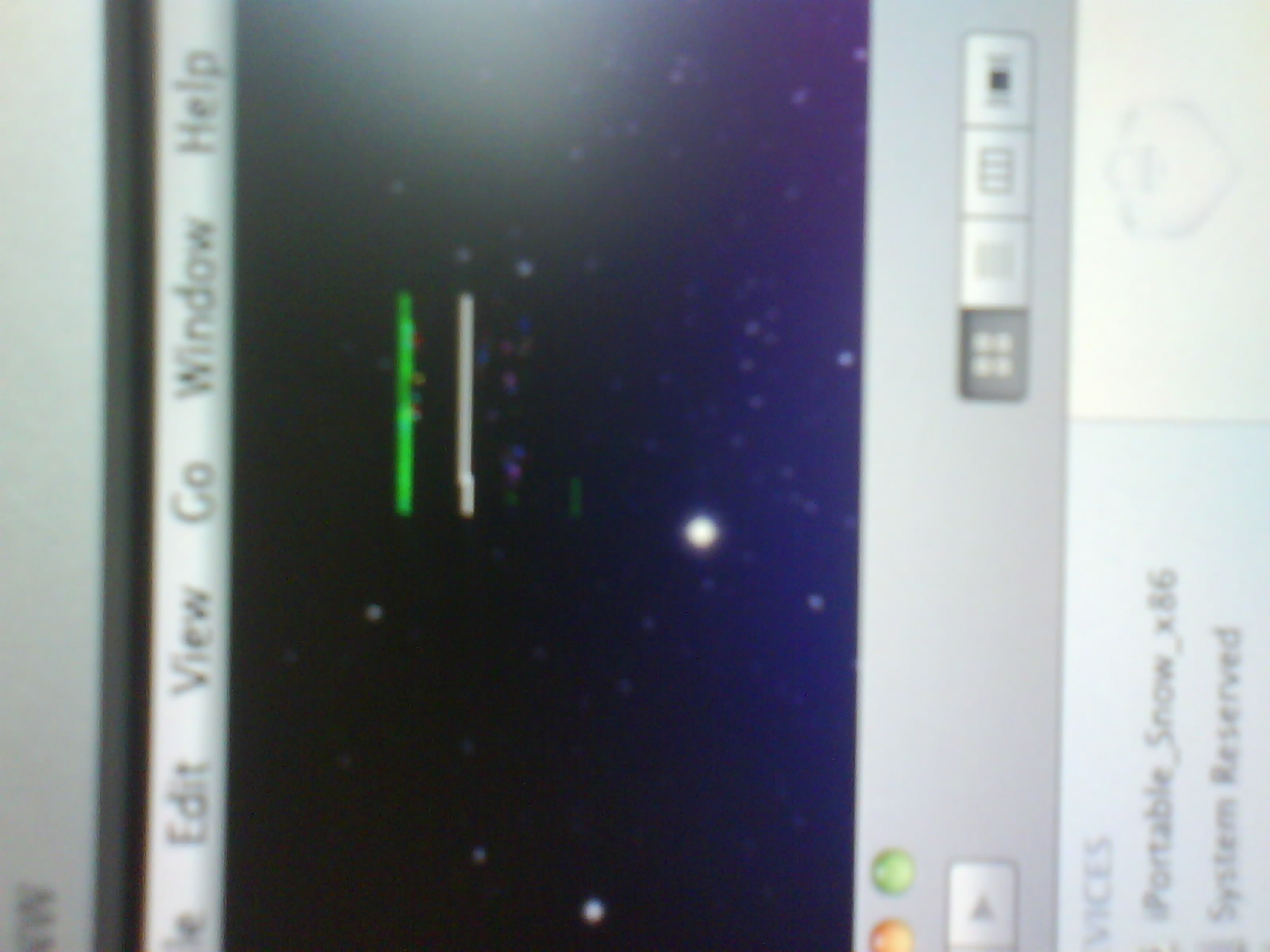

sha2nk singh Posted July 7, 2010 Share Posted July 7, 2010 First of all i am not a system programmer.. Its just a pure tweak.. Many of users reporting mouse artifact for their compaq and lenovo laptop's having Intel 4500 MHD (Dev ID 2a42). As shown in the below picture. I have hexedited the AppleIntelGMAX3100FB.kext (Version 1.5.48) using Lavender.t's post to make use of software cursor instead of a hardware cursor. You can see the result u should only install this kext if u having 4500MHD (2a42) and also with an mouse artifact. It will not enable QE/CI for your mac. Steps to install 1.Download kexthelper. 2.Download the Edited Kext AppleIntelGMAX3100FB_softcursor_sleep.kext.zip 3.Extract It. 4.Drag the kext to kext helper> Type the admin password> and click easy install 5.Reboot with bootflags '-f -v Type: Display Bus: Built-In VRAM (Total): 64 MB of shared system memory Vendor: Intel (0x8086) Device ID: 0x2a42 Revision ID: 0x0007 Kernel Extension Info: No Kext Loaded Displays: Display: Resolution: 1024 x 768 Depth: 32-bit Color Core Image: Software Main Display: Yes Mirror: Off Online: Yes Quartz Extreme: Not Supported Thankz to Lavender.t I applied it to My DELL Inspiron 1440 , but after reboot, screen gets black. my graphic specification is as under Link to comment Share on other sites More sharing options...

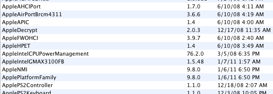

anhhnt Posted January 10, 2011 Share Posted January 10, 2011 I'm using 10.5.8 and this patch work properly, but in System profiler, only AppleIntelGMAX3100FB.kext loaded, the AppleIntelGMAX3100 was not loaded, so I have a small doubt, do we need both two kext loaded or only the FB kext loaded, I attached screenshot for easily understand because my bad english Link to comment Share on other sites More sharing options...
