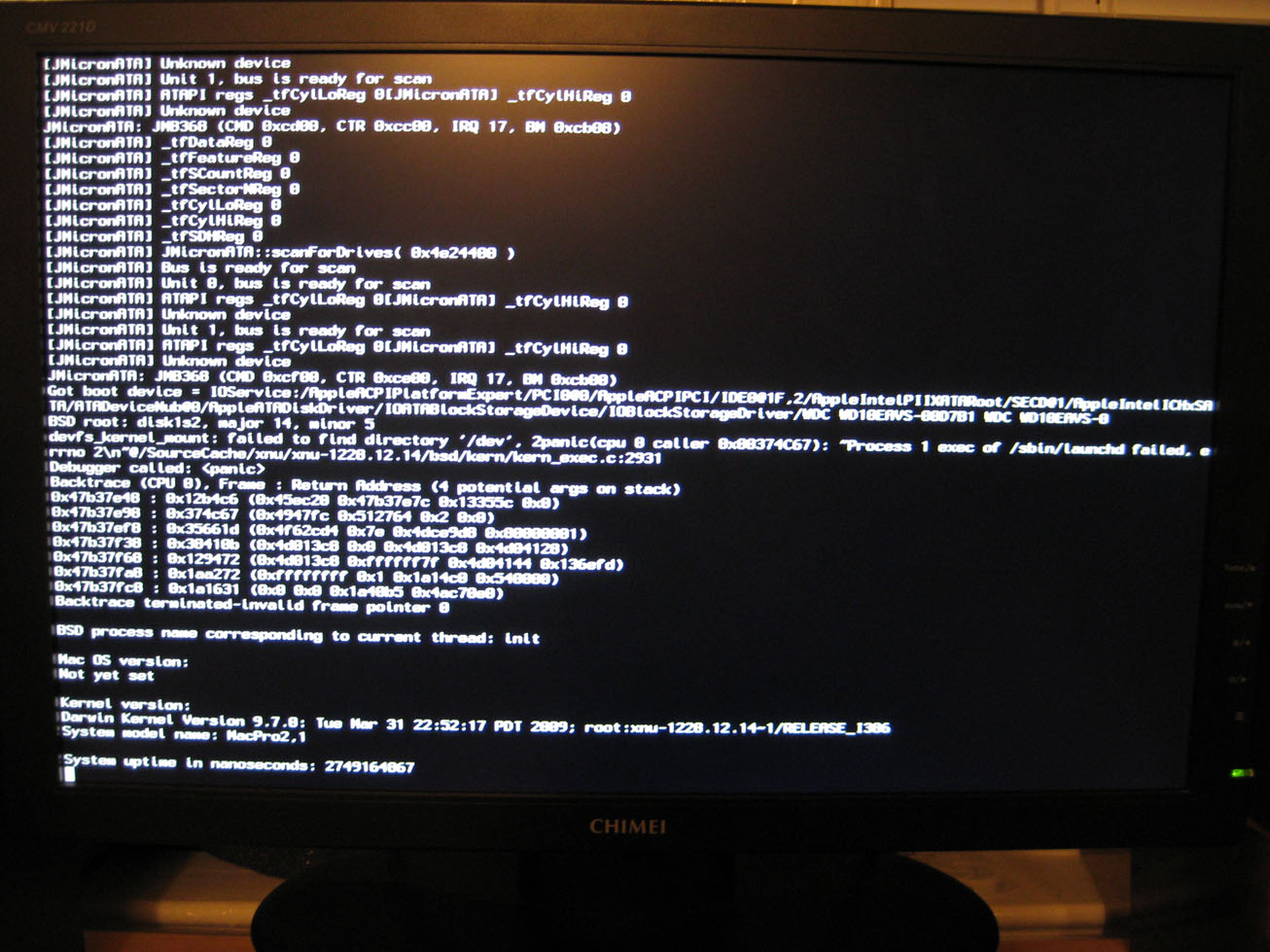

Comodin Posted September 14, 2009 Share Posted September 14, 2009 trying to upgrade to SL on a biostar tp35d2-a7 (uncommon board) with the Chameleon 2 RC3 r658 Installation Package.i was getting a KP at appleintelcpupowermanagement but using NullCPUPowerManagement.kext fixed that. my new KP looks like this and i'm not sure where to start. any ideas? I had the exact same Kernel Panic. You just have to change the advanced settings/drive configuration and disabled auto mode (bios). That worked with my mobo. Regards; Efrén. Link to comment https://www.insanelymac.com/forum/topic/186396-biostar-tp35d2-a7-ich9-wpn311-nvidia-8800-gts-106-snow-leopard-resource/#findComment-1266028 Share on other sites More sharing options...

inimicus Posted September 15, 2009 Share Posted September 15, 2009 Your KP screenshot shows it's using a Leopard 9.7 kernel. You should be using 10.x kernel from/for Snow Leopard. Your KP screenshot shows it's using a Leopard 9.7 kernel. You should be using 10.x kernel from/for Snow Leopard. Link to comment https://www.insanelymac.com/forum/topic/186396-biostar-tp35d2-a7-ich9-wpn311-nvidia-8800-gts-106-snow-leopard-resource/#findComment-1266645 Share on other sites More sharing options...
