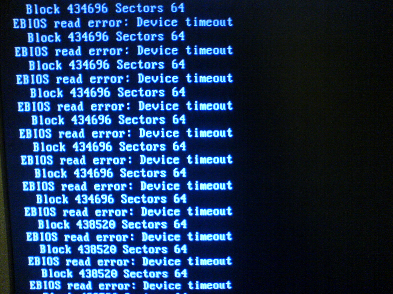

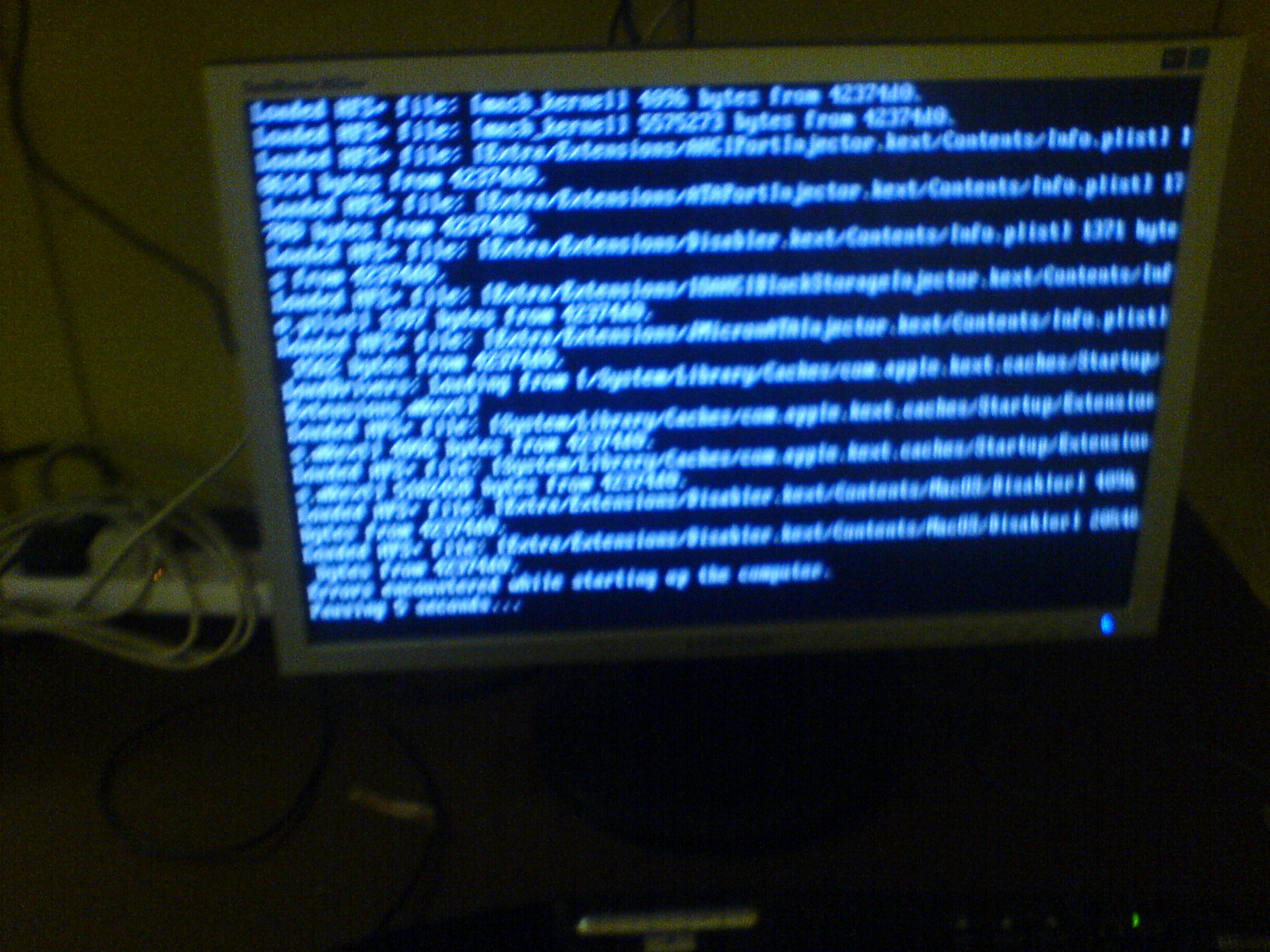

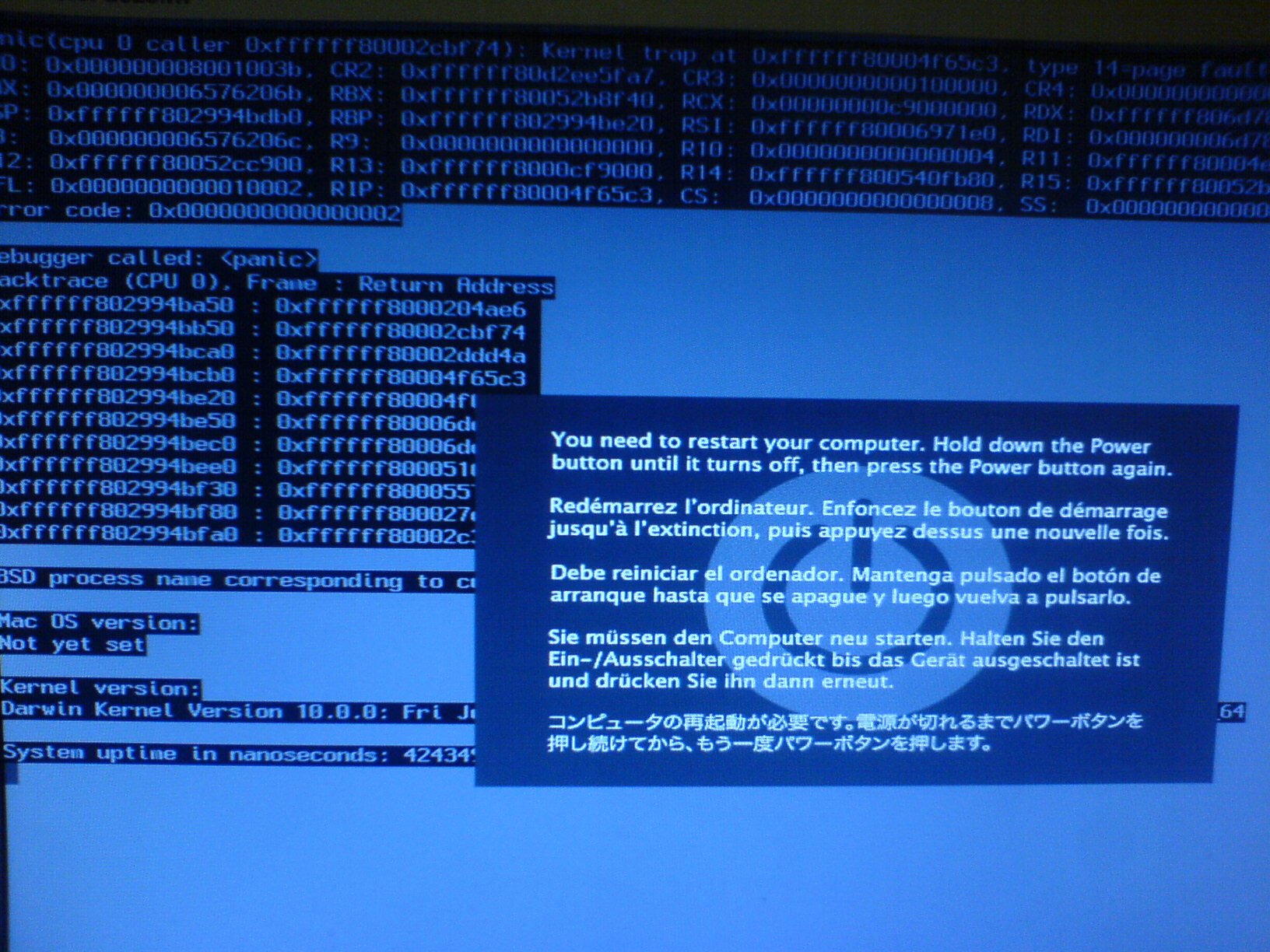

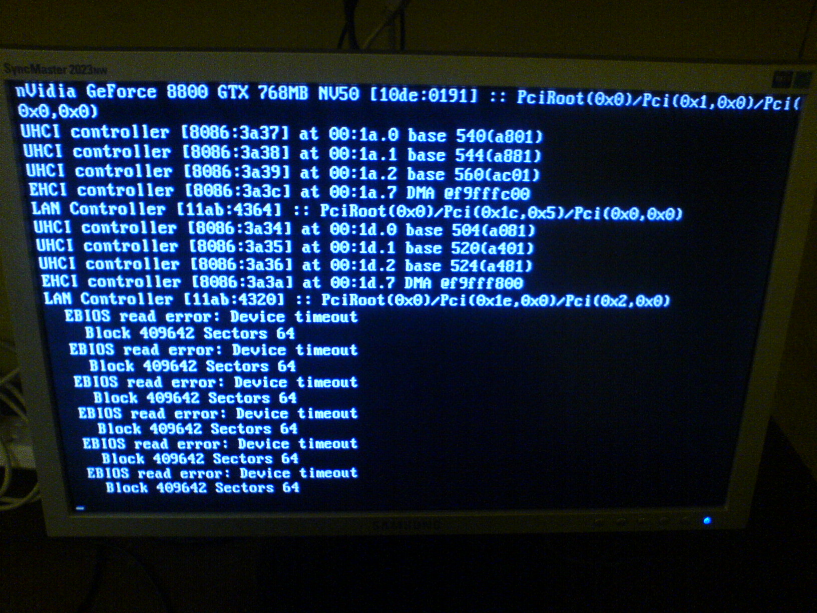

davidkozat88 Posted February 1, 2010 Share Posted February 1, 2010 HI guys first ill like to say thanks to people that to make this possible is a great achievement lol I been trying to follow Shaumaux way of installing snow leopard on my P5Q deluxe and for some reason everytime I try to boot it from the usb image i created it crashes after the HDD logo and and black letters come down and tell me to shut down so am really stuck I wonder if someone should post a youtube video maybe a lot of people would benefit from this?.. Link to comment https://www.insanelymac.com/forum/topic/185231-retail-osx-106-on-p5q-deluxeothers/page/7/#findComment-1401483 Share on other sites More sharing options...
Shaumux Posted February 2, 2010 Author Share Posted February 2, 2010 HI guys first ill like to say thanks to people that to make this possible is a great achievement lol I been trying to follow Shaumaux way of installing snow leopard on my P5Q deluxe and for some reason everytime I try to boot it from the usb image i created it crashes after the HDD logo and and black letters come down and tell me to shut down so am really stuck I wonder if someone should post a youtube video maybe a lot of people would benefit from this?.. What is the error you are getting exactly? Have you tried with -v to see the error? If you are using sleepenabler.kext in /extra/extensions and trying to boot 10.6.2 then it will fail Theres a new sleepenabler for 10.6.2, the previous one is incompatible Link to comment https://www.insanelymac.com/forum/topic/185231-retail-osx-106-on-p5q-deluxeothers/page/7/#findComment-1401774 Share on other sites More sharing options...
davidkozat88 Posted February 2, 2010 Share Posted February 2, 2010 What is the error you are getting exactly?Have you tried with -v to see the error? If you are using sleepenabler.kext in /extra/extensions and trying to boot 10.6.2 then it will fail Theres a new sleepenabler for 10.6.2, the previous one is incompatible what do you mean -v?? all i use is a USB with the instructions you wrote up to Modify the smbios.plist and Replace the SMUUID with this Universal Unique Identifier. Right Click PlatformUUID.kext, Click show Package Contents then go to contents and open info.plist Substitute the Universal Unique Identifier for PlatformUUID. because i dont know how you replace the SMUUID with this Universal Unique Identifier and i can't find the PlatformUUID.kext on the usb i used the Chameleon 2.0 rc2 cos I can't find the package for the RC3 do you know where i can find sleepenabler.kext for 10.6.2? cos i dont have it on the boot usb.... and when i try to boot from usb this i what i get see the attachment thanks you for your time Link to comment https://www.insanelymac.com/forum/topic/185231-retail-osx-106-on-p5q-deluxeothers/page/7/#findComment-1402203 Share on other sites More sharing options...
Shaumux Posted February 2, 2010 Author Share Posted February 2, 2010 what do you mean -v?? all i use is a USB with the instructions you wrote up to Modify the smbios.plist and Replace the SMUUID with this Universal Unique Identifier. Right Click PlatformUUID.kext, Click show Package Contents then go to contents and open info.plist Substitute the Universal Unique Identifier for PlatformUUID. because i dont know how you replace the SMUUID with this Universal Unique Identifier and i can't find the PlatformUUID.kext on the usb i used the Chameleon 2.0 rc2 cos I can't find the package for the RC3 do you know where i can find sleepenabler.kext for 10.6.2? cos i dont have it on the boot usb.... and when i try to boot from usb this i what i get see the attachment thanks you for your time Ok sleepenabler.kext is not important at this point. yopu can delete it for the time being.I think chameleon rc2 is the problem here as i see you are getting kernel panics and kernel version not set. Always use the latest chameleon version, which would be 2.0rc4 now. If you can't find a package do a manual install, its not difficult at all. and all the instructions are given in the documentation. Link to comment https://www.insanelymac.com/forum/topic/185231-retail-osx-106-on-p5q-deluxeothers/page/7/#findComment-1402392 Share on other sites More sharing options...

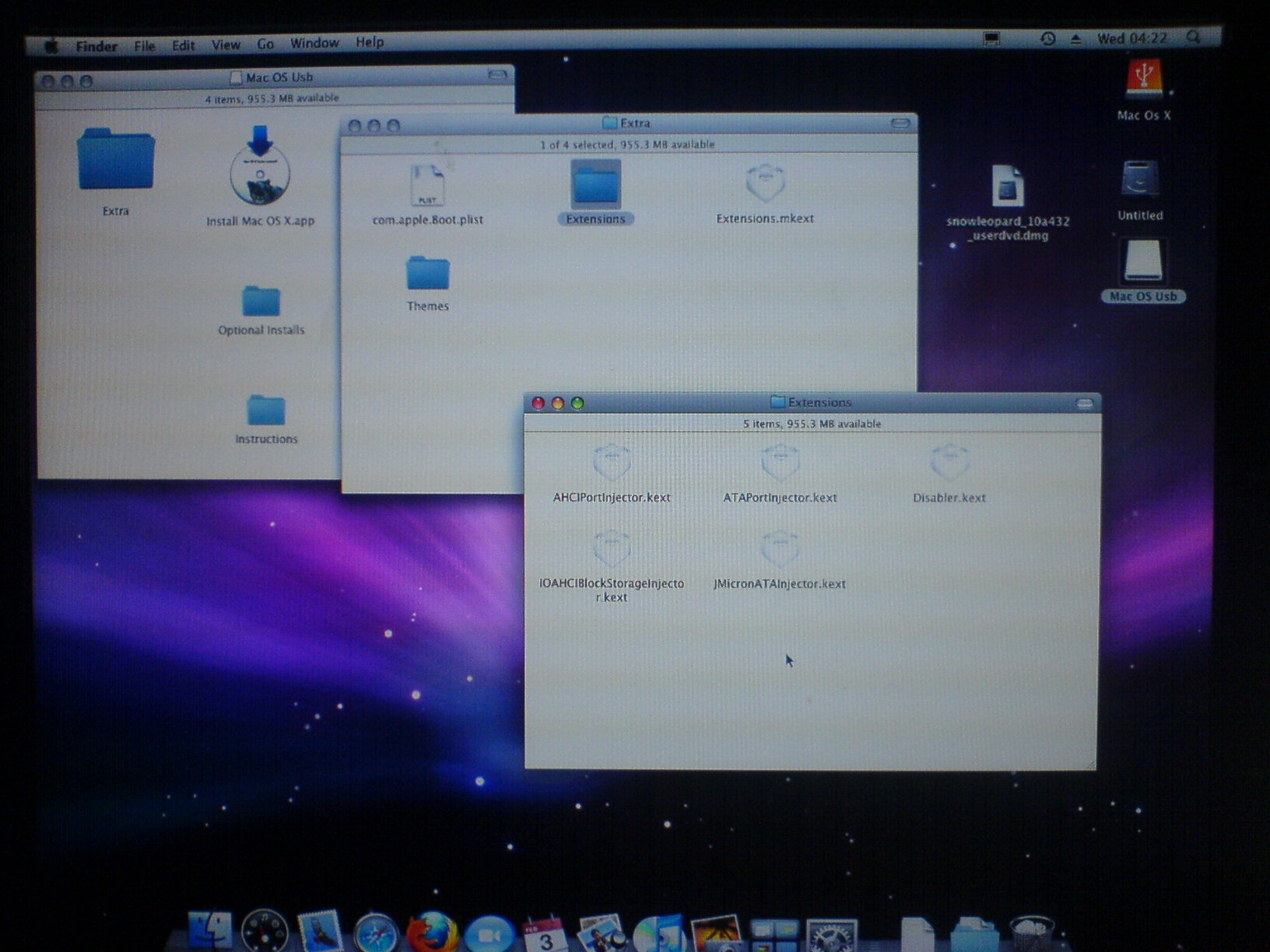

basementjack Posted February 2, 2010 Share Posted February 2, 2010 I agree, I found a few tutorials and then typed chame in my browser, google popped up chameleon, the 3rd or 4th one down was for the osx project, and the first article was on 2.0RC4 - there were download links just to the right of it. Chameleon seems scary at first, but it really isn't that bad. If you haven't already, search google for lifehacker hackintosh - he has a few nice tutorials on how to make the USB key. It's a really great feeling when you get the Vanilla OSX CD to install by yourself, instead of using a distribution like iDeneb. My setup isn't perfect, but it's pretty close and it performs great. I have a P5QPro, or a P5Q Deluxe. Stick to it, it's worth it. Link to comment https://www.insanelymac.com/forum/topic/185231-retail-osx-106-on-p5q-deluxeothers/page/7/#findComment-1402425 Share on other sites More sharing options...
davidkozat88 Posted February 3, 2010 Share Posted February 3, 2010 (edited) I agree, I found a few tutorials and then typed chame in my browser, google popped up chameleon, the 3rd or 4th one down was for the osx project, and the first article was on 2.0RC4 - there were download links just to the right of it. Chameleon seems scary at first, but it really isn't that bad. If you haven't already, search google for lifehacker hackintosh - he has a few nice tutorials on how to make the USB key. It's a really great feeling when you get the Vanilla OSX CD to install by yourself, instead of using a distribution like iDeneb. My setup isn't perfect, but it's pretty close and it performs great. I have a P5QPro, or a P5Q Deluxe. Stick to it, it's worth it. Thank you guys I finally went around installing the 2.0RC4 of chame and am getting the same error do...do you guys now if i got all the kext for the P5Q dlx (which i love by the way) i also instaled the modded bios so i dont think is configuration problem on that department. USB Extras/Extension: AHCIportinjector, ATAportinjector, Disabler, Lmicronatainjector and IOAHCIblockstorageinjector... I have use the tutorial from this site http://www.lifehacker.com.au/2009/09/insta...cking-required/ but it had the same error screen and is for a gigabyte mobo and i believe it wont work so am stuck.... one thing you think I would be able to install RC2 and copy the files from RC4 over just in case I did something wrong throw terminal as am not very good at it... by the way my bootable usb contains the following: Edited February 3, 2010 by davidkozat88 Link to comment https://www.insanelymac.com/forum/topic/185231-retail-osx-106-on-p5q-deluxeothers/page/7/#findComment-1402551 Share on other sites More sharing options...
basementjack Posted February 3, 2010 Share Posted February 3, 2010 I just checked and my Motherboard is a P5Q deluxe. I have bios 2301 installed. (factory) Just so we're working from the same point of reference, here's my understanding of the boot process.... MB is set to boot from USB USB boot loader contains Chameleon Chameleon looks at a few local folders on the USB key and if found 'injects' them into the OS at boot up. On that last part, now that I think about it, I don't really know what that means, I'll have to look the next time I have that machine on to see if our kext's (drivers) 'appear' in the mac file system, even though they aren't really there - that would make sense... Chameleon also masks your systems true identity and often presents it to the OS as a mac pro I think from here out, most of the issues come down to getting the right kext's on the key. Since most P45 chipset boards are likely the same, you could probably pull kext's from anyone who's uploaded what they have. I think I started with someone's gigabyte files and went from there. As it's been mentioned, sleepenabler causes a kernel panic, so best not to use that until later. I couldnt tell from your screen shot what the error was, it appears to be off the top of the picture - sometimes that will let you know which kext died. I remember specifically when I had the sleepenabler issue, I saw sleepenabler on the screen somewhere. I think you can take afew approaches, you can have no kexts and add them one by one to see if that works, or the approach I took was to put a whole bunch in the extensions folder on the usb drive, and boot and look at the error to see what didn't work (within reason - I didn't download every kext under the sun...) As a side note, you do have a supported CPU right? (for reference, I have an E8400 and an GTX9800+ video card) here's my com.apple.Boot.plist: <?xml version="1.0" encoding="UTF-8"?> <!DOCTYPE plist PUBLIC "-//Apple//DTD PLIST 1.0//EN" "http://www.apple.com/DTDs/PropertyList-1.0.dtd"> <plist version="1.0"> <dict> <key>Kernel</key> <string>mach_kernel</string> <key>Kernel Flags</key> <string></string> <key>Timeout</key> <string>10</string> <key>GraphicsEnabler</key> <string>yes</string> <key>EthernetBuiltIn</key> <string>Yes</string> <key>Default Partition</key> <string>hd(1,2)</string> </dict> </plist> Be sure to only use the Graphics Enabler if you have an Nvidia card. Here's all the kexts in the prefs folder on my usbkey. I can't honestly say that they're all needed and I still have a shutdown issue to resolve, but I can say that the system works, has sound, has built in networking, and works on 2 DVI displays. And it sleeps fine if I tell it to, but not after 20 minutes like it should. AD2000b.kext (this is for sound) AHCIPortInjector.kext AppleIntelPIIXATA.kext AppleMikeyDriver.kext AppleRTC.kext AppleYukon2.kext AttansicL1eEthernet.kext CPUInjector.kext DspFuncLib.kext HDAEnabler.kext HDEFEnabler.kext IOAHCIBlockStorageInjector.kext IOATABlockStorage.kext IOATAFamily.kext IOATAPIProtocolTransport.kext IOAudioFamily.kext IONetworkingFamily.kext NullCPUPowerManagement.kext OSvKernDSPLib.kext PlatformUUID.kext SleepEnabler.kext UUID.kext fakesmc.kext Link to comment https://www.insanelymac.com/forum/topic/185231-retail-osx-106-on-p5q-deluxeothers/page/7/#findComment-1402560 Share on other sites More sharing options...
davidkozat88 Posted February 3, 2010 Share Posted February 3, 2010 Thank mate I have on the usb chame rc4 now (I think LOL) and a CPU e5500 but ill be using the q9650 also a modded bios from Shaumux a 9800 gt Nvidia of course and onboard sound dude were do you get those kext from I only have 5 from when you install chame... X-( ?? do i need anything else after installing chame not kext related like a boot file of some kind?? by the way when i tried to boot from usb last time it didnt enter the logo i -v and it says ebios read error device timedout and tells me the block xxxxxx sectors 64 Link to comment https://www.insanelymac.com/forum/topic/185231-retail-osx-106-on-p5q-deluxeothers/page/7/#findComment-1402565 Share on other sites More sharing options...
davidkozat88 Posted February 3, 2010 Share Posted February 3, 2010 well it look like when i use a bootloader that i burned on a cd called 132Jupiter it actually has chame rc4 i believe it lets me select the USB which has an image of snow leopard and am gonna try to install it on a sata hdd let ya know what happens if i need a driver ex sound or video can i the get the kext and install it after the os in on the hdd right? or do i have to install the os everytime lol? Link to comment https://www.insanelymac.com/forum/topic/185231-retail-osx-106-on-p5q-deluxeothers/page/7/#findComment-1402592 Share on other sites More sharing options...
Shaumux Posted February 3, 2010 Author Share Posted February 3, 2010 well it look like when i use a bootloader that i burned on a cd called 132Jupiter it actually has chame rc4 i believe it lets me select the USB which has an image of snow leopard and am gonna try to install it on a sata hdd let ya know what happens if i need a driver ex sound or video can i the get the kext and install it after the os in on the hdd right? or do i have to install the os everytime lol? you are missing some really important files like the fakesmc.kext which is absolutely necessary in this case. Also you are missing smbios.plist and platformuuid.kext. Seiing the first pic you posted i think the error was due to missing fakesmc.kext and maybe smbios.plist Get fakesmc.kext 2.5 or whatever the latest version is there by netkas. Link to comment https://www.insanelymac.com/forum/topic/185231-retail-osx-106-on-p5q-deluxeothers/page/7/#findComment-1402604 Share on other sites More sharing options...
