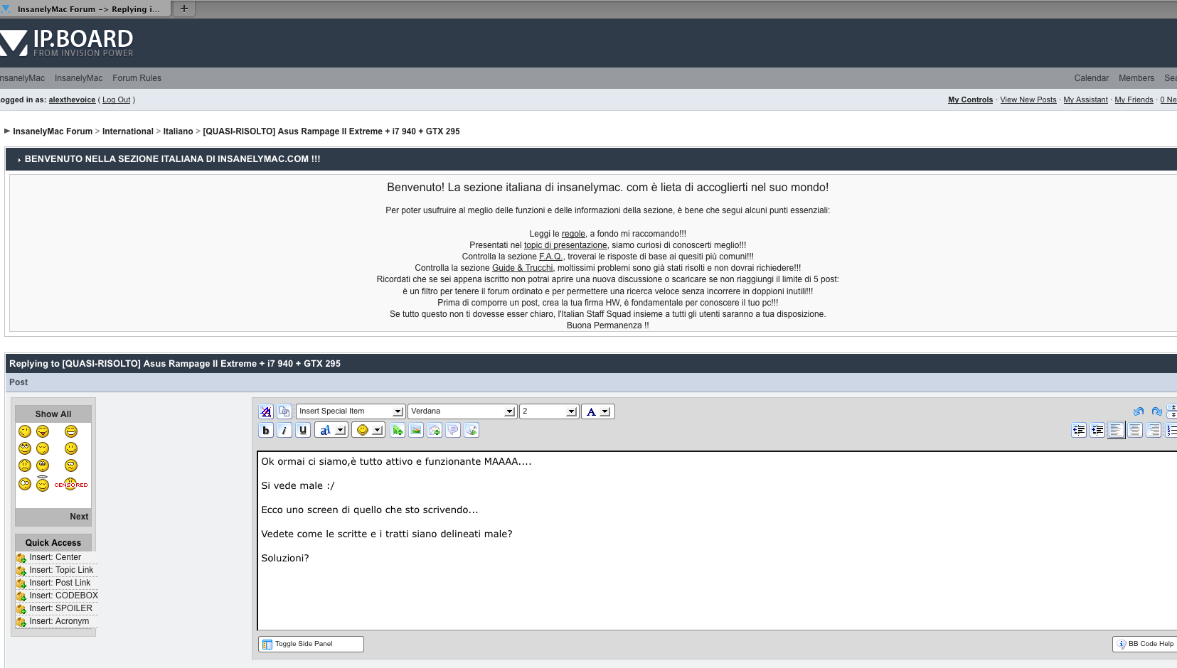

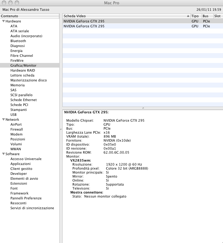

alexthevoice Posted January 27, 2011 Share Posted January 27, 2011 Hello! I'm an italian user that have a GTX 295, i've follow installation guide, everything seems ok but i've a problem: characters are very bad! Look at this image, there don't appear clearly.... but if I see an HD video it look pretty good so acceleration seems ok.... I post an image of my system profile... I've a ViewSonic VX2835vm, DVI-HDMI cable (DVI in GTX, HDMI in monitor)... Thank to everybody! Link to comment https://www.insanelymac.com/forum/topic/184318-snow-leopard-and-evga-gtx-295/page/7/#findComment-1630108 Share on other sites More sharing options...
alexthevoice Posted January 27, 2011 Share Posted January 27, 2011 Sorry, i fogot to say, I use Snow Leopard retail ver. 10.6.6 Link to comment https://www.insanelymac.com/forum/topic/184318-snow-leopard-and-evga-gtx-295/page/7/#findComment-1630364 Share on other sites More sharing options...

alexthevoice Posted January 31, 2011 Share Posted January 31, 2011 EVerything now it's ok, I've resolved with VGA cable, not DVI/HDMI.. Link to comment https://www.insanelymac.com/forum/topic/184318-snow-leopard-and-evga-gtx-295/page/7/#findComment-1632346 Share on other sites More sharing options...
