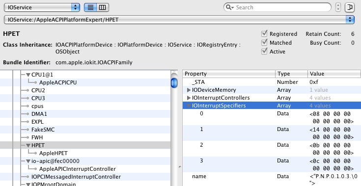

waneto Posted September 4, 2009 Share Posted September 4, 2009 I find the problems finally! When I face this: AppleUSBEHCI[0x3849800]: unable to get filterInterruptEventSource I find that AppleHPET use 4 IRQs which contains 0x00000014, this 0x00000014 is for usb so my usb EHC2 and usb5 can not work, others r ok but sometimes it is ok, and AppleHPET use just 3 IRQs not contain 0x000000014. And my cpu is Intel Core2 Duo P7350 2.0GHz*2, my os is snow leopard 10A432. PS:when I use leopard, they r all ok, and appleHPET only use 3 IRQs, always ok. Link to comment https://www.insanelymac.com/forum/topic/183996-solvedapplehpet-crash-usb-remove-it/ Share on other sites More sharing options...

mitch_de Posted September 13, 2009 Share Posted September 13, 2009 I find the problems finally! When I face this: AppleUSBEHCI[0x3849800]: unable to get filterInterruptEventSource I find that AppleHPET use 4 IRQs which contains 0x00000014, this 0x00000014 is for usb so my usb EHC2 and usb5 can not work, others r ok but sometimes it is ok, and AppleHPET use just 3 IRQs not contain 0x000000014. PS:when I use leopard, they r all ok, and appleHPET only use 3 IRQs, always ok. IoRegistryExplorer can show the interupts used. I looked (GA-EP35-DS3, no USB probs) in 10.5, but for me there are 4 IRQ´s (10.5) used, not 3 like at your system(10.5). So i think it depens of the mainboard ! Try to disable all things in the mainboard bios, which you dont need - that frees interrupts !!! Like : serial ports, LPT port, IDE devices, FW devices, .... . Disabling HPET maybe an workaround, but the side effect is an much less excat timer and much more cpu overhead using the RTC.kext. An modded IOPCI.kext which was already(10.5) optimized (by AnV, SLICE) in the interrupt handling (beside SDCARD support) wasnt made for 10.6 . Sources are available so perhaps soon such an 10.6 IOPCI.kext may also help (in addition with disabling all not needed devices in bios). Link to comment https://www.insanelymac.com/forum/topic/183996-solvedapplehpet-crash-usb-remove-it/#findComment-1263971 Share on other sites More sharing options...
