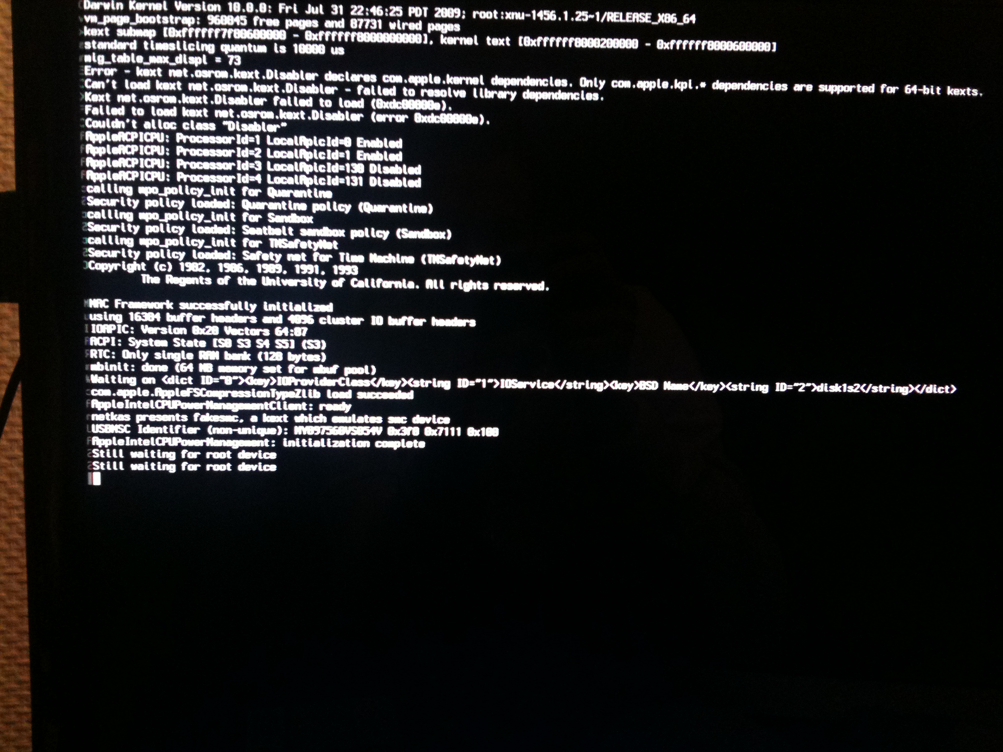

ritalou Posted August 30, 2009 Share Posted August 30, 2009 Hey guys, yesterday, i installed SL on my SATA drive to boot it with Chameleon. First boot in verbose gave me a Still Waiting For Root Device. So i tried to boot in 32 bits (with -x32), then i obtain a Kernel Panic. I looked in my Bios (I'm using a Asus P5K SE/EPU) but i can't activate the AHCI, there is no option for it. I tried to put Sata Configuration in Compatible, it doesn't work again. Does anyone have an idea for my problem ? Thanks and sorry for the english (i'm french ) Link to comment https://www.insanelymac.com/forum/topic/182887-snow-leopard-without-ahci/ Share on other sites More sharing options...

ritalou Posted August 31, 2009 Author Share Posted August 31, 2009 Yes, you should use the kext from here Intel ATA support for Snow Leopard Thanks for your answer, but I still have a KP in 32 Bits and a Still Waiting in 64. What I've done is to put the kext in de AdditionalExtension of the Extra folder, to rebuild the Extensions.mkext and to reboot. Whare's the problem ? Link to comment https://www.insanelymac.com/forum/topic/182887-snow-leopard-without-ahci/#findComment-1243689 Share on other sites More sharing options...
thenorton Posted August 31, 2009 Share Posted August 31, 2009 Same here. On P5K-SE/EPU, Still Waiting For Root Device... Link to comment https://www.insanelymac.com/forum/topic/182887-snow-leopard-without-ahci/#findComment-1244967 Share on other sites More sharing options...

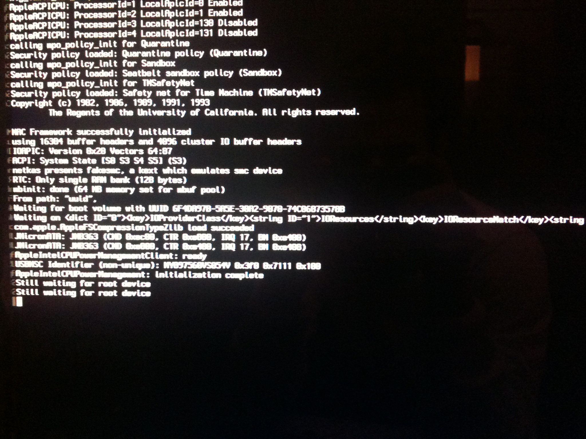

vbxeric Posted September 1, 2009 Share Posted September 1, 2009 Same here.On P5K-SE/EPU, Still Waiting For Root Device... Same for me on a P5K. I found a tip on the asus forum. The Intel ATA support for Snow Leopard doesn't work for me. I've also tried to use PlatformUUID.kext and it is still the same. I uploaded a picture of my issue. Is it the same for you ?! Please need some help, how can i boot SL on my P5K. (I bought the retail DVD 29euros and received it but i can't use it..) Link to comment https://www.insanelymac.com/forum/topic/182887-snow-leopard-without-ahci/#findComment-1246513 Share on other sites More sharing options...

ricola Posted September 1, 2009 Share Posted September 1, 2009 vbxeric, from this picture your KP is from AppleIntelCPUPowerManagement "loading", you need NullCPUPowerManagement.kext to "time out" em Link to comment https://www.insanelymac.com/forum/topic/182887-snow-leopard-without-ahci/#findComment-1246536 Share on other sites More sharing options...
vbxeric Posted September 1, 2009 Share Posted September 1, 2009 this is not a KP If you look the picture, you will see that SL is waiting for boot volume with uuid ............ After he says that he is waiting on <dict.......> and Jmicron is loading And finally --> still waiting for root device It means that SL cannot find the path to load the system i think.... Link to comment https://www.insanelymac.com/forum/topic/182887-snow-leopard-without-ahci/#findComment-1246581 Share on other sites More sharing options...
ricola Posted September 1, 2009 Share Posted September 1, 2009 The kexts were loaded .. and from where do you think the loader read the kext from? try this : - Delete AppleIntelCPUPowerManagement.kext & AppleIntelCPUPowerManagementClient.kext - or add NullCPUPowerManagement.kext good luck Link to comment https://www.insanelymac.com/forum/topic/182887-snow-leopard-without-ahci/#findComment-1246596 Share on other sites More sharing options...

Arial Posted September 1, 2009 Share Posted September 1, 2009 this is not a KPIf you look the picture, you will see that SL is waiting for boot volume with uuid ............ After he says that he is waiting on <dict.......> and Jmicron is loading And finally --> still waiting for root device It means that SL cannot find the path to load the system i think.... I think so. that was my problem too. It should be "Got boot device.." if boot-uuid device found. then I added my SATA/IDE DevIDs to info.plist Netkas's AppleIntelPIIXATA.kext. Solved. If your SATA/IDE controller DevIDs already there, try another thing.. Go to BIOS Setup and set "SATA Configuration = Enhanced, S-ATA" or try other settings. Could you tell us how exactly to do that? Where do I find these SATA device IDs? use LSPCI http://www.insanelymac.com/forum/index.php?showtopic=113219 http://www.mediafire.com/?znzzutj2dot or DPCIManager http://rapidshare.com/files/271683580/DPCIManager.dmg Link to comment https://www.insanelymac.com/forum/topic/182887-snow-leopard-without-ahci/#findComment-1246725 Share on other sites More sharing options...
newwindow Posted September 1, 2009 Share Posted September 1, 2009 Thanks a lot, I tried that. Unfortunately, I still get a "still waiting for root device". My boot.plist even contains the correct UUID. Any ideas? Link to comment https://www.insanelymac.com/forum/topic/182887-snow-leopard-without-ahci/#findComment-1246776 Share on other sites More sharing options...
vbxeric Posted September 1, 2009 Share Posted September 1, 2009 I think so. that was my problem too. It should be "Got boot device.." if boot-uuid device found. then I added my SATA/IDE DevIDs to info.plist Netkas's AppleIntelPIIXATA.kext. Solved. If your SATA/IDE controller DevIDs already there, try another thing.. Go to BIOS Setup and set "SATA Configuration = Enhanced, S-ATA" or try other settings. use LSPCI http://www.insanelymac.com/forum/index.php?showtopic=113219 http://www.mediafire.com/?znzzutj2dot or DPCIManager http://rapidshare.com/files/271683580/DPCIManager.dmg It doesnt work for me ... :s but something have changed before the still waiting for root device, now i dont see the "Waiting for boot volume with uuid ........... line I only see the waiting on <dict ID=0"><key>IOProviderClass</key><string ID="1">IOService</string ID=2>disk1s2</string></dict> I don't understand why i stilll have this message --> Still waiting for root device :/ Link to comment https://www.insanelymac.com/forum/topic/182887-snow-leopard-without-ahci/#findComment-1246904 Share on other sites More sharing options...

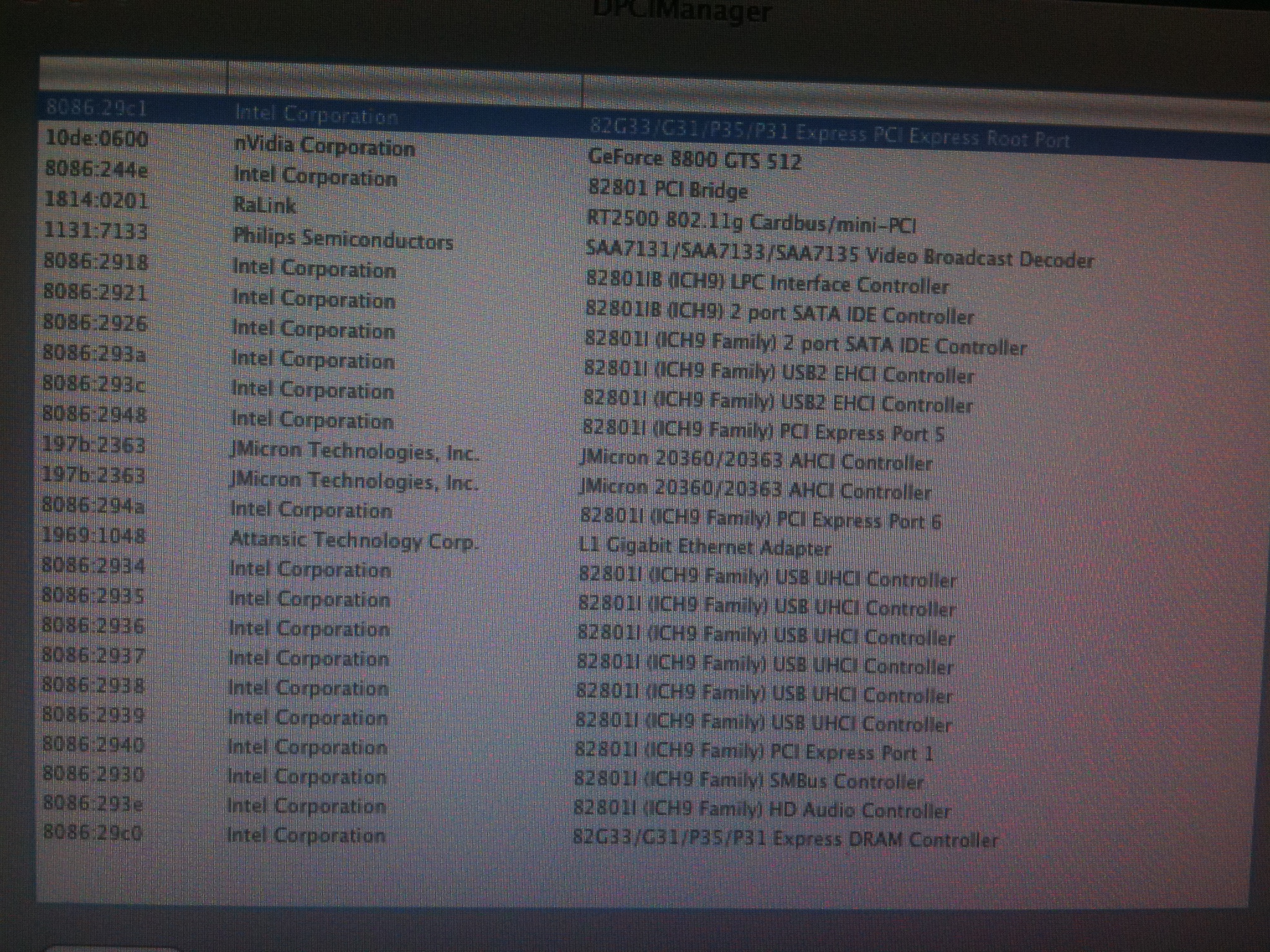

ricola Posted September 2, 2009 Share Posted September 2, 2009 Check your HDD controller dev id's with lspci or DPCIManager After that .. post it here Link to comment https://www.insanelymac.com/forum/topic/182887-snow-leopard-without-ahci/#findComment-1247360 Share on other sites More sharing options...
vbxeric Posted September 2, 2009 Share Posted September 2, 2009 Here is the full list of my hardware Enjoy ^^ Link to comment https://www.insanelymac.com/forum/topic/182887-snow-leopard-without-ahci/#findComment-1247586 Share on other sites More sharing options...
Arial Posted September 2, 2009 Share Posted September 2, 2009 @vbxeric: it would be helpful if type it manually or just install LSPCI type in Terminal: lspci -nn then copy+paste here. or use OSx86Tools > View PCI Device / Vendor ID > Run LSPCI. it will generate lspci.txt onto your root volume. Link to comment https://www.insanelymac.com/forum/topic/182887-snow-leopard-without-ahci/#findComment-1247740 Share on other sites More sharing options...
ricola Posted September 2, 2009 Share Posted September 2, 2009 yea .. just paste the text here Link to comment https://www.insanelymac.com/forum/topic/182887-snow-leopard-without-ahci/#findComment-1247811 Share on other sites More sharing options...
vbxeric Posted September 3, 2009 Share Posted September 3, 2009 Here it is 00:00.0 Host bridge [0600]: Intel Corporation DRAM Controller [8086:29c0] (rev 02) 00:01.0 PCI bridge [0604]: Intel Corporation PCI Express Root Port [8086:29c1] (rev 02) 00:1a.0 USB Controller [0c03]: Intel Corporation USB UHCI Controller #4 [8086:2937] (rev 02) 00:1a.1 USB Controller [0c03]: Intel Corporation USB UHCI Controller #5 [8086:2938] (rev 02) 00:1a.2 USB Controller [0c03]: Intel Corporation USB UHCI Controller #6 [8086:2939] (rev 02) 00:1a.7 USB Controller [0c03]: Intel Corporation USB2 EHCI Controller #2 [8086:293c] (rev 02) 00:1b.0 Audio device [0403]: Intel Corporation HD Audio Controller [8086:293e] (rev 02) 00:1c.0 PCI bridge [0604]: Intel Corporation PCI Express Port 1 [8086:2940] (rev 02) 00:1c.4 PCI bridge [0604]: Intel Corporation PCI Express Port 5 [8086:2948] (rev 02) 00:1c.5 PCI bridge [0604]: Intel Corporation PCI Express Port 6 [8086:294a] (rev 02) 00:1d.0 USB Controller [0c03]: Intel Corporation USB UHCI Controller #1 [8086:2934] (rev 02) 00:1d.1 USB Controller [0c03]: Intel Corporation USB UHCI Controller #2 [8086:2935] (rev 02) 00:1d.2 USB Controller [0c03]: Intel Corporation USB UHCI Controller #3 [8086:2936] (rev 02) 00:1d.7 USB Controller [0c03]: Intel Corporation USB2 EHCI Controller #1 [8086:293a] (rev 02) 00:1e.0 PCI bridge [0604]: Intel Corporation 82801 PCI Bridge [8086:244e] (rev 92) 00:1f.0 ISA bridge [0601]: Intel Corporation LPC Interface Controller [8086:2918] (rev 02) 00:1f.2 IDE interface [0101]: Intel Corporation 2 port SATA IDE Controller [8086:2921] (rev 02) 00:1f.3 SMBus [0c05]: Intel Corporation SMBus Controller [8086:2930] (rev 02) 00:1f.5 IDE interface [0101]: Intel Corporation 2 port SATA IDE Controller [8086:2926] (rev 02) 01:00.0 VGA compatible controller [0300]: nVidia Corporation Device [10de:0600] (rev a2) 02:00.0 Ethernet controller [0200]: Attansic Technology Corp. L1 Gigabit Ethernet Adapter [1969:1048] (rev b0) 03:00.0 SATA controller [0106]: JMicron Technologies, Inc. JMicron 20360/20363 AHCI Controller [197b:2363] (rev 03) 03:00.1 IDE interface [0101]: JMicron Technologies, Inc. JMicron 20360/20363 AHCI Controller [197b:2363] (rev 03) 05:01.0 Multimedia controller [0480]: Philips Semiconductors SAA7133/SAA7135 Video Broadcast Decoder [1131:7133] (rev d1) 05:02.0 Network controller [0280]: RaLink RT2500 802.11g Cardbus/mini-PCI [1814:0201] (rev 01) Hope you wanted it like that ! And Hope that you'll find a solution for me because i bought the retail and i can't use it... Link to comment https://www.insanelymac.com/forum/topic/182887-snow-leopard-without-ahci/#findComment-1249143 Share on other sites More sharing options...
