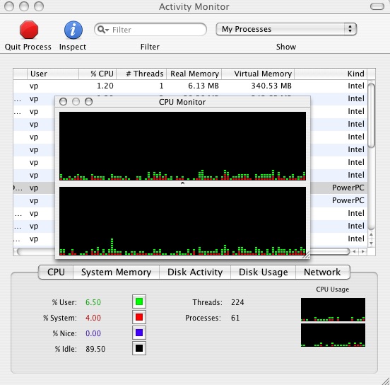

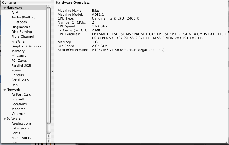

AlexM Posted May 24, 2006 Share Posted May 24, 2006 It seems to be the case that the new Intel 945GM Chipset has a few problems mainly with the Lan and audio. Don't buy the intel wireless card (most people do for this chipset) as it will not work. Vinayp has managed a successful install of OS X 10..4.6 on an MSI 1057 (S262) sporting the aforementioned chipset and may offer help to users experiencing problems with this popular motherboard - biggest problem tends to be the sound. A first (from looking round the forums) BOTH CORES ARE ON, running and utilised by OS X!!!!!!!!!!!!!! Take it from here Vinayp, Patrick who should join also needs help getting the sound working on his 945GM Chipset... P.S. I returned my new MSI 1057 as I noticed the new Macbook was cheaper than it (including the education discount) here in the UK, what is even more strange to me is that it sports the same 945GM Chipset, and is -internally- almost exactly the same laptop (albeit without dual layer writting, express card and being 1.5" wider). Apple almost down to the prices of barebones... I never thought I'd see the day. Link to comment https://www.insanelymac.com/forum/topic/18220-intel-945gm-chipset-and-both-cores-worlking/ Share on other sites More sharing options...

vinayp Posted May 24, 2006 Share Posted May 24, 2006 AlexM, here in the US, the MS-1057 (configured similarily to the MacBook) is still cheaper (buy.com) and doesn't have the heat problems that continue to plague the MacBooks, so I decided to keep mine. Anyway, with the 10.4.6 DVD, the Intel Core Duo should work out of the box with BOTH cores fully functional. mega, so you were not able to get both cores running? which version of the DVD did you use? To get audio working on the MS-1057 or anything using the Realtek ALC882 audio chip, you have to 1. Delete /System/Library/Extensions/AppleHDA.kext (drag it to the trash and type in admin password when it asks you). 2. Run the Terminal (/Applications/Utilities/Terminal) 3. Type: sudo pico /System/Library/Extensions/AppleAzaliaAudio.kext/Contents/Info.plist (and type in admin password) 4. Find the line that says <key>Realtek ALC880/ALC860 Codec Driver</key>. 7 Lines Down from that, change the line that says <string>0x10ec0880</string> to: <string>0x10ec0882</string> 5. Hit Control-O to save the file, then Control-X to quit. 6. In the terminal window, type: sudo pico /System/Library/Extensions/AppleAzaliaAudio.kext/Contents/PlugIns/AppleAzaliaController.kext/Contents/Info.plist 7. Scroll down to where it says <string>0x26688086</string>. Change this to: <string>0x27d88086</string> 8. Hit Control-O, then Control-X 9. In the terminal window, type: sudo rm /System/Library/Extensions.* 10. Reboot This should get audio out working. Audio in still doesn't work on these Realtek ALC882 cards. BTW, th 945GM chipset is separate from the integrated audio chip that is used, and doesn't necessarily imply that it will use the Realtek ALC882. Intel only defined a specification called HD Audio that several integrated audio chip manufacturers implemented. However, each requires a different set of drivers. Sigmatel also makes integrated HD audio that is commonly found on mobos and in laptops using the 945GM chipset. The instructions I posted above will not work for Sigmatel chips. Search the forum for more info on those chips. Link to comment https://www.insanelymac.com/forum/topic/18220-intel-945gm-chipset-and-both-cores-worlking/#findComment-118978 Share on other sites More sharing options...

vinayp Posted May 26, 2006 Share Posted May 26, 2006 Patrick, to get your sigmatel 9220 audio working, see here: http://forum.osx86project.org/index.php?sh...t=305&p=82930 mega, I don't think this will help you since you have a 9200 sigmatel chip, but you should try it anyway... I used the HOTiSO 10.4.6 DVD. I installed the Intel patches that were an option in the customize menu of the installer (click the "Customize" button that is on the screen right before installation starts). Then, after installation, both cores were recognized and were fully functional. My laptop (MSI MS-1057) uses the 945GM chipset and my CPU is a core duo T2400. I'm not sure why it isn't working for everyone. The only thing I can think of is maybe your installer used a different set of patches, but I'm pretty they all use the same Maxxuss version. If there is anything else I can do to help, let me know... Link to comment https://www.insanelymac.com/forum/topic/18220-intel-945gm-chipset-and-both-cores-worlking/#findComment-120094 Share on other sites More sharing options...
