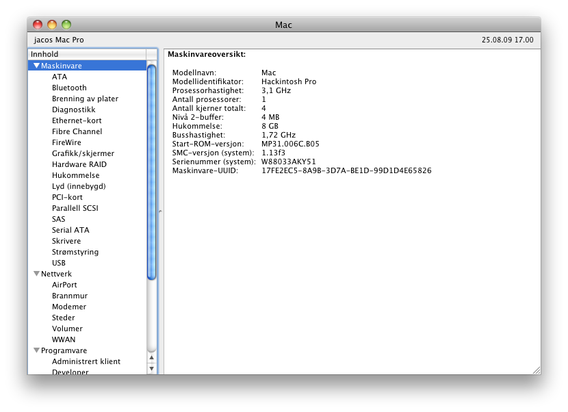

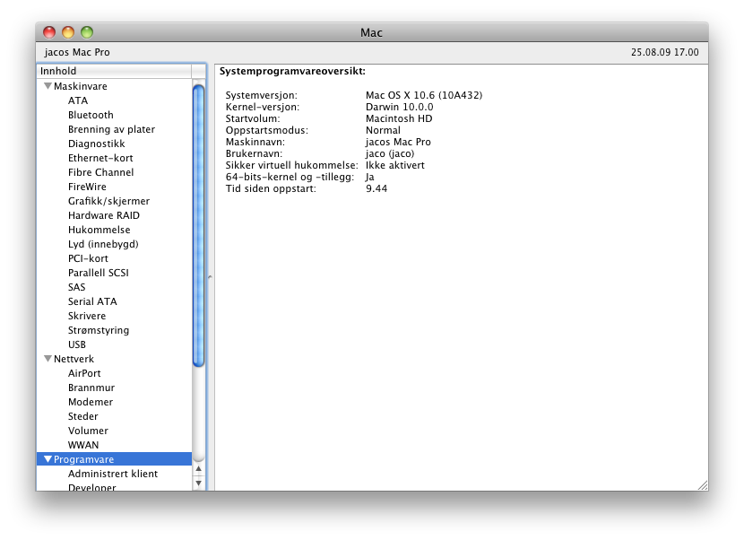

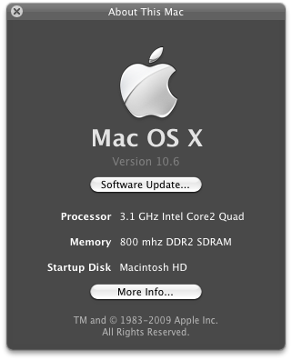

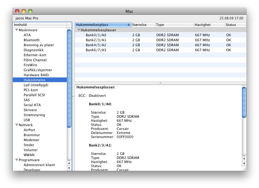

jacoweb Posted August 25, 2009 Share Posted August 25, 2009 Hi there! i have found a way to get a nice Snow Leopard 64bit on gigabyte EP-45 DS3 + Nvidia GeForce 8600 GT 256 mb.. (Sorry but my english is not so good) Files to download Here Install Snow Leopard @ Gigabyte EP-45 DS3. 1: Install Chameleon-2.0-r431.pkg 2: Copy boot file to your snow leopard volume. 3: Replace Extra folder to your snow leopard volume. 4: Edit your com.apple.Boot.plist Edit your UUID here.. you can find it out in disc stills.. <string>boot-uuid=xxx</string> Then add your EFI strings (if you have GeForce 8600 GT 256, don't remove anything) after this, go into extra folder, Extensions, rightclick on PlatformUUID.kext then show packages.. Then contents/info.plist Edit your info.plist file.. to the same UUID like post nor 4 over here.. Remember to boot system in -x after this boot your system, then run Kext Utility in your folder Fix Permission! Now are you able to boot SnowLeopard -------- Issues I dont use my soundcard here, cuz i have Apogee Duet Firewire card.. Soo, i have not tryed to onboard card.. Maybe it work with the kexts i have here I dont get sleep to work, i will update later when i fix it -------- Update!! I can use sleep function now.. but only when i use the power button to wake up from sleep. Install this kexts in /extra/ Folder, run disk Kext Utility.. reboot SleepEnabler.kext Link to comment https://www.insanelymac.com/forum/topic/181648-gigabyte-ep-45-ds3-install-working-kexts/ Share on other sites More sharing options...

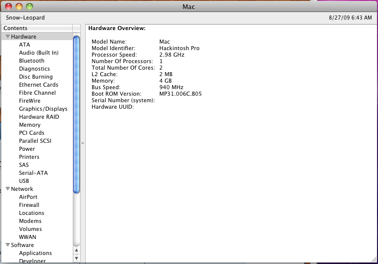

jacoweb Posted August 27, 2009 Author Share Posted August 27, 2009 3: Download the files from here.. http://www.speedyshare.com/data/691480739/...EP-45%20DS3.zip 4: Extra folder is in the files you downloaded now.. 5: com.apple.Boot.plist in Extra folder on your drive.. 6: Strings is ok? 7: Extra/Extensions/PlatformUUID.kext/ Right click on it, show package go to contents folder, edit info.plist ... Go to Disk utility in applications on your drive.. Right click on your boot volume, find information, find UUID (check the picture here) i think you understand the rest?? i will make a updated Guide later.. Link to comment https://www.insanelymac.com/forum/topic/181648-gigabyte-ep-45-ds3-install-working-kexts/#findComment-1237309 Share on other sites More sharing options...

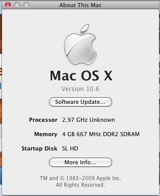

Uptown_J Posted August 27, 2009 Share Posted August 27, 2009 I just bought this board on Saturday. Thank you kjellamond and buji. I got it working following the steps from the buji but with the files from kjellamond. My CPU still shows up as unknown but that is the same from 10.5. It's the E5200 but I am cool with that. Also I find that forcing to 32bit kernel is much faster. It still runs all my 64 bit processes in 64 bit just fine, however the RAM footprint is much smaller and the OS is faster, boots faster, etc. I tried loading MS Office 2008 in 64bit mode and could not apply the patches for the service packs. Link to comment https://www.insanelymac.com/forum/topic/181648-gigabyte-ep-45-ds3-install-working-kexts/#findComment-1237657 Share on other sites More sharing options...
namakemono Posted August 27, 2009 Share Posted August 27, 2009 My CPU still shows up as unknown but that is the same from 10.5. It's the E5200 but I am cool with that. To change CPU type if not automatically detected do the following : In terminal type: “sysctl -n machdep.cpu.brand_string” The result i am presented with is : Intel® Core™2 Quad CPU Q9450 @ 2.66GHz Edit file : “/System/Library/CoreServices/Resources/English.lproj/AppleSystemInfo.strings“ Change the following line : “UnknownCPUKind” = “Unknown” to “UnknownCPUKind”= “Intel® Core™2 Quad CPU Q9450″ You do not have to restart to see the changes in effect, just close About This Mac and reopen and you will see the correct information. Cosmetics,cosmetics Link to comment https://www.insanelymac.com/forum/topic/181648-gigabyte-ep-45-ds3-install-working-kexts/#findComment-1237873 Share on other sites More sharing options...
Uptown_J Posted August 27, 2009 Share Posted August 27, 2009 To change CPU type if not automatically detected do the following : In terminal type: “sysctl -n machdep.cpu.brand_string” The result i am presented with is : Intel® Core™2 Quad CPU Q9450 @ 2.66GHz Edit file : “/System/Library/CoreServices/Resources/English.lproj/AppleSystemInfo.strings“ Change the following line : “UnknownCPUKind” = “Unknown” to “UnknownCPUKind”= “Intel® Core™2 Quad CPU Q9450″ You do not have to restart to see the changes in effect, just close About This Mac and reopen and you will see the correct information. Cosmetics,cosmetics You sir. Rock. That is exactly what I was looking for. UPDATE from earlier though. SleepEnabler did not work for my GA-EP45-UD3L. It just shuts the computer down. I wonder if there is a bios setting I must toggle. Prior to this motherboard, I had an ASUS P5KPL-CM (rest in peace). I finally got sleep working when I made some changes in the bios. Unfortunately the power zapped the board in a storm last weekend... I am still learning what the UD3L can do. I will keep reading the forums but if anyone can think of something please let me know. Link to comment https://www.insanelymac.com/forum/topic/181648-gigabyte-ep-45-ds3-install-working-kexts/#findComment-1238408 Share on other sites More sharing options...
