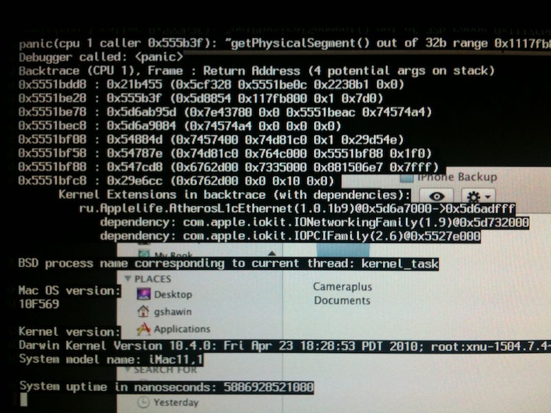

aduket Posted July 24, 2010 Share Posted July 24, 2010 Kernel Panic! I sometimes get 5 times a day following KernelPanic, what is the exact problem and solution for this? In the middle of development these kernel panics could be heart-breaking I urgently need help. Thanks for your effort. Panic (cpu 1 caller 0x555b3f): “getPhysicalSegment() out of 32b range 0x132521000, len 0x7d0, class IOBufferMemoryDescriptor “@/SourceCache/xnu/xnu-1504.7.4/iokit/Kernel/IO MemoryDescriptor.cpp:1597 Debugger called: <panic> Backtrace (CPU 0), Frame : Return Address (4 potential args on stack) 0x5531bdd8 : 0x21b455 (0x5cf328 0x5531be0c 0x2238b1 0x0) 0x5531be28 : 0x555b3f (0x5d8854 0x32521000 0x1 0x7d0) 0x5531be78 : 0x5b66c0e7 (0x816d680 0x0 0x5531beac 0x10a75d7f) 5 more similar addresses… Kernel Extensions in backtrace (with dependencies): ru.Applelife.AtherosL1cEthernet(1.01b9)@0x5b668000->0x5b66eff dependency: com.apple.iokit.IONetworkingFamily(1.9)@0x5b682000 dependency: com.apple.iokit.IOPCIFamily(2.6)@0x5511e000 BSD process name corresponding to current thread: kernel_task Mac OS version: 10F569 Kernel version: Darwin Kernel Version 10.4.0: Fri Apr 23 18:28:53 PDT 2010; root:xnu-1504.7.4~1/RELEASE_I386 System model name: MacBookPro4,1 (Mac-FD2D89C8) System uptime in nanoseconds: 30628841988707 Ps: I installed the correct Atheros kext, I don't think this panic is stemming from mismatching of kext with my hardware. But something seems to be amiss. I am all ears now. Link to comment https://www.insanelymac.com/forum/topic/181343-atheros-ar8131ar8132/page/11/#findComment-1517560 Share on other sites More sharing options...
zcream Posted July 26, 2010 Share Posted July 26, 2010 I get the same problem with this kext on a ES2L v2 board. Always this same kext. Its a shame. Kernel Panic! I sometimes get 5 times a day following KernelPanic, what is the exact problem and solution for this? In the middle of development these kernel panics could be heart-breaking I urgently need help. Thanks for your effort.Panic (cpu 1 caller 0x555b3f): “getPhysicalSegment() out of 32b range 0x132521000, len 0x7d0, class IOBufferMemoryDescriptor “@/SourceCache/xnu/xnu-1504.7.4/iokit/Kernel/IO MemoryDescriptor.cpp:1597 Debugger called: <panic> Backtrace (CPU 0), Frame : Return Address (4 potential args on stack) 0x5531bdd8 : 0x21b455 (0x5cf328 0x5531be0c 0x2238b1 0x0) 0x5531be28 : 0x555b3f (0x5d8854 0x32521000 0x1 0x7d0) 0x5531be78 : 0x5b66c0e7 (0x816d680 0x0 0x5531beac 0x10a75d7f) 5 more similar addresses… Kernel Extensions in backtrace (with dependencies): ru.Applelife.AtherosL1cEthernet(1.01b9)@0x5b668000->0x5b66eff dependency: com.apple.iokit.IONetworkingFamily(1.9)@0x5b682000 dependency: com.apple.iokit.IOPCIFamily(2.6)@0x5511e000 BSD process name corresponding to current thread: kernel_task Mac OS version: 10F569 Kernel version: Darwin Kernel Version 10.4.0: Fri Apr 23 18:28:53 PDT 2010; root:xnu-1504.7.4~1/RELEASE_I386 System model name: MacBookPro4,1 (Mac-FD2D89C8) System uptime in nanoseconds: 30628841988707 Ps: I installed the correct Atheros kext, I don't think this panic is stemming from mismatching of kext with my hardware. But something seems to be amiss. I am all ears now. Link to comment https://www.insanelymac.com/forum/topic/181343-atheros-ar8131ar8132/page/11/#findComment-1518848 Share on other sites More sharing options...
SolidXnake Posted July 26, 2010 Share Posted July 26, 2010 I get the same problem with this kext on a ES2L v2 board. Always this same kext. Its a shame. Always check the kext dependencies using the kext update tool on a terminal. com.apple.iokit.IONetworkingFamily.kext is the culprit here. Not necessarily the Atheros is the issue - Link to comment https://www.insanelymac.com/forum/topic/181343-atheros-ar8131ar8132/page/11/#findComment-1518950 Share on other sites More sharing options...
zcream Posted July 26, 2010 Share Posted July 26, 2010 In that case, is there a version of IONetworkingFamily that actually works ? Or should I just delete the IONetworkingFamily kext - not sure if that works since its a dependency ? Always check the kext dependencies using the kext update tool on a terminal. com.apple.iokit.IONetworkingFamily.kext is the culprit here. Not necessarily the Atheros is the issue - Link to comment https://www.insanelymac.com/forum/topic/181343-atheros-ar8131ar8132/page/11/#findComment-1519009 Share on other sites More sharing options...

aduket Posted July 28, 2010 Share Posted July 28, 2010 Always check the kext dependencies using the kext update tool on a terminal. com.apple.iokit.IONetworkingFamily.kext is the culprit here. Not necessarily the Atheros is the issue - I have checked the dependencies in /system/library/extensions/ folder by querying it : kextlibs AtherosL1cEthernet.kext For all architectures: com.apple.iokit.IONetworkingFamily = 1.9 com.apple.iokit.IOPCIFamily = 2.6 com.apple.kpi.bsd = 10.4 com.apple.kpi.iokit = 10.4 com.apple.kpi.libkern = 10.4 For i386: 1 symbol not found in any library kext. and what do all these convey? What are we supposed to do next? Link to comment https://www.insanelymac.com/forum/topic/181343-atheros-ar8131ar8132/page/11/#findComment-1520221 Share on other sites More sharing options...

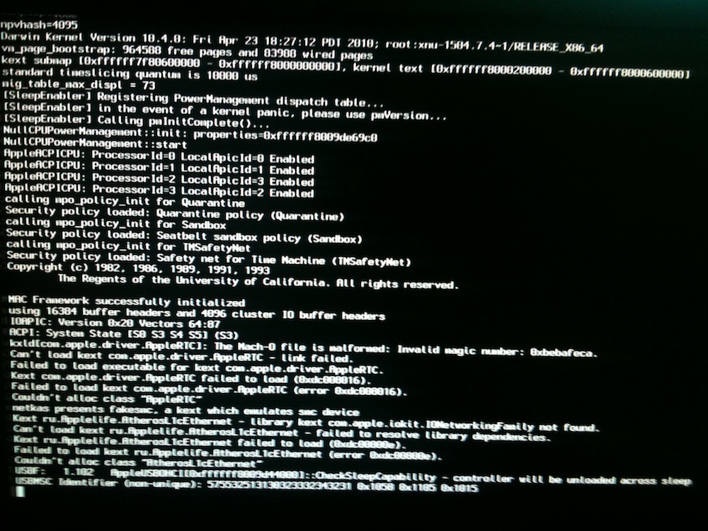

beatoven Posted September 14, 2010 Share Posted September 14, 2010 Hi there. I am using Reader02's AtherosL1c kext on a G31M-ES2L Rev2.3 motherboard and I randomly get a kernel panic. The panic message mentions AtherosL1cEthernet and dependencies to IONetworking and IOPCI families. I saw that a few of you above got the same problem but none of them has found a solution. I'm attaching a photo of the kernel panic screen. Can any of you help with that, please? Thanks a lot. Link to comment https://www.insanelymac.com/forum/topic/181343-atheros-ar8131ar8132/page/11/#findComment-1548138 Share on other sites More sharing options...
thecandle Posted September 28, 2010 Share Posted September 28, 2010 I have the same random kernel panic with the L1c driver too. Unless you can show some proof, its just plain FUD to say its the IONetworkingFamily kext. I'm running the stock version from Apple and it is the dependency for almost every network kext. So if it was the culprit there would be a lot more kernel panics from other network cards. Personally I think the current L1c extension is bugged. I'll peak into the source and see if I can't bring it up to speed with a more recent *nix release. Link to comment https://www.insanelymac.com/forum/topic/181343-atheros-ar8131ar8132/page/11/#findComment-1555941 Share on other sites More sharing options...
beatoven Posted September 30, 2010 Share Posted September 30, 2010 I have the same random kernel panic with the L1c driver too. Unless you can show some proof, its just plain FUD to say its the IONetworkingFamily kext. I'm running the stock version from Apple and it is the dependency for almost every network kext. So if it was the culprit there would be a lot more kernel panics from other network cards. Personally I think the current L1c extension is bugged. I'll peak into the source and see if I can't bring it up to speed with a more recent *nix release. I can't show you proof. I'm pretty sure it's the L1c extension as well. I kinda gave up and ordered a miniPCI airport card and an adapter. I'll be really thankful if you could fix it though. Thanks. Link to comment https://www.insanelymac.com/forum/topic/181343-atheros-ar8131ar8132/page/11/#findComment-1556972 Share on other sites More sharing options...
thecandle Posted October 1, 2010 Share Posted October 1, 2010 Ok. I might have found the culprit in the L1c extension. There appears to be a buffer overflow issue that is still occurring. A memset call seems to be overriding more memory than allocated. The issue manifests itself when you reach the end of the allocated blocks. I have increased the allocation to see if that patches the issue. Its a rough fix but if it works I'll follow up with an attachment. ----- EDIT: I found the cause of the buffer issue. It seems to be an issue with the generic allocation call the is alloc a buffer that goes past the 32-bit address limit. The darwin kernel needs to keep the buffer within 32-bit address space. I'm rewriting the code to use the proper call to ensure the extension keeps all allocation under 32-bits. Quick hack should be done tonight. A good fix would take some time. I'm still puzzled why there is constant alloc of rx buffers on-the-fly when a set matching the max packet and total ring size is not prealloc. The hack will have an issue in 64bit that when memory is filled near 4GB or more the network will stop functioning-- we won't be able to alloc any more buffers under 32bit. So be aware that heavy memory usage on system with more than 4GB will kill your net connection. Mini-survey. Everyone that has had the panic-- are you running the kernel in 64bit?* *In case you're technically savvy universal 32/64bit mode since only servers should be running pure 64 ----- EDIT: Added patched source and compiled (10.6) binary AtherosL1cEthernet.kext.zip AtherosL1cEthernet_src.zip Link to comment https://www.insanelymac.com/forum/topic/181343-atheros-ar8131ar8132/page/11/#findComment-1557436 Share on other sites More sharing options...
beatoven Posted October 1, 2010 Share Posted October 1, 2010 Thanks a lot. I'm not running the kernel in 64-bit. When I try that, the network connection doesn't work. I'll try your fixed one. On a side note, I didn't understand your explanation coz I know nothing about programming. Link to comment https://www.insanelymac.com/forum/topic/181343-atheros-ar8131ar8132/page/11/#findComment-1557686 Share on other sites More sharing options...
thecandle Posted October 1, 2010 Share Posted October 1, 2010 @beatover: I didn't think this would be an issue in 32. Let me know if it still crashes. I added a fix for a PM issue-- NIC going offline after sleep and NIC not detecting cable if unplugged during sleep. I think its the same issue. This new build should fix that. ----- EDIT: After a little more testing. I don't think some of the sleep issue can be fixed. Its likely a platform or sleep enabler (for some user) issue. The routine to disable the NIC is not being called thus it can never be brought back up on wake. I think the system maybe going into sleep before the chain of registered callbacks are complete. It may be possible to create a userspace daemon to kill the NIC prior to sleep so it will always come back up. But I'm not going to work on this unless there's real demand. AtherosL1cEthernet.kext.zip AtherosL1cEthernet_src.zip Link to comment https://www.insanelymac.com/forum/topic/181343-atheros-ar8131ar8132/page/11/#findComment-1557832 Share on other sites More sharing options...
beatoven Posted October 2, 2010 Share Posted October 2, 2010 I have an issue with iousbfamily.kext when I try to boot in 64-bit. Using the 10.6.2 one lets me boot but doesn't eject my USB hard disks correctly upon sleep. A patched one I found fixes that but gives me infinite loading at boot for x64 kernel. I'll put the fixed one back to try your kext in x64 though. Is the sleep issue you're mentioning the reason why I can't find anything over bonjour after a sleep? Thanks again. Haven't had a crash with your kext yet in 32bit but since it's normally a random crash, I'll have to wait and see. [edit] Okay I tried booting with arch=x86_64 and I get the attached panic. See the picture. Sorry about the pics but I don't know how to get the logs. The folder for the logs doesn't exist. Link to comment https://www.insanelymac.com/forum/topic/181343-atheros-ar8131ar8132/page/11/#findComment-1557931 Share on other sites More sharing options...
thecandle Posted October 2, 2010 Share Posted October 2, 2010 Is the sleep issue you're mentioning the reason why I can't find anything over bonjour after a sleep? The network sleep issue affects everything-- web, email, etc. It basically kills your net connection. If its only bonjour its probably a different issue. Link to comment https://www.insanelymac.com/forum/topic/181343-atheros-ar8131ar8132/page/11/#findComment-1557935 Share on other sites More sharing options...
beatoven Posted October 2, 2010 Share Posted October 2, 2010 Ye it's only bonjour + the ability to find/connect to my airport express. Thanks. Check my previous post edit and see if you understand the panic I got with your latest kext mod booting in x64. I don't really need x64 myself, except when I do 3D with Maya. Don't worry about it if it's lots of work to fix. Cheers. Link to comment https://www.insanelymac.com/forum/topic/181343-atheros-ar8131ar8132/page/11/#findComment-1557936 Share on other sites More sharing options...
