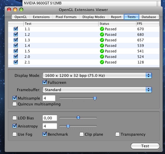

mitch_de Posted July 21, 2009 Share Posted July 21, 2009 will wait for other users reporting on this. i will then get card.any screenshots, geekbench urls xbench will be nice . netcas team is really great. The .kext also works for NV cards (even the name looks more ati). I would really wait for comments. Also if you plan to switch very early to Snow Leopard the buy of that card will be good planed. For my knowledge the ATI driversets are much more complex than NVIDIA, so non Mac cards are more difiicult to get fixed. The SL ATI driverset is even more comlplex and much new. I switched from 3850 to 9600GT after reading lots of 4850 probs and also had some nightmare to get my ATI 3850 to run. SL runs perfect - since now no chance for ATI 38XX. For compare of GPUs OpenGL Extensions Viewer is an good bench - forget Xbench OpenGL!!(very, very old OpenGL features, much to little test window, much to less GPU stress = more an CPU test than GPU). http://www.realtech-vr.com/glview/download.html To get an more GPU denpendend Benchmark (not so much cpu depenend) set: - Fullscreen (32 Bit, at least 1440x900) - FSAA * 4 (not > 4 because NVIDIAs cant do more than *4 in OS X) - GPU has much more to work - Benchmark - anitrosphie * 4 With that Bench(and that settings) you will see much more (less cpu independend) GPU speed differences than for example old XBench. Here my 1600x1200 NV 9600GT values (30% faster than my 3850) - sure slower than 4850. If i had a bit more money i had taken an NV 260 insted of 9600GT The best deal would be an ATI 4770 (fast as 4850 but much less power consumtion) - not working for my knowledge until now. Link to comment https://www.insanelymac.com/forum/topic/175845-ati-hd-4850-the-golden-kext-netkas/#findComment-1205718 Share on other sites More sharing options...
