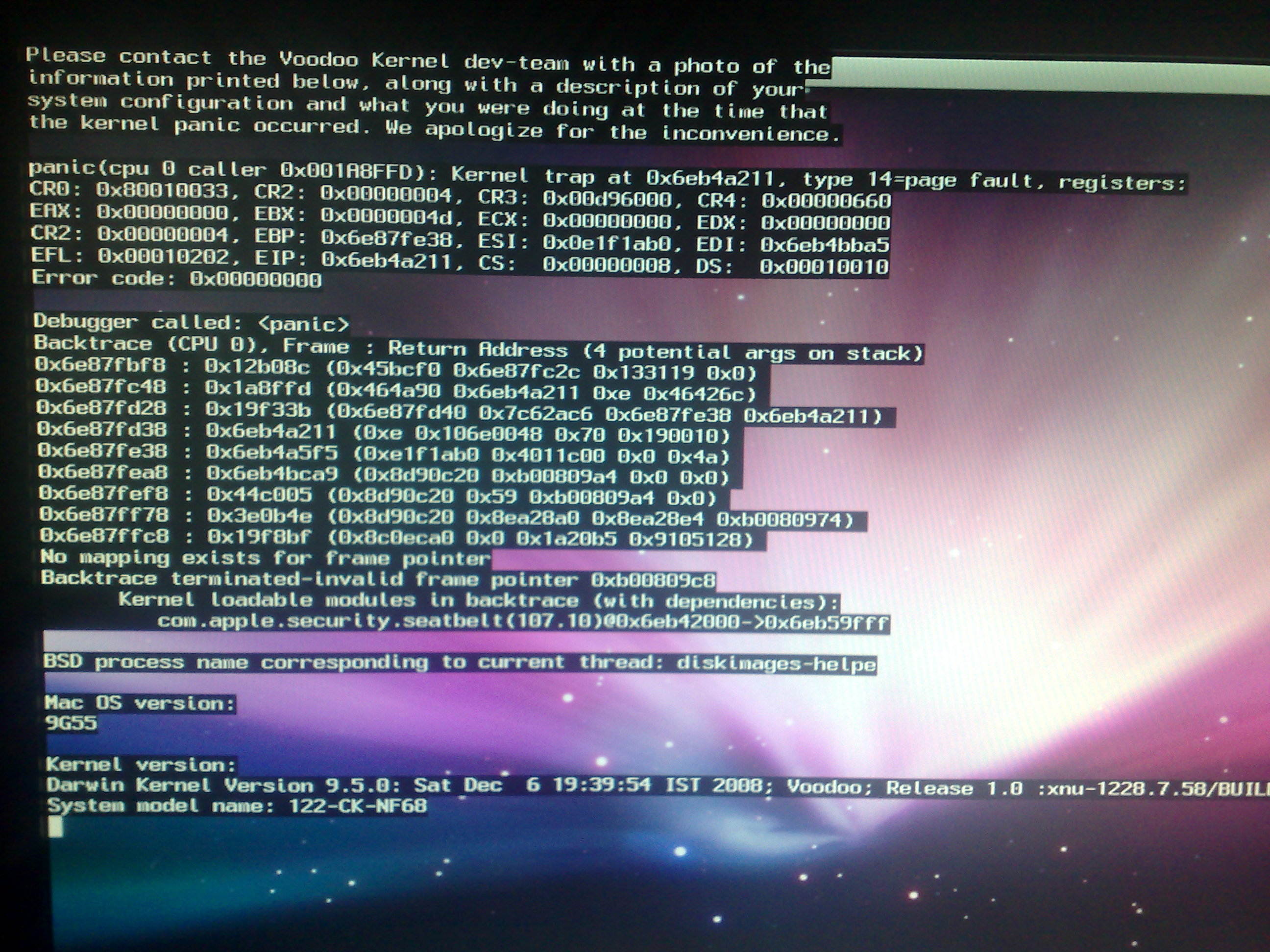

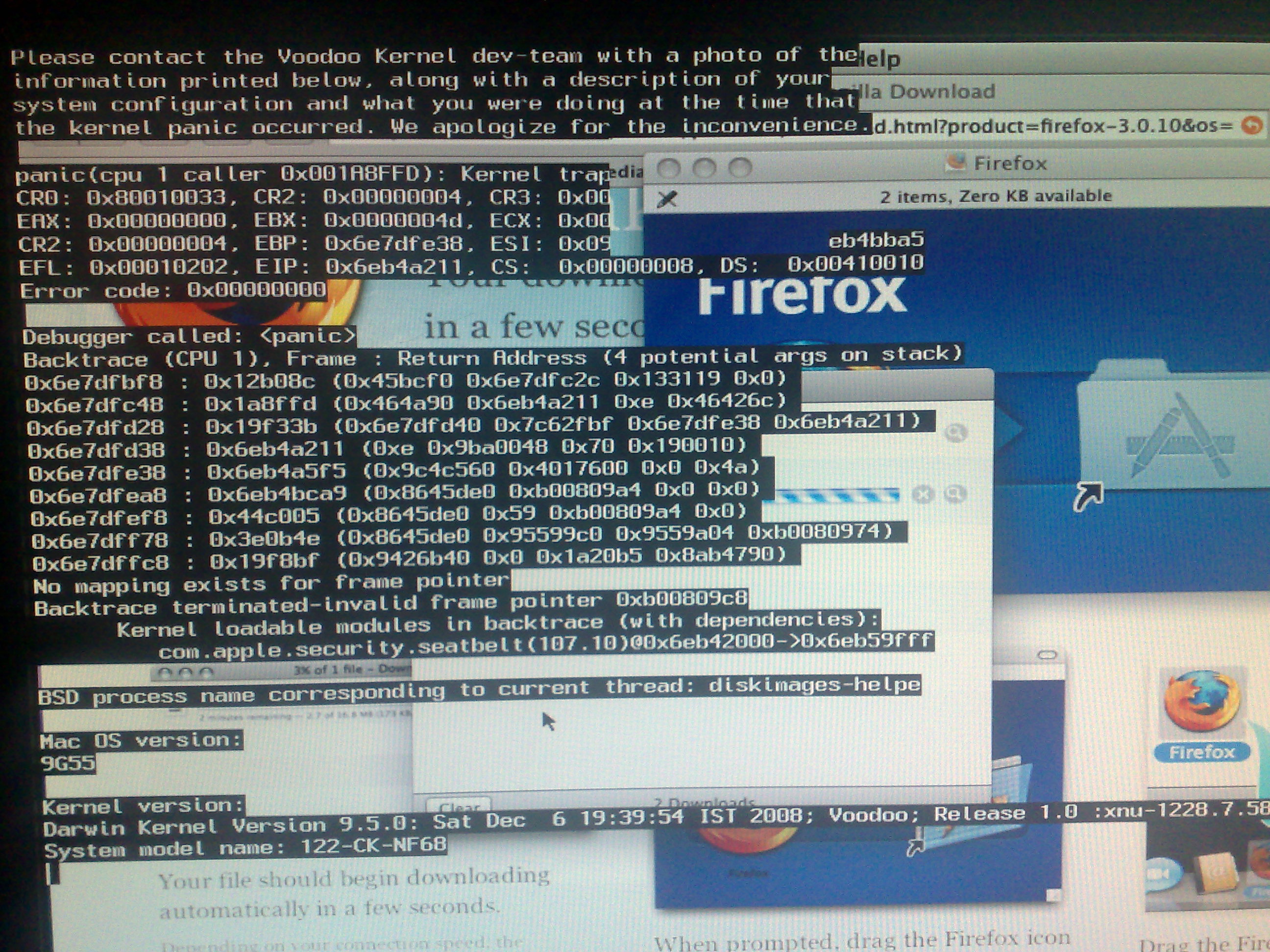

voteneg Posted June 9, 2009 Author Share Posted June 9, 2009 Ok folks, thanks for the help so far. I'm in osx and that a big first step. This is my next problem, video drivers. It only allows me to be in 1024x768. I am also having some sort of kernel panic, here's two screenshots. These both happened when I was trying to download something from the internet. Link to comment https://www.insanelymac.com/forum/topic/169922-successful-installation-failed-to-boot/#findComment-1173663 Share on other sites More sharing options...

Gujal Posted June 10, 2009 Share Posted June 10, 2009 Your crashes are related to you downloading dmg files in Safari. As soon as the dmg file is downloaded, Safari tries to mount it and it will crash because of you using Voodoo kernel. Because voodoo kernel is version 9.5.0, you must use seatbelt.kext version 9.5.0 and system.kext version 9.5.0 This is called "seatbelt fix" in the install dvd However as your CPU is Intel Core2, it should work with Apple Kernel, and the voodoo kernel might not be required. If you stick to Apple kernel, you can use the latest patch 10.5.7 which has version 9.7.0 of kernel, seatbelt and system Also for the display to get proper resolution, get rid of NVInject, get the latest OSX86tools and select the EFI Display string for NVidia 8800GT 512 MB. My XFX 8800GT Alpha Dog 512MB works perfect with the EFI String included in OSX86Tools Link to comment https://www.insanelymac.com/forum/topic/169922-successful-installation-failed-to-boot/#findComment-1173699 Share on other sites More sharing options...
