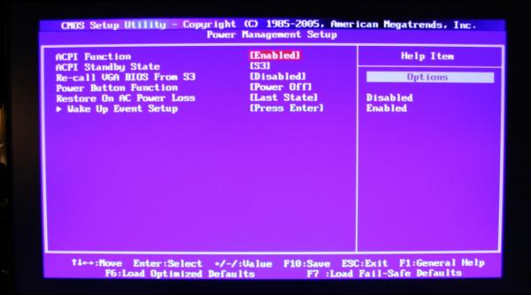

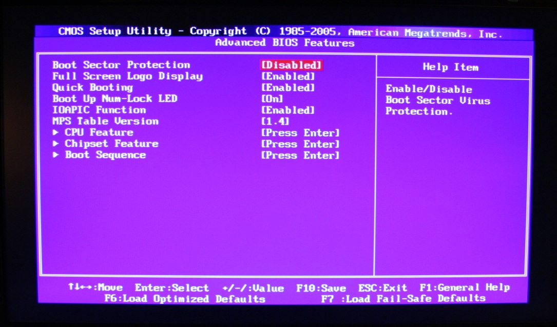

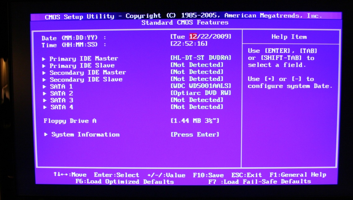

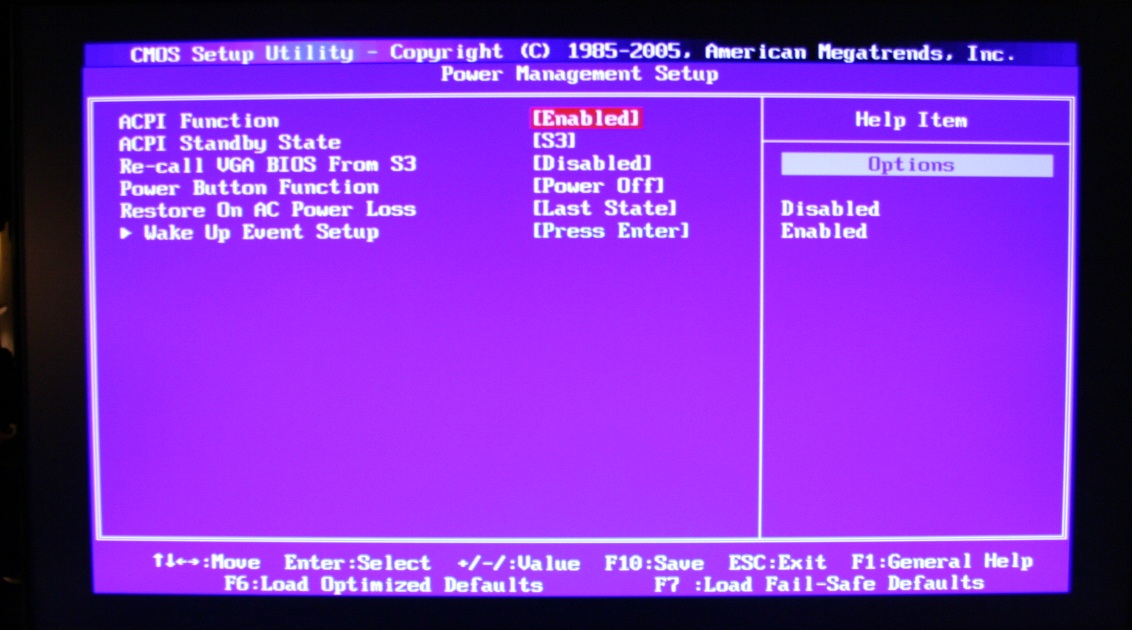

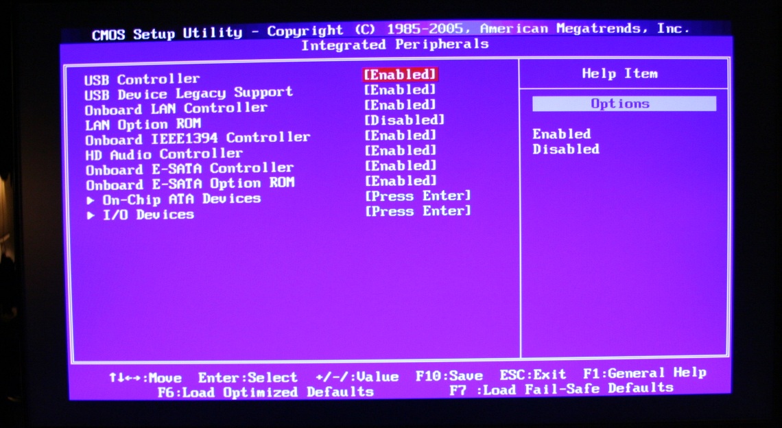

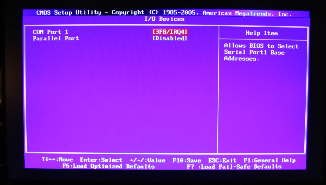

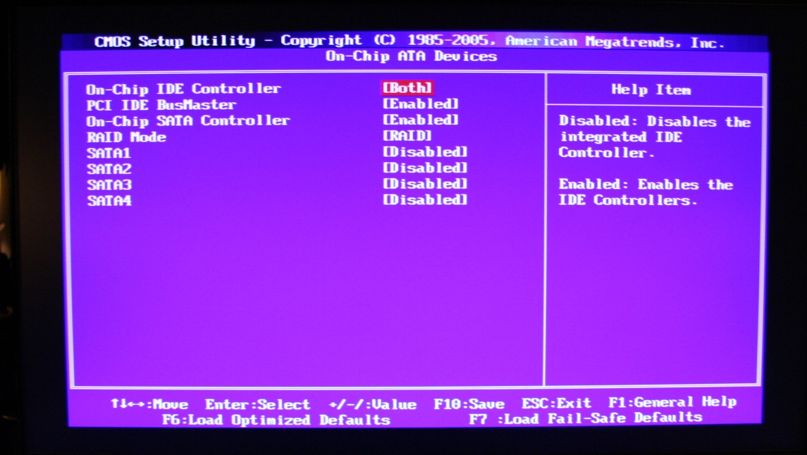

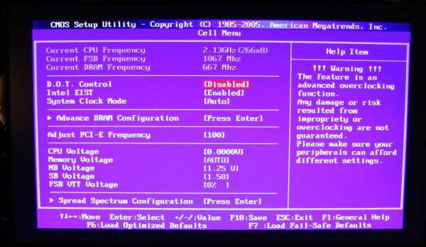

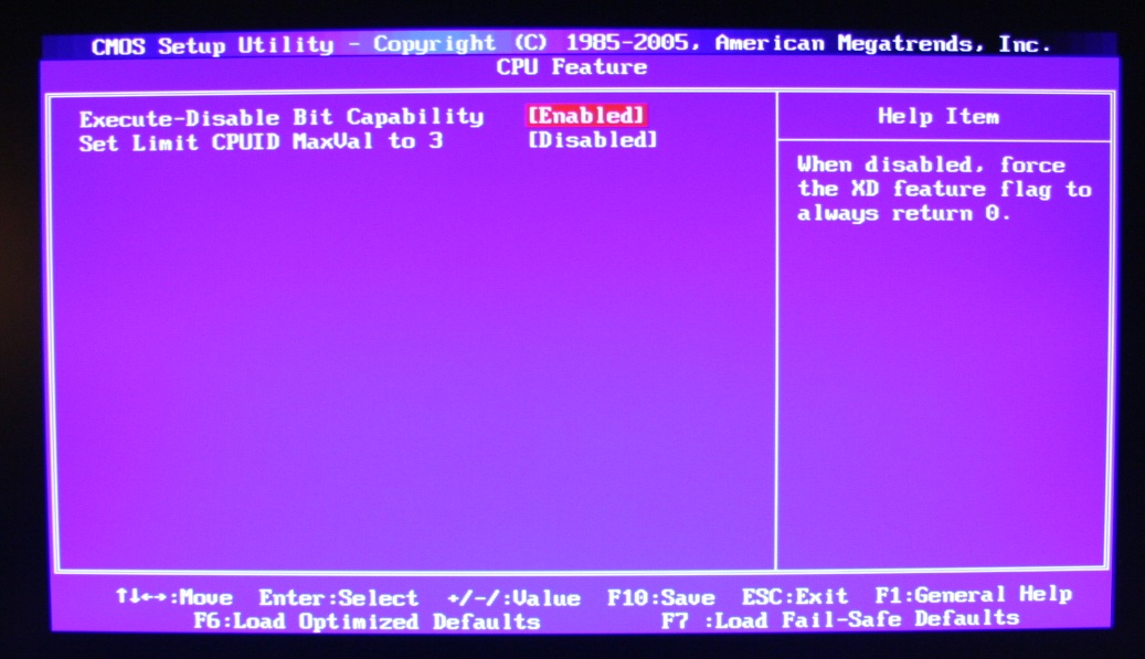

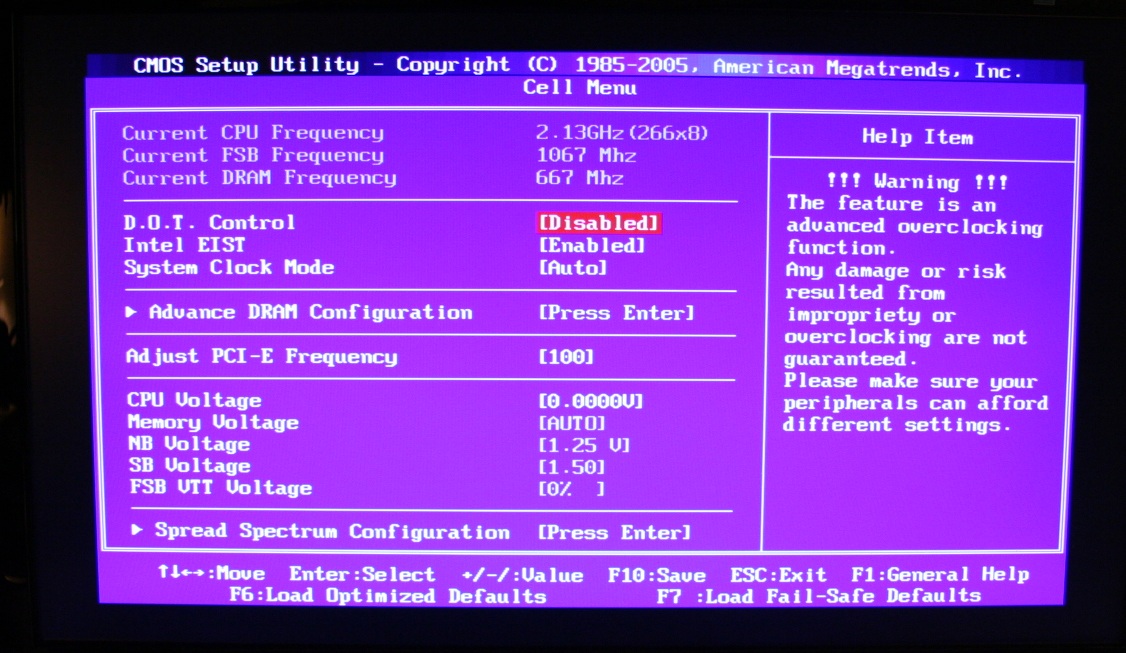

MrSlave Posted December 23, 2009 Share Posted December 23, 2009 OK Ahh I completely forgot to upload them, sorry to leave you hanging like that. Here are the photos. Additionally, HPET is enabled. Thanks again for the help. Link to comment https://www.insanelymac.com/forum/topic/167180-leopard-on-pre-series-7-nvidia-nforce-mcp-intel-cpu-mobos-reborn/page/15/#findComment-1367023 Share on other sites More sharing options...
verdant Posted December 24, 2009 Author Share Posted December 24, 2009 Ahh I completely forgot to upload them, sorry to leave you hanging like that. Here are the photos. Additionally, HPET is enabled. Thanks again for the help. Set RAID mode to AHCI if that is an option.....otherwise try with Intel EIST, IDE Bus Master, Restore on AC Power Loss, E-SATA set to [Disabled] in turn.... Link to comment https://www.insanelymac.com/forum/topic/167180-leopard-on-pre-series-7-nvidia-nforce-mcp-intel-cpu-mobos-reborn/page/15/#findComment-1367708 Share on other sites More sharing options...
MrSlave Posted December 24, 2009 Share Posted December 24, 2009 Set RAID mode to AHCI if that is an option.....otherwise try with Intel EIST, IDE Bus Master, Restore on AC Power Loss, E-SATA set to [Disabled] in turn.... No luck there, I still get the "Still waiting for root device" line and prior to that a line to the effect of "Searching for device d0s3" Link to comment https://www.insanelymac.com/forum/topic/167180-leopard-on-pre-series-7-nvidia-nforce-mcp-intel-cpu-mobos-reborn/page/15/#findComment-1368345 Share on other sites More sharing options...
verdant Posted December 25, 2009 Author Share Posted December 25, 2009 No luck there, I still get the "Still waiting for root device" line and prior to that a line to the effect of "Searching for device d0s3" Try with Firewire (IEEE1394a) disabled in BIOS.......also, I presume you have installed OS X to a primary partition....... Link to comment https://www.insanelymac.com/forum/topic/167180-leopard-on-pre-series-7-nvidia-nforce-mcp-intel-cpu-mobos-reborn/page/15/#findComment-1368442 Share on other sites More sharing options...
MrSlave Posted December 25, 2009 Share Posted December 25, 2009 Try with Firewire (IEEE1394a) disabled in BIOS.......also, I presume you have installed OS X to a primary partition....... I haven't been able to boot into an installer yet. This error blocks me every time but d0s3 points toward a primary/active partition. Link to comment https://www.insanelymac.com/forum/topic/167180-leopard-on-pre-series-7-nvidia-nforce-mcp-intel-cpu-mobos-reborn/page/15/#findComment-1368587 Share on other sites More sharing options...
verdant Posted December 25, 2009 Author Share Posted December 25, 2009 I haven't been able to boot into an installer yet. This error blocks me every time but d0s3 points toward a primary/active partition. In that case, disconnect the SATA DVDRW and connect the SATA HDD on SATA 1 and use the IDE DVDRW as Master.......then see if you can boot into the installer on the DVD distro....... Link to comment https://www.insanelymac.com/forum/topic/167180-leopard-on-pre-series-7-nvidia-nforce-mcp-intel-cpu-mobos-reborn/page/15/#findComment-1368729 Share on other sites More sharing options...
