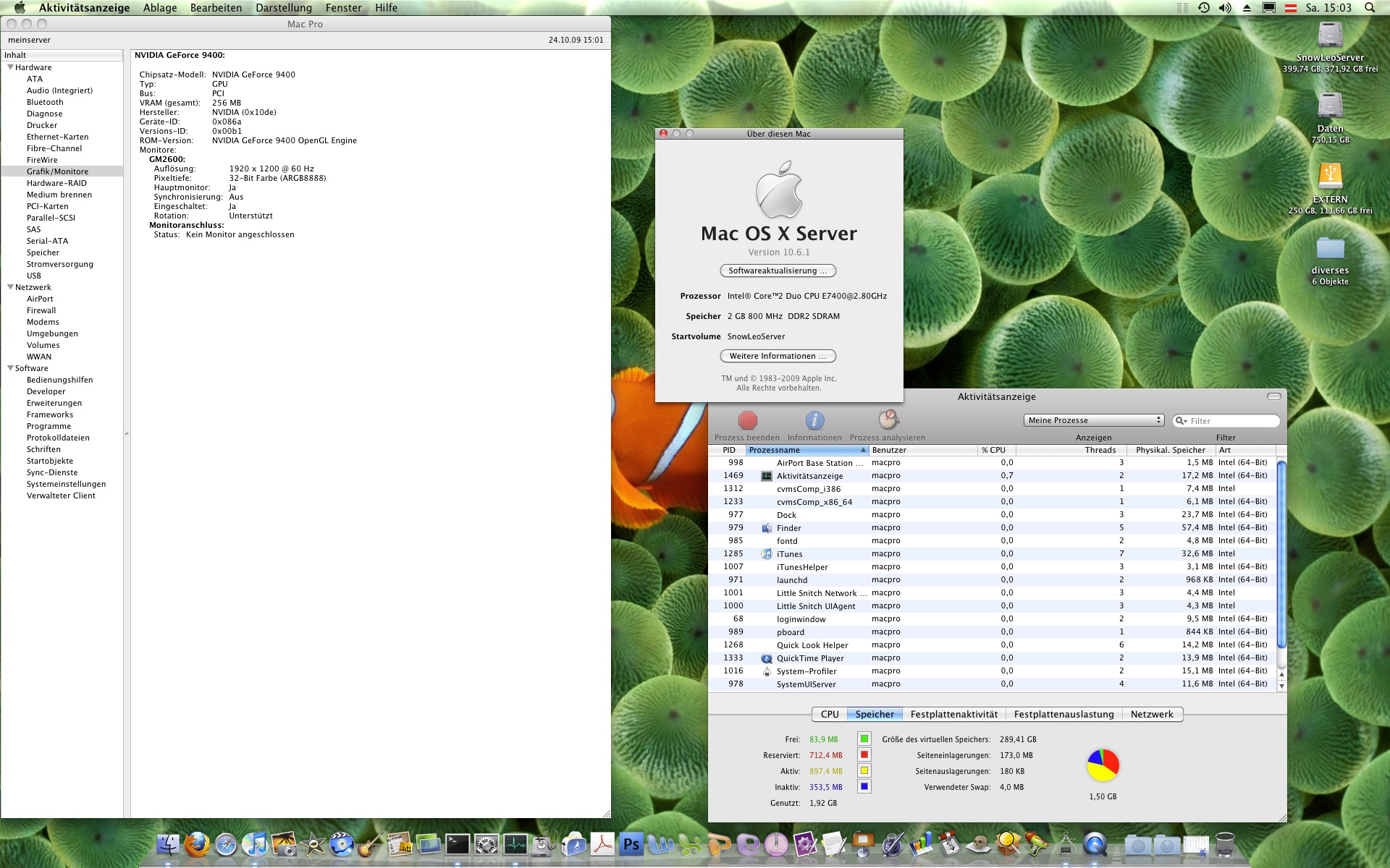

me@home Posted October 24, 2009 Share Posted October 24, 2009 Hello, 1st - THANK you all for the kext, bios, guide here ! 2nd - got my HD with 10.6.1 Server working on the GA-E7AUM-DS2H, C2D 7400, 4x2GB, onboard NV9400: * ONLY boots up when using 1x2GB Ram ! Have bios 3fa (x) installed. * Sound is working (I use analog 2 channel) * LAN = OK Is there "hope" to get more RAM working on this mobo ? I have Win7 64bit which shows me all 8GB - have not tried to test if it's mem test stable. How to tell max mem = 2GB ? So I can let the 4x2Gb Ram in the mobo (for W7). Link to comment https://www.insanelymac.com/forum/topic/161348-guide-installing-snow-leopardleopard-retail-dvd-on-the-ga-e7aum-ds2h/page/8/#findComment-1308856 Share on other sites More sharing options...

rbonon Posted October 24, 2009 Share Posted October 24, 2009 Hello, How to tell max mem = 2GB ? So I can let the 4x2Gb Ram in the mobo (for W7). As of now, AFAIK, the only way to work around the 2Gb limitation is to use an add-on graphics card. If you are using the On-board graphics, you must not have more than 2Gb. This is something dlach is trying to correct, but I have little hope, as we depend on Gigabyte to fix/adapt stuff on the BIOS, and we are a small group of people, and the motherboard is getting more and more legacy, so we will get less and less attention from Gigabyte. @rbononOh, i´ve posted the wrong "screenshot". I am running everything on SATA and AHCI. For now I used a workaround. I´ve started my USB Stick with Rebel EFI Bootloader and then I was able to install SL. Unfortunately I´ve never worked with Terminal before. Is there another possibility to edit the files? Or could you maby give me a step by step instruction what I have to do? So basically your problem is that the USB you prepared following my instructions is not booting, right? Things to check: - Did you set your BIOS to allow USB stick to be boot first than the HD? (sorry but sometimes people forget this)? - Did you partition your USB stick using MBR (under options)? You can try a simple check. Take another USB stick, may be a small one. Partition it as MBR with one single partition, and restore the Boot.iso to it. That would be the simplest of the cases. You would have a bootable USB stick. It should boot OK. Make the checks and let us know. Regards Link to comment https://www.insanelymac.com/forum/topic/161348-guide-installing-snow-leopardleopard-retail-dvd-on-the-ga-e7aum-ds2h/page/8/#findComment-1309000 Share on other sites More sharing options...

dlach Posted October 24, 2009 Author Share Posted October 24, 2009 Hello, 1st - THANK you all for the kext, bios, guide here ! 2nd - got my HD with 10.6.1 Server working on the GA-E7AUM-DS2H, C2D 7400, 4x2GB, onboard NV9400: * ONLY boots up when using 1x2GB Ram ! Have bios 3fa (x) installed. * Sound is working (I use analog 2 channel) * LAN = OK Is there "hope" to get more RAM working on this mobo ? I have Win7 64bit which shows me all 8GB - have not tried to test if it's mem test stable. How to tell max mem = 2GB ? So I can let the 4x2Gb Ram in the mobo (for W7). That depends on how hopeful a person you are. Sometimes I feel we are very close to understanding the problem and resolving it. Other times it feels far away. I wish I could offer more. Link to comment https://www.insanelymac.com/forum/topic/161348-guide-installing-snow-leopardleopard-retail-dvd-on-the-ga-e7aum-ds2h/page/8/#findComment-1309076 Share on other sites More sharing options...

me@home Posted October 24, 2009 Share Posted October 24, 2009 That depends on how hopeful a person you are.... Thanks for your reply... Well I'm hoping but it's not urgent for me cause I have a working 10.6 with 8GB Ram - my DS4 (really easy mobo for all Leopard, SL installs !). I've had problems with "faulty" bios over my hackingtosh years on laptops (i.e. only 1 core using) and sometimes there was a work around and sometimes there wasn't. So I did upgrade from time to time. Link to comment https://www.insanelymac.com/forum/topic/161348-guide-installing-snow-leopardleopard-retail-dvd-on-the-ga-e7aum-ds2h/page/8/#findComment-1309208 Share on other sites More sharing options...
