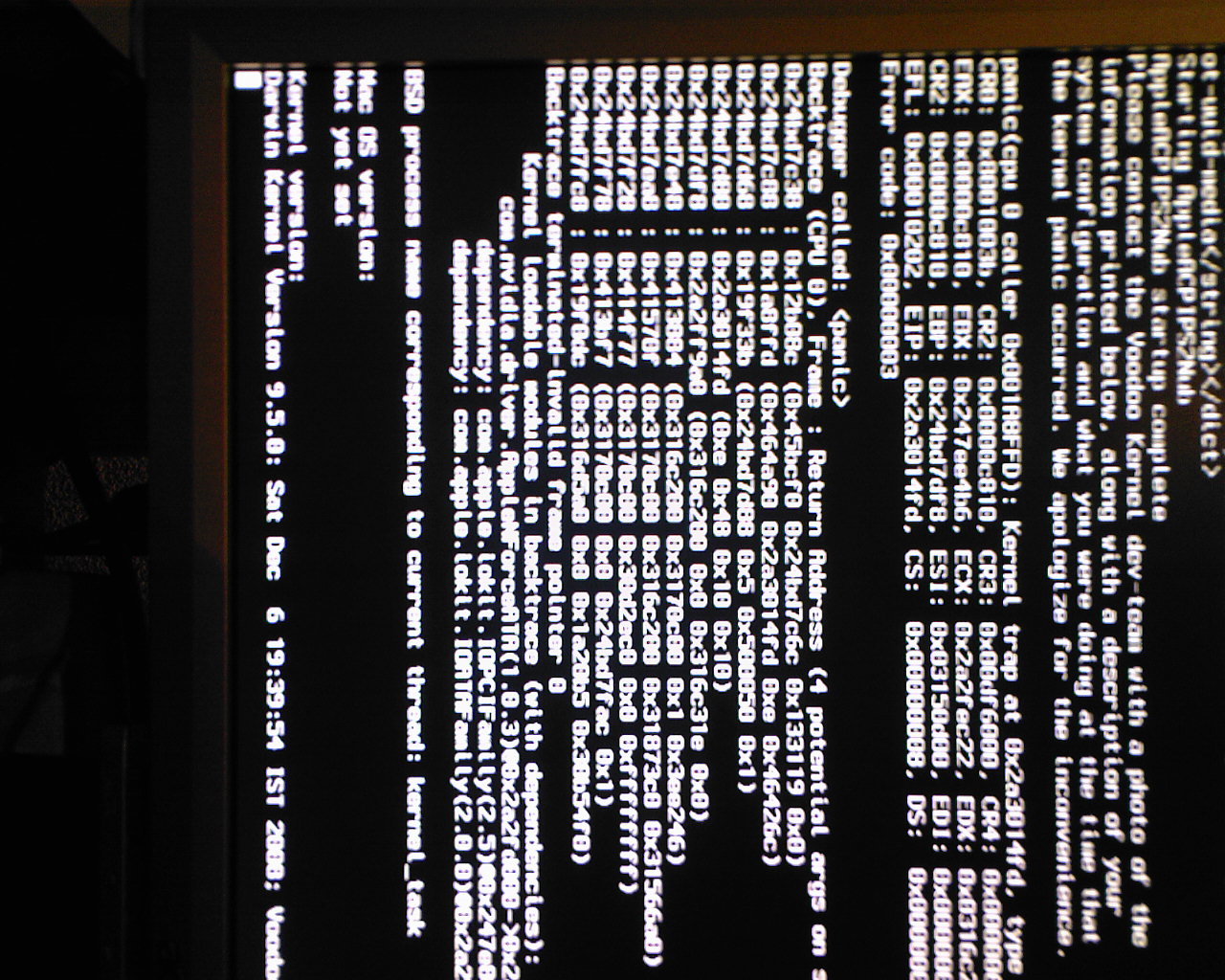

Am also unable to boot to Kalyway's 10.5.2
Machine Specs:
MOBO - Intel DG33FB, Intel Core 2 Duo, 3GB RAM, Gigabyte 9400GT Graphics Card
Enabled AHCI for my MOBO through bios settings.........
The startup hangs at file system mount.........screenie attached
Thanks in advance! :(
Always boot with -v until you get your machine up and running where you want it. You may also want to give -x a try. This will boot you into Safe Mode loading only necessary kexts. Similar to Safe Mode in Windows

Back again and with a surprise: A Kernel Panic. If i'm right it's because of the com.nvidia.driver.applenforceATA thingy.
How can i fix this? Reinstall? :) or just fix the kext without reinstall :D .
Please let me know if i'm right and if i'm not please tell me what it is then and how to fix it, i would be very happy :D .

If you have more than 2GB of RAM, try booting with maxmem=2048
Make sure S-ATA is set to AHCI in the BIOS.
Good nForce information in this thread:
http://www.insanelymac.com/forum/index.php?showtopic=132462
Hi, i tried to set S-ATA to AHCI but i can't find it. I googled a bit and still cound't find anything.
And i have like 1,5GB ram, i still tried the maxmem=2048 for sure but didn't help ;) .
And i have like 1,5GB ram, i still tried the maxmem=2048 for sure but didn't help :) .
Yeah if you have 1.5GB ram you dont need to try maxmem. Somewhere around 3.2GB or greater you may experience system freezes due to 32bit addressing in your ATA kext. Using maxmem would be a way to check and see if that was the root of your problem. maxmem=2048 will limit OSX to 2GB of Ram. There are also some community modified 64bit kexts that work pretty good. Just keep that in mind if you ever add more memory.
*Which options did you use for your chipset during install? You didnt install more than one nForce option did you?
Here is a link to your mobo's user manual: http://america.giga-byte.com/FileList/Manu...nual_k8ns_e.pdf I did not see an option for AHCI, some mobo's do not have this option.
No i only used 1 kext the one that you have in your signature. How can i fix it, reinstall and try another kext?
