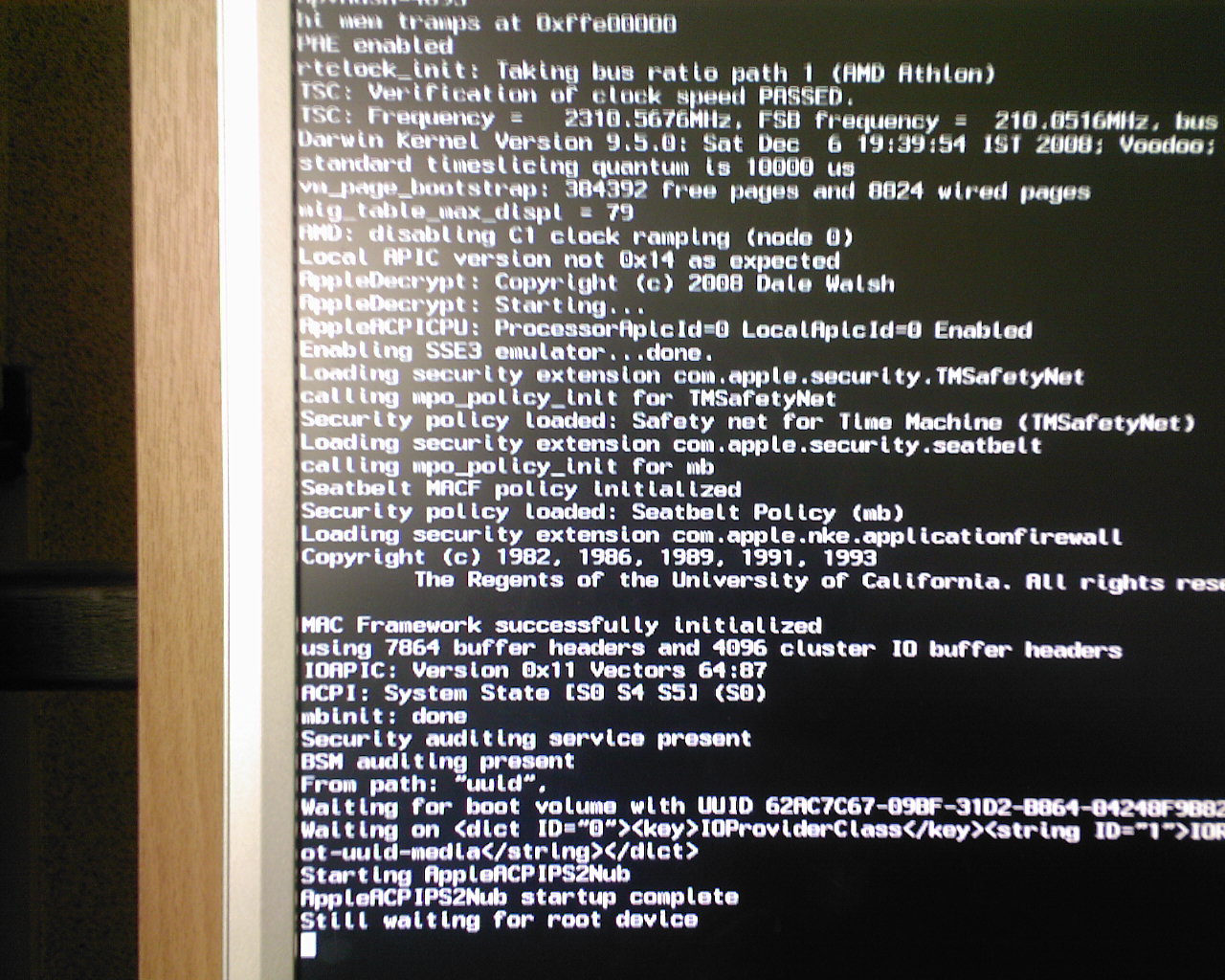

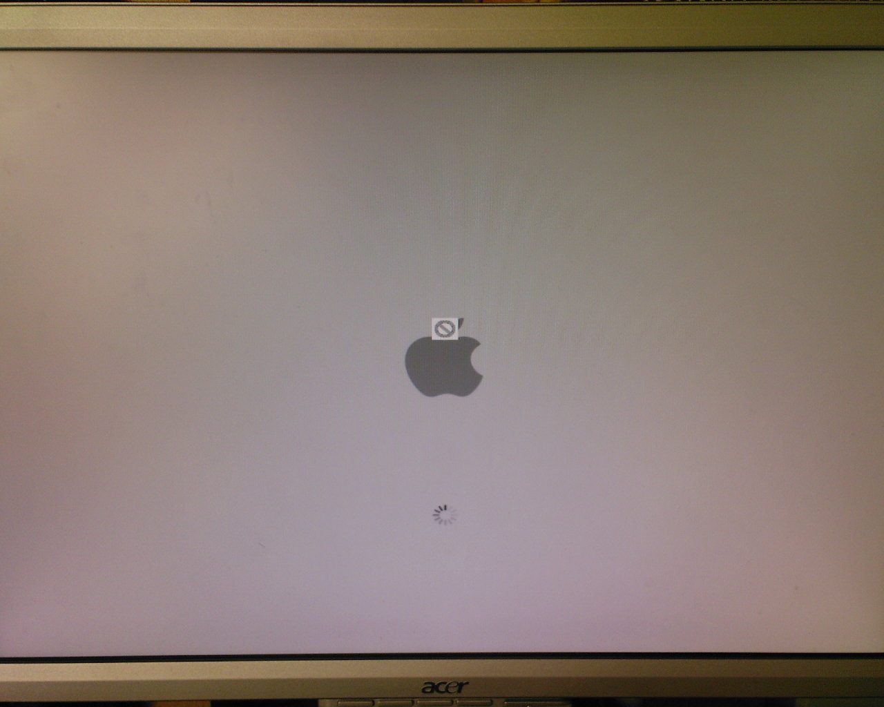

laetificat Posted April 1, 2009 Author Share Posted April 1, 2009 Actually I would choose all the same options as last time with iDeneb just under chipsets choose everything except nForce & only choose one of the others if they are named the same. The chipset seems to be the issue. the first few classes fell out so i installed ideneb in that time, but i get when i go into verbose mode -v it says still waiting for root device and when not in verbose mode -v i get the apple loading screen with a forbidden logo(see atachment). i installed all chipset drivers except applenforceATA, applenforceATA test and another one i can't remeber it. Maybe you can tell me exactly what i have to install in the chipset menu. The apple loading sreen w/ forbidden sign Verbose mode (-v) Link to comment https://www.insanelymac.com/forum/topic/159373-cant-boot-kalyway-1052-fixed-nforce3-mobo-new-update/page/2/#findComment-1121066 Share on other sites More sharing options...

Beerkex'd Posted April 4, 2009 Share Posted April 4, 2009 "Waiting for Root Device" happens when the OS doesn't recognize the motherboard Southbridge or other drive controller chipset - not surprising since you haven't installed any drivers for it! I guess you can try playing with the BIOS settings for the drive controller and see if you can get it to boot. If not, then the most important lesson to be learned from this is that none of the drivers you selected are usable on your system - at least as far as getting it to boot is concerned. I don't know what else you can do now, I have 0 experience with boards with nForce chipsets. Link to comment https://www.insanelymac.com/forum/topic/159373-cant-boot-kalyway-1052-fixed-nforce3-mobo-new-update/page/2/#findComment-1123979 Share on other sites More sharing options...
