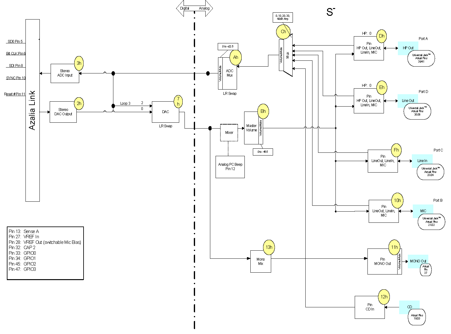

tbcarey Posted August 14, 2007 Share Posted August 14, 2007 It's as I suspected: AppleHDAPatcher has hard-coded pin configurations it applies to AppleHDA, irrespective of the actual values supplied through the codec dump. Essentially, AppleHDAPatcher only scans the codec dump for codec ID and subsystem, and then makes assumptions about the correct pin configurations, nodes, and pathmaps based upon this. In other words, nearly everything AppleHDAPatcher does for Dell STAC9200 variants is completely wrong. I've fixed the pin configurations and the pathmaps manually, however. This just means when I release the changes I've made, it will have to be as a full kext rather than a few files you can apply to the results of your AppleHDAPatcher run. This is for the best anyway, as AppleHDAPatcher also uses its own (older) versions of AppleHDA and AppleHDAController rather than patching the files in your /System/Library/Extensions directory. Here are the pin configuration values I am currently using, along with what they signify: Port A: 0x0d - 0x0421101f - Jack on External Chassis / Right Side / Headphones / 1/8 inch Jack / Black Jack / Jack Detect Override / Pin Group 1 / Unique Sequence #F Port D: 0x0e - 0x90170110 - Fixed in Internal Chassis / No Jack Location / Speaker / Analog Connection / No Jack Color / Misc 1 (Reserved) / Pin Group 1 / Unique Sequence #0 Port C: 0x0f - 0x408000f2 - No Connection on External Chassis / No Jack Location / Line In / No Connection Type / No Jack Color / Jack Detect Override / Pin Group F / Unique Sequence #2 Port B: 0x10 - 0x04a11020 - Jack on External Chassis / Right Side / Mic In / 1/8 inch Jack / Black Jack / Jack Detect Override / Pin Group 2 / Unique Sequence #0 Mono Out: 0x11 - 0x90170111 - Fixed in Internal Chassis / No Jack Location / Speaker / Analog Connection / No Jack Color / Misc 1 (Reserved) / Pin Group 1 / Unique Sequence #1 Theoretically, this should fix the jack detection muting problem -- AppleHDAPatcher was previously setting the pin configuration for Port D to a 1/8 inch jack on the external chassis rather than an internal speaker device -- but unfortunately, it hasn't. Kind of tearing my hair out about this, but I'm sure it will come together soon. ..and attached, a simplified widget node schematic for the STAC9200, in case anyone out there is doing similar work and happens to not be as slow as I am when it comes to fixing these problems! Link to comment https://www.insanelymac.com/forum/topic/15474-guide-dell-inspiron-6400940015201720e1405e1505e1705-intel-core-duo/page/25/#findComment-426969 Share on other sites More sharing options...

devilhood Posted August 14, 2007 Author Share Posted August 14, 2007 It's as I suspected: AppleHDAPatcher has hard-coded pin configurations it applies to AppleHDA, irrespective of the actual values supplied through the codec dump. Essentially, AppleHDAPatcher only scans the codec dump for codec ID and subsystem, and then makes assumptions about the correct pin configurations, nodes, and pathmaps based upon this. In other words, nearly everything AppleHDAPatcher does for Dell STAC9200 variants is completely wrong. I've fixed the pin configurations and the pathmaps manually, however. This just means when I release the changes I've made, it will have to be as a full kext rather than a few files you can apply to the results of your AppleHDAPatcher run. This is for the best anyway, as AppleHDAPatcher also uses its own (older) versions of AppleHDA and AppleHDAController rather than patching the files in your /System/Library/Extensions directory. Here are the pin configuration values I am currently using, along with what they signify: Port A: 0x0d - 0x0421101f - Jack on External Chassis / Right Side / Headphones / 1/8 inch Jack / Black Jack / Jack Detect Override / Pin Group 1 / Unique Sequence #F Port D: 0x0e - 0x90170110 - Fixed in Internal Chassis / No Jack Location / Speaker / Analog Connection / No Jack Color / Misc 1 (Reserved) / Pin Group 1 / Unique Sequence #0 Port C: 0x0f - 0x408000f2 - No Connection on External Chassis / No Jack Location / Line In / No Connection Type / No Jack Color / Jack Detect Override / Pin Group F / Unique Sequence #2 Port B: 0x10 - 0x04a11020 - Jack on External Chassis / Right Side / Mic In / 1/8 inch Jack / Black Jack / Jack Detect Override / Pin Group 2 / Unique Sequence #0 Mono Out: 0x11 - 0x90170111 - Fixed in Internal Chassis / No Jack Location / Speaker / Analog Connection / No Jack Color / Misc 1 (Reserved) / Pin Group 1 / Unique Sequence #1 Theoretically, this should fix the jack detection muting problem -- AppleHDAPatcher was previously setting the pin configuration for Port D to a 1/8 inch jack on the external chassis rather than an internal speaker device -- but unfortunately, it hasn't. Kind of tearing my hair out about this, but I'm sure it will come together soon. ..and attached, a simplified widget node schematic for the STAC9200, in case anyone out there is doing similar work and happens to not be as slow as I am when it comes to fixing these problems! I only wish I had the time to help you with this project, but from the looks of things it seems as though you are getting closer and closer to solving this. PM me your PayPal and I'll donate a few bob if this turns out to be a success! Link to comment https://www.insanelymac.com/forum/topic/15474-guide-dell-inspiron-6400940015201720e1405e1505e1705-intel-core-duo/page/25/#findComment-427061 Share on other sites More sharing options...
