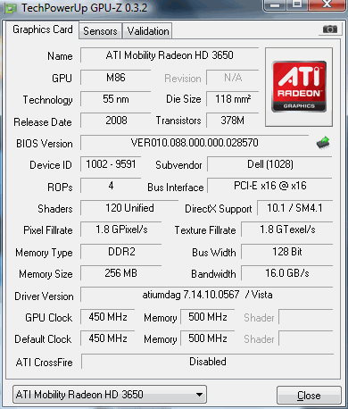

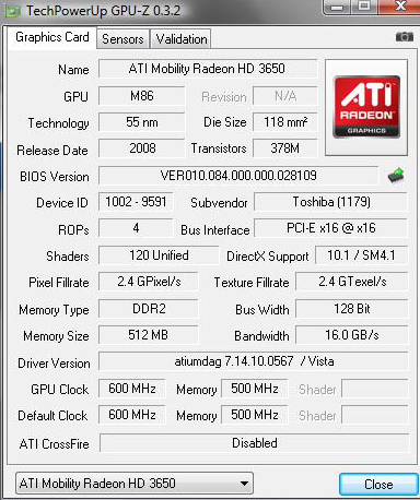

YannickD Posted March 5, 2009 Share Posted March 5, 2009 okay , so here is the gpu-z picture of my card: Link to comment https://www.insanelymac.com/forum/topic/149872-ati-moblity-radeon-hd-3650-on-ideneb-13/page/14/#findComment-1099379 Share on other sites More sharing options...
jsolsona Posted March 6, 2009 Share Posted March 6, 2009 Here is mine: (A dell Studio 1735) Link to comment https://www.insanelymac.com/forum/topic/149872-ati-moblity-radeon-hd-3650-on-ideneb-13/page/14/#findComment-1100260 Share on other sites More sharing options...
Aidass Posted March 6, 2009 Share Posted March 6, 2009 the problem is not in clocks or memory type, the problem is in display connectors. toshiba has different connetors, so framebuffer is able to detect display properly Link to comment https://www.insanelymac.com/forum/topic/149872-ati-moblity-radeon-hd-3650-on-ideneb-13/page/14/#findComment-1100291 Share on other sites More sharing options...

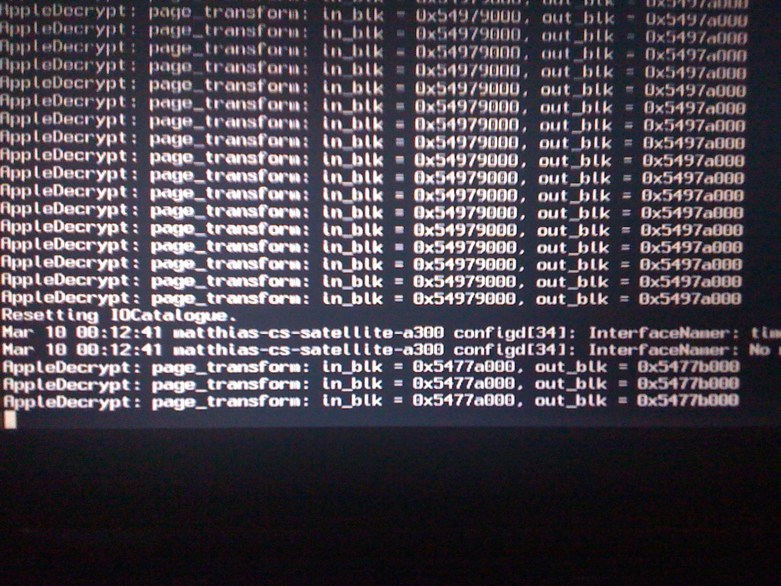

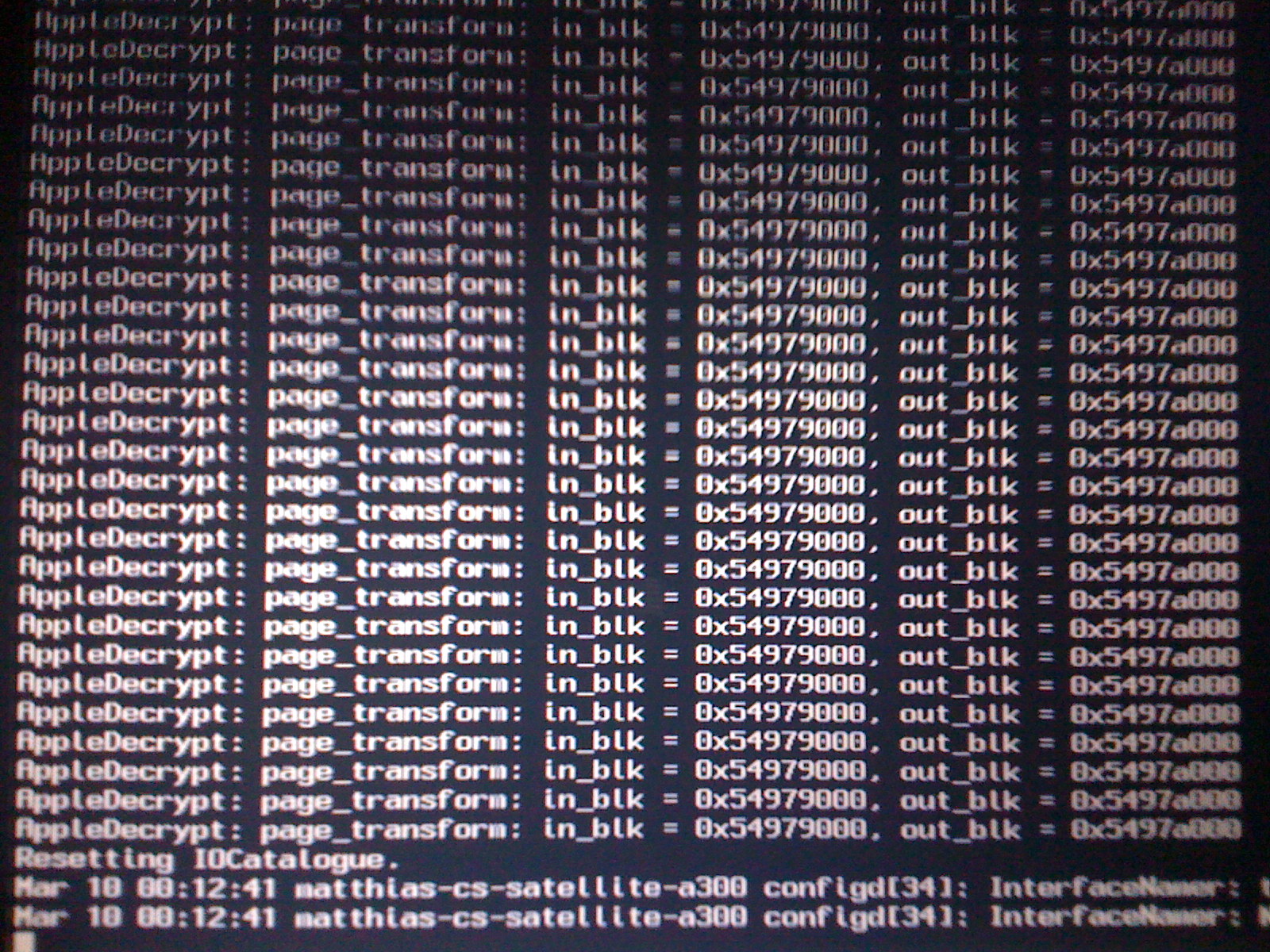

caryntjen Posted March 9, 2009 Share Posted March 9, 2009 OK I tried with Yannick his kext but it keeps loading and it's stuck at see picks: I unpacked the zip and used kexthelperb7 or something like that? After that I restored Permissions with sudo diskutil RepairPermissions / I booted with: -v -f I'll try again another time with a clean install... Maybe I'm doing something wrong? Do I have to use the RepairPermissions? or dos Kexthelper do that for me? Link to comment https://www.insanelymac.com/forum/topic/149872-ati-moblity-radeon-hd-3650-on-ideneb-13/page/14/#findComment-1102835 Share on other sites More sharing options...
Aidass Posted March 10, 2009 Share Posted March 10, 2009 it's not problem of vid drivers, it's something with appledecrypt, try clean install Link to comment https://www.insanelymac.com/forum/topic/149872-ati-moblity-radeon-hd-3650-on-ideneb-13/page/14/#findComment-1103243 Share on other sites More sharing options...

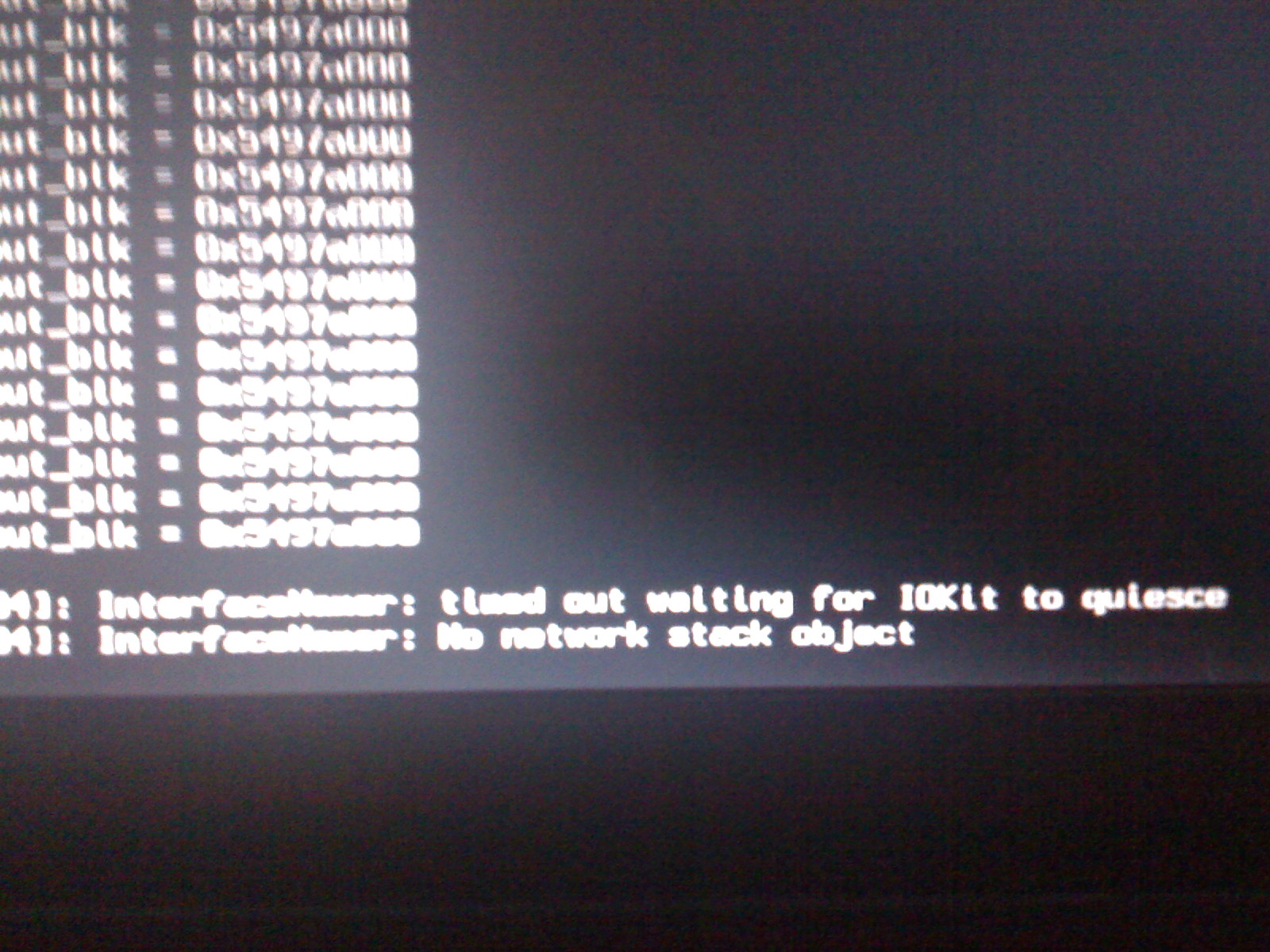

caryntjen Posted March 10, 2009 Share Posted March 10, 2009 Ok what I've done: - A clean install with Yannicks Kext: I've got a Black Screen, then added a External Screen where the screen was bleu. (A lot of AppleDecrypts when I boot with -v -f) - A clean install with the Package (Test 1): A fine reboot but not really a good support for graphics like no cover flow or visualisation. (I rebooted the first time with -v -f) (at both diagnostic boots I've got an error about Firewire (not important I guess) and a com.apple.driver.AppleACPIPS2Nub error that it couldn't load but that's probably of the PS/2 Mouse and Keyboard Fix) Any other ideas anyone? Link to comment https://www.insanelymac.com/forum/topic/149872-ati-moblity-radeon-hd-3650-on-ideneb-13/page/14/#findComment-1103384 Share on other sites More sharing options...

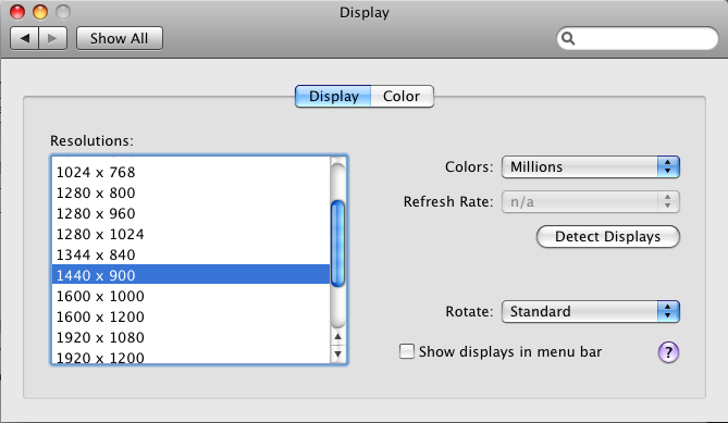

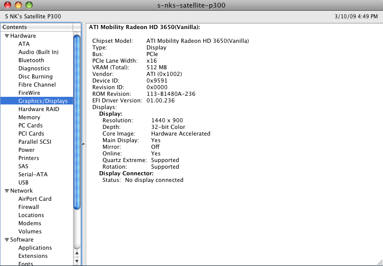

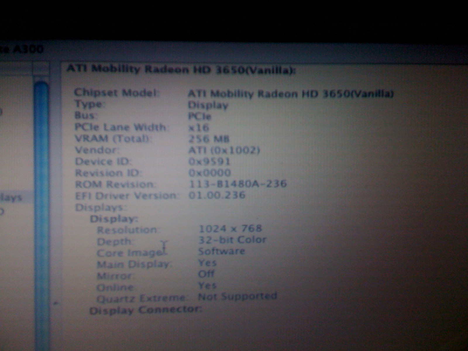

liupingguo Posted March 10, 2009 Share Posted March 10, 2009 hi, guys, I'm trying with my Toshiba P300 with 512mb ATI Mobility HD 3650. got C/I QE so called "enabled", all resolutions with Vanilla. exciting thing, hum? but this is a not a real success! no video can be played, mice moves like thousands tons heavy, refresh rate is n/a, many program can not be launched. btw, I try will many combinations of all the kext, HD3650 PKG, natit, this result is the most likely to be the real one. guessing it's the frame buffer problem, my screen blinks slightly, which surely will kill my eyes if I don't turn it off, or/and it will kill my screen. Link to comment https://www.insanelymac.com/forum/topic/149872-ati-moblity-radeon-hd-3650-on-ideneb-13/page/14/#findComment-1103700 Share on other sites More sharing options...

liupingguo Posted March 10, 2009 Share Posted March 10, 2009 my laptop is a Toshiba A300-1DV.I've tried the YannickD's kext but not work!!!(I've tired with iDeneb 1.3 10.5.5, iDeneb 1.3 10.5.6, iDeneb 1.4 10.5.6 and Kalyway 10.5.6) P300 should have the similar mobo as A300. some one posted sucessful installation on Toshiba. but I doute it's a true sucess. my way was one of possible combinations of fuji1.kext, natit, Yanik.kext. BTW, could YannickD verify and report where what he got is a true sucess? i.e, play DVD or avi file? Link to comment https://www.insanelymac.com/forum/topic/149872-ati-moblity-radeon-hd-3650-on-ideneb-13/page/14/#findComment-1103784 Share on other sites More sharing options...

liupingguo Posted March 11, 2009 Share Posted March 11, 2009 just tell me what you want to see. and by the way , i think refresh rate will never be available on laptop displays because they are lcds and have a fixed refresh rate. and i'm not sure if this is part of your problem , but you dont have quartzgl enabled , you should enable it (in osx86tools or somewhere else). oh and i'm really not the kind of guy who is all like "use the search function" ... but why dont you have a look here:Mouse tearing LCD surely has refresh rate, no matter under windows or OS X. this is screenshot of my desktop which works perfectly with dual LCD, using Asus Geforce 8400GS. Please report a DVD player or Movie player status, thank you! I just want be sure there is a way to get all things working. Link to comment https://www.insanelymac.com/forum/topic/149872-ati-moblity-radeon-hd-3650-on-ideneb-13/page/14/#findComment-1104794 Share on other sites More sharing options...

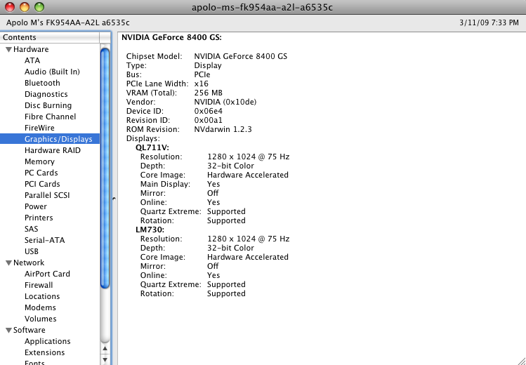

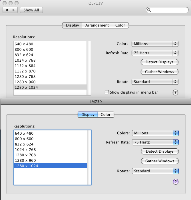

YannickD Posted March 12, 2009 Share Posted March 12, 2009 LCD surely has refresh rate, no matter under windows or OS X. this is screenshot of my desktop which works perfectly with dual LCD, using Asus Geforce 8400GS. Please report a DVD player or Movie player status, thank you! I just want be sure there is a way to get all things working. Of course they have a refresh rate, but on built in lcds its a fixed one (look it up on windows, its 60hz) and osx therefore doesn't allow to change it , simply because it can't be changed. You can read it here if you want.It's a different thing on a desktop computer. On my laptop, both vlc and itunes play videos and dvds flawless. Link to comment https://www.insanelymac.com/forum/topic/149872-ati-moblity-radeon-hd-3650-on-ideneb-13/page/14/#findComment-1104842 Share on other sites More sharing options...
