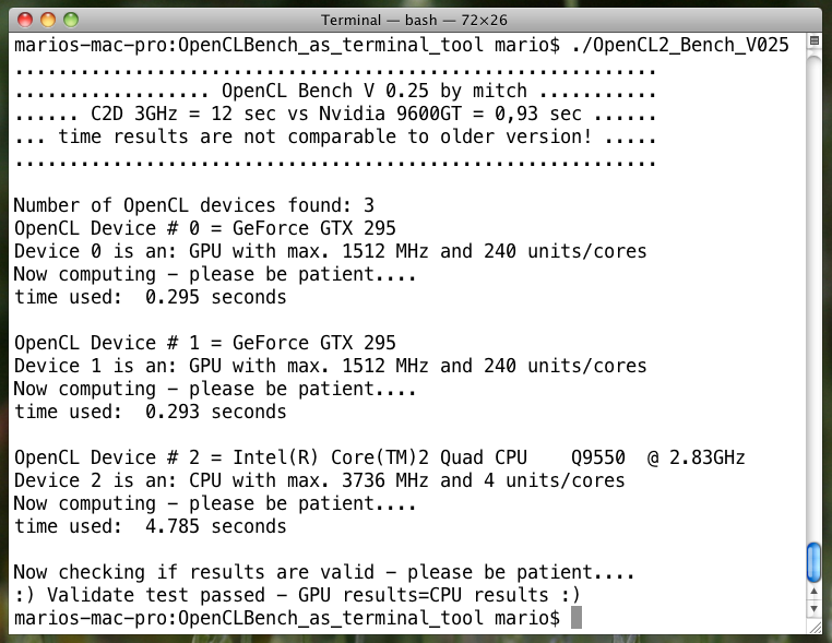

Good luck. I did this today to try to make this work so that I could run SL in 64-bit mode. The Netkas ATY_Init kext is currently only 32-bit. (this works for 32-bit if the EFI string doesn't work for you).
I'm attaching a picture which shows both GPUs being seen by OpenCL.

IORegistryExplorer shows NVCAP for both adapters but the NVPM value only shows up on the second adapter, so I removed it from the first one in my gfx.plist
All works great now and both dvi ports work.
It only reports the VideoRAM wrong. The first cards shows up with both connected displays and 896MB and the second adapter only shows 512MB without any connected displays but that's ok.
Thanks for everything!

Strange. I wonder if OpenCL sees them .. Im gonna go check
