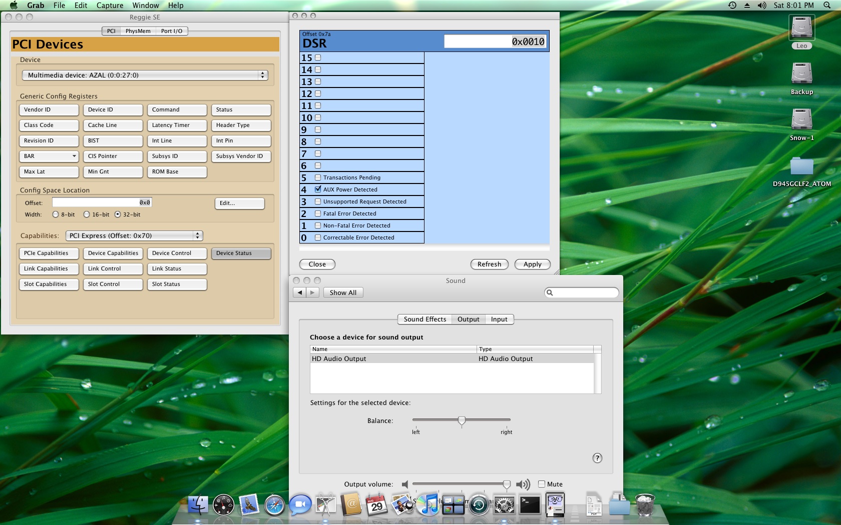

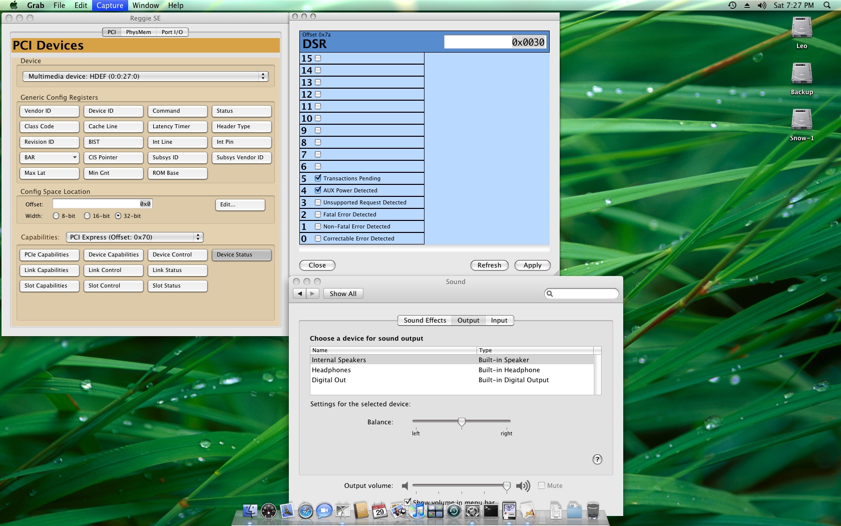

Intel D945GCLF2: might be interesting for someone why AppleHDA.kext didn't work if it's loaded. see the following pictures. I hope you can see what are different. However, I have no idea how to fix AppleHDA.kext working on this board.
AppleHDA.kext was loaded, but no sound.
AppleAzaliaAudio.kext was loaded.
VoodooHDA.kext was loaded.

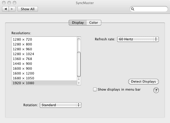

Dude...do u have resolution change in Sys pref with stock kexts for GMA950? Cuz I installed twice SL, everything goes just fine (including video) but I cannot change the resolution from Sys Pref. (only by com.apple.boot.plist)
Yes, I am able to change the resolution in System Preferences, I just tested by changing from 1920x1080 to 1600x1200 and back without a problem. Attached is a screenshot of my display preferences.
Did u install some kext for the video after the SL installation? (could you please tell me your VGA IDs)
No, no video kexts. The kexts I installed were fakesmc.kext, replacing the IOATAFamily with the one from leopard, sleepenabler.kext, NullCPUPM, OpenHaltRestart, PlatformUUID, and the AzaliaAudio kext. Then made a DSDT with the bios fix thing, and edited the boot.plist with arch=i386.

PS. to get the VGA ID's go to System Profiler > Graphics/Display and you should see some numbers in there like (Device ID: 0x27a2 Revision ID: 0x0003...these are from a macbook)
Here's the stuff from System Profiler
Intel GMA 950:
 Chipset Model:	GMA 950
 Type:	GPU
 Bus:	Built-In
 VRAM (Total):	64 MB of Shared System Memory
 Vendor:	Intel (0x8086)
 Device ID:	0x2772
 Revision ID:	0x0002
 Displays:
Display Connector:
 Status:	No Display Connected
SyncMaster:
 Resolution:	1920 x 1080 @ 60 Hz
 Pixel Depth:	32-Bit Color (ARGB8888)
 Main Display:	Yes
 Mirror:	Off
 Online:	Yes
 Rotation:	Supported
And attached are the kexts I used like fakesmc and stuff, and the GMA950 SL stock kexts in case you wanted those too.
