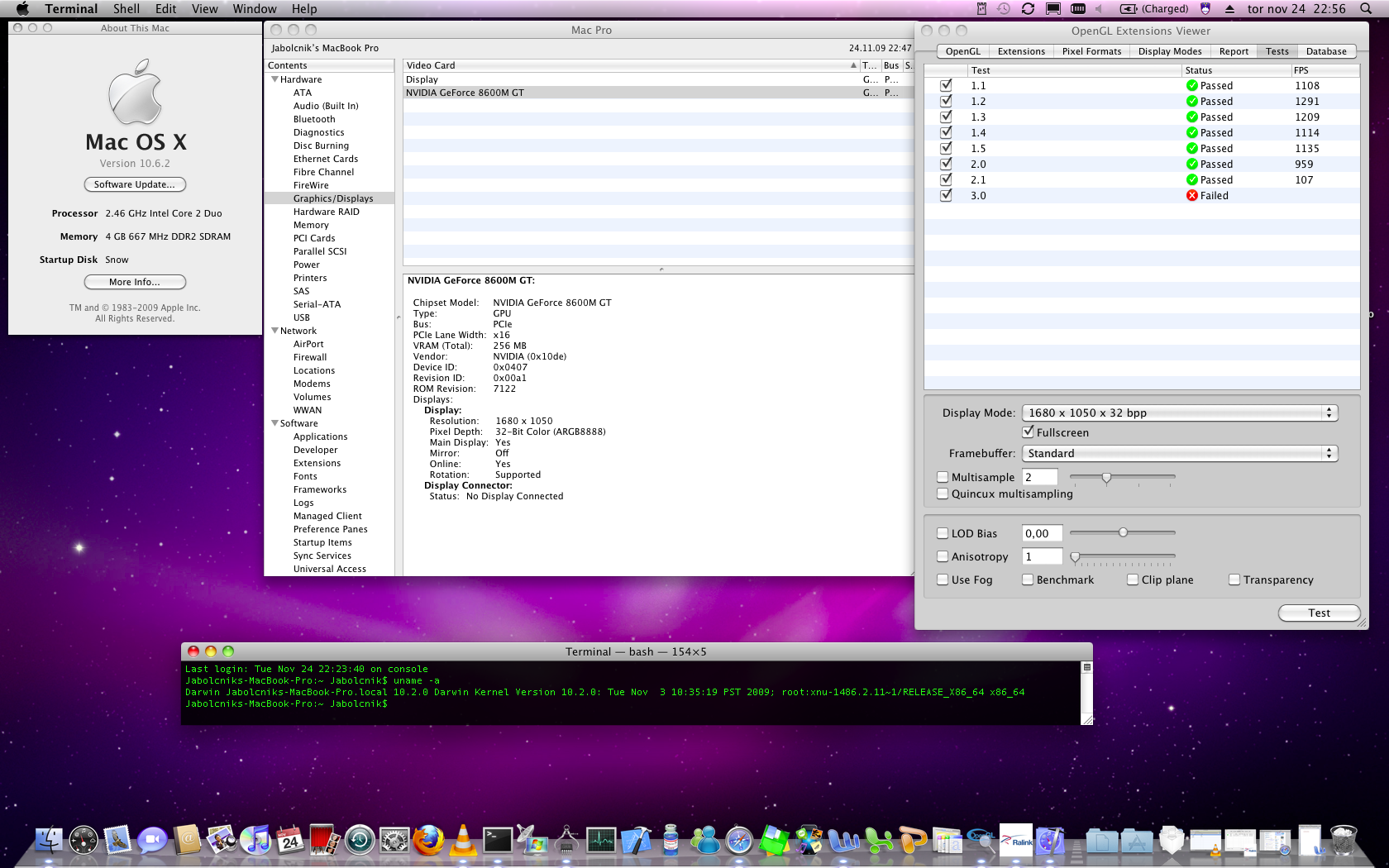

TamauJabuk Posted November 24, 2009 Share Posted November 24, 2009 I'm having big troubles with my 8600m GT card configuration... because I'm not an expert, I have some questions.. I have Toshiba X200 - PSPBUE model. Ive sucessfully installed SL (retail 10.6) and updated to 10.6.1 and to 10.6.2. Im using USB key/flash to boot into SL. I'm using Chameleon 2.0 RC3 bootloader. What I've tried: (tried both x86 and x86_64 mode) 1) Enabled GraphicsEnabler=Yes in /Volumes/USB/Extra/com.apple.boot.plist Card is recognised (atleast Chameleon shows something like that: efi_string ... detected Nvidia 8600m GT 256ram ... PCI(0x0)....) But when OS starts, system profiler shows me that my cards are having only 32 mb ram... NVD50HAL.kext is loaded during the boot procedure. Also sometimes my PSkeyboard doesn't work 2) NVinject.kext I belive that I've downloaded and tried 99% of nvidia*.kext in the world... I have one nvinject64.kext which runs great in x86_64 mode - but I think there is no QE/CI acceleration, when using this kext. System profiler shows two cards, one with 256 mb ram. No QE/CI! 3) NVinject.kext - with NVCAP string I've extracted NVCAP string with OSx86Tools (I know that this tool is written for Leopard). I've edited info.plist in NVinject64.kext and rebuilded Extensions.kext cache.... System profiler shows two cards, one with 256 mb ram. No QE/CI! 4) EFI string I've tried a lot of EFI strings (from EFI Studio, from OSX86Tools, from different Websites....) ------------ Questions: a) How will I know when my card supports QE/CI? Currently I'm using OpenGL tests - and results are 7-10 FPS - I think this are not accelerated results... Is there another method - another program? And yes - I can play Chess - I can move figures... Do I have to change vannila KEXTS? NVD50HAL.kext, Geforce.kext,... c) CAN someone with working QE/CI post all related material (com.apple.boot.plist, which changes in DSDT,... Working EFI string, proper NVCAP values,... which bootloader are you using... ) which can help. Link to comment https://www.insanelymac.com/forum/topic/137047-05-16-11-dual-nvidia-8600m-gt-sli-laptop-dual-display-hdmi-internal-working-together/page/3/#findComment-1340682 Share on other sites More sharing options...
TamauJabuk Posted November 24, 2009 Share Posted November 24, 2009 I'm having big troubles with my 8600m GT card configuration... Troubles with my 8600m GT card - ah no, that was yesterday - today I've already solved that problem! http://www.insanelymac.com/forum/index.php...ded&start=# My Screen Shot Link to comment https://www.insanelymac.com/forum/topic/137047-05-16-11-dual-nvidia-8600m-gt-sli-laptop-dual-display-hdmi-internal-working-together/page/3/#findComment-1341305 Share on other sites More sharing options...

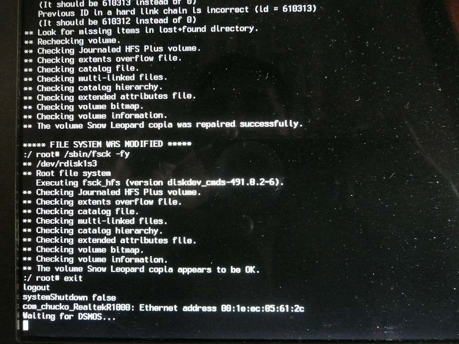

whityini Posted April 23, 2010 Share Posted April 23, 2010 Hey, nice to read about you again. It's very stange I have already update a couple of time after I installed SL using your DSDT (we have the same Notebook exept for the wireless card). All the time everything has gone well. This time at the very first reboot my system gets stuck with the wheel spinning endless. If I use -v flag at the boot this is the screen I get I also boot in 64bit mode and I'm not really sure what nvinject I'm using (I can check if needed). Any chance to solve the problem? Thanks again. Link to comment https://www.insanelymac.com/forum/topic/137047-05-16-11-dual-nvidia-8600m-gt-sli-laptop-dual-display-hdmi-internal-working-together/page/3/#findComment-1454204 Share on other sites More sharing options...
ludacrisvp Posted April 24, 2010 Author Share Posted April 24, 2010 Hey, nice to read about you again.It's very stange I have already update a couple of time after I installed SL using your DSDT (we have the same Notebook exept for the wireless card). All the time everything has gone well. This time at the very first reboot my system gets stuck with the wheel spinning endless. If I use -v flag at the boot this is the screen I getI also boot in 64bit mode and I'm not really sure what nvinject I'm using (I can check if needed). Any chance to solve the problem? Thanks again. I would try booting with -f to force a rebuild of your extensions.mkext for some reason it looks like its freezing waiting for DSMOS to arrive. If that doesn't work you could try to delete the DSMOS kext in Snow/Extra/Extensions or in System/Library/Extensions but make sure you have FakeSMC.kext installed into those locations. I don't have DSMOS.kext in my system at all, Dont Steal Mac OSX.kext is in S/L/E. I do have fakesmc.kext in my extra/extensions folder only. Link to comment https://www.insanelymac.com/forum/topic/137047-05-16-11-dual-nvidia-8600m-gt-sli-laptop-dual-display-hdmi-internal-working-together/page/3/#findComment-1454799 Share on other sites More sharing options...
