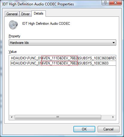

Sorry I made a mistake. 92HD71B7 is the model name I detected with Everest.
The devid is 111D76B2.
In Device Manager-Sound-IDT HDA Codec-Details-Hardware Ids
Thanks for the image, here's mine:
It's the same except for : SUBSYS_103C30F4.
Unless there is something else, I guess I have to setup my own PinConfig...I read something about that, it looked pretty complicated.
Cheers
