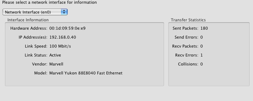

On my Dell Inspiron 1525 I have a Marvell 88E8040 . It is quite different from other Yukon-2 devices:
1. It is not Gigabit adapter, only Fast ethernet.
2. It has only one output port.
3. It needs workarounds in several situations.
So AppleYukon.kext and AppleYukon2.kext don't work with any patches. They intended for chips b3-b7 while I have b8. And I know that 88E8040T has chip b9 also not supported.
FreeBSD driver is "if_msk.c". In development. Seems doesn't work too.
Linux driver "sky2.c" seems to be good.
I was tried to apply them to create MacOSX driver. Here is my sources and debug version. Doesn't work yet!
I give up. :)
Being alone I can't finish it.
EDITED:
Continue developmentMarvell_103.src.zip
EDITED 09-12-2008: Marvell_104.zip
The new sources also include the most full Linux driver sk98lin but without 8040 patches.
Would like to see your reports like my

I took latest AppleYukon2.kext (from 10.5.6), reversed it, compare with oficial Marvell's Linux driver and found that they are similar but Apple driver is for chip b3-b7 while we need b8. Wait for Apple make new version?
I decided to edit binary code by a way to make it is working for b8.
Till now I found only 28 places chip dependent. Not so hard!
Latest result
Jan  4 17:43:13 HackBook4-1 kernel[0]: yukon: Ethernet address 00:1d:09:59:0e:e9
Jan  4 17:44:15 HackBook4-1 kernel[0]: AppleYukon2 - en0 link active, 100-Mbit, full duplex, flow control disabled port 0
Jan  4 17:44:17 HackBook4-1 kernel[0]: AppleYukon2 - en0 link down
Jan  4 17:44:17 HackBook4-1 kernel[0]: AppleYukon2 - en0 link active, 100-Mbit, full duplex, flow control disabled port 0
Jan  4 17:44:19 HackBook4-1 kernel[0]: AppleYukon2 - en0 link down
