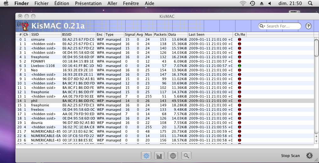

Hacktrix2006 Posted December 20, 2008 Share Posted December 20, 2008 MORE PROGRESS, RESULTING IN AN ACTUAL CONNECTION! I MADE THIS POST WITH IT. I lose the connection after a minute or two put there is proof that the card can get up, get on and move data. I installed the kext from the beginning of this thread but that just makes the card scan, never finds a network. On a hunch I downloaded Kismac, went to preferences and added Airport Extreme Passive Mode, entered my password when prompted and went to the scan window and clicked start scan. Within 30 seconds networks started appearing! Better yet I then went to the airport icon and my network was listed. I clicked on it, it promoted me for a password and connected to the network with WPA security. The connection only lasts for a few minutes before the airport acts like the network disappeared. When it is active it has bursts of speed and then becomes very slow. In Vista the card is very quick from the same place in the house. So, now it connects but now we need to make it stable. By the way this is for sure an AR5007 and the PC is a Compaq Presario C771. CHeck out these files they might help you as this is the drivers that Kismac loads for Atheros Cards. There might be something in the code wise that might just help you. Goodluck!!! Archive.zip Link to comment https://www.insanelymac.com/forum/topic/135572-hope-for-ar5007eg/page/2/#findComment-1007751 Share on other sites More sharing options...

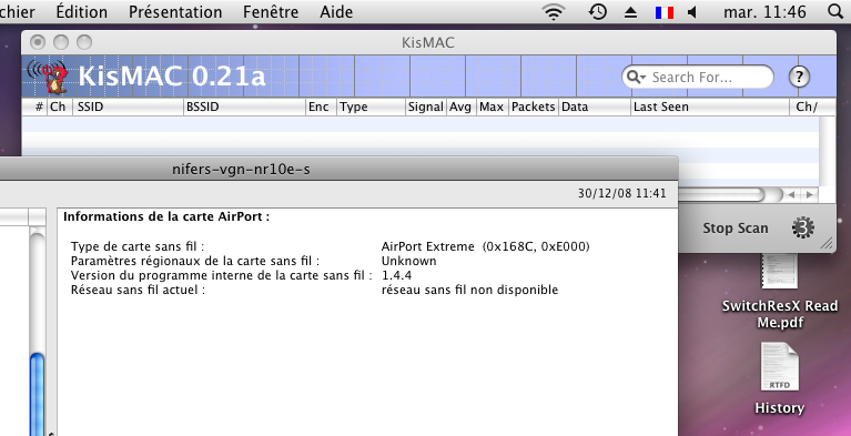

opodeu Posted December 30, 2008 Share Posted December 30, 2008 Hello, I have updated my Kalyway 10.5.2 to 10.5.5 in order to install "Airport update 2004-2008" ... I have followed the Kismac method... but I am stuck... It seems I have a signal but I don't see any wifi acces point... When I try to scan with airport menu, I lost signal on the icon on the top. Any idea ? Link to comment https://www.insanelymac.com/forum/topic/135572-hope-for-ar5007eg/page/2/#findComment-1020338 Share on other sites More sharing options...
Gabo_c Posted December 31, 2008 Share Posted December 31, 2008 Hello, I have updated my Kalyway 10.5.2 to 10.5.5 in order to install "Airport update 2004-2008" ... I have followed the Kismac method... but I am stuck... It seems I have a signal but I don't see any wifi acces point... When I try to scan with airport menu, I lost signal on the icon on the top. Any idea ? most of the time mine do the same,appears to be scanning but nothing, dont ask why but believe me, don't restart turn off o computer and try it....and try it , restart for mine is for sure a kernel panic or nothing on kismac. Link to comment https://www.insanelymac.com/forum/topic/135572-hope-for-ar5007eg/page/2/#findComment-1020509 Share on other sites More sharing options...
opodeu Posted January 11, 2009 Share Posted January 11, 2009 Good news and Bad news... Once, I have succed to open wifi. I follow the instruction... I have rebooted... Since, I lost wifi, I am failing to get back There is no reason why it have worked in first, and now nothing happen... Any idea ? Link to comment https://www.insanelymac.com/forum/topic/135572-hope-for-ar5007eg/page/2/#findComment-1037163 Share on other sites More sharing options...

Mr.Scorpio Posted February 2, 2009 Share Posted February 2, 2009 Thanks Alot, it works perfectly, I have iAtkos v5i Leopard 10.5.5 (Updated to 10.5.6) on my ( Compaq Presario c700 ) laptop "Don't remember the exact model but i think it's c707 ", here is the steps: 1. download your kext and installed it with OSX86Tools and restart. 2. install kismac trunk r319 and restart. 3. open kismac and add ( Airport Extreme Passive Mode ) and click scan. 4. when scanning start show networks stop it and exit kismac. 5. go to airport and select network and start your WiFi journey . Note: 1. Wireless light not work (no blue light) but the wireless works fine. 2. Make sure the wifi turned on from another os (wireless button not work under mac os). 3. Dual-Boot is a must with this method because if you have just mac os installed and you turned the wireless button off accidentally you'll be in a big problem because you'll not be able to turn it on in mac ... don't forget this. Big thanks and appreciation to YOU & OLDMACLOVER "who discovered the method to use the kext" ... OLDMACLOVER Article Link to comment https://www.insanelymac.com/forum/topic/135572-hope-for-ar5007eg/page/2/#findComment-1066506 Share on other sites More sharing options...
