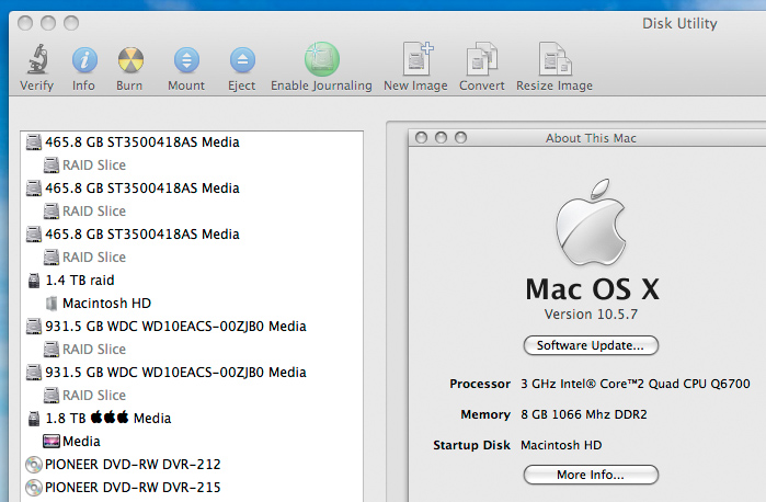

callan280 Posted August 6, 2009 Share Posted August 6, 2009 I was on a slight budget and still managed to build a system that performs better than most. It consists of; (parts are more than 18 months old now) Gigabyte X38-DS5 mobo Intel Core 2 Quad 6700 overclocked @ 3.0Ghz 8 Gb Kingston HyperX DDR2 1066 3x Seagate 7200 500GB Drives Running software RAID (osx) 2x WD 1TB 7200 Drives Running software RAID (media) Leadtek 8800GT 1GB with 2 x Asus 22" DVI monitors Bought a Bluetooth dongle for $5 and bought an apple wireless KB Xbench score is 220.5 (i'm happy with that) Link to comment https://www.insanelymac.com/forum/topic/132416-building-the-ultimate-hackintosh/#findComment-1217949 Share on other sites More sharing options...
