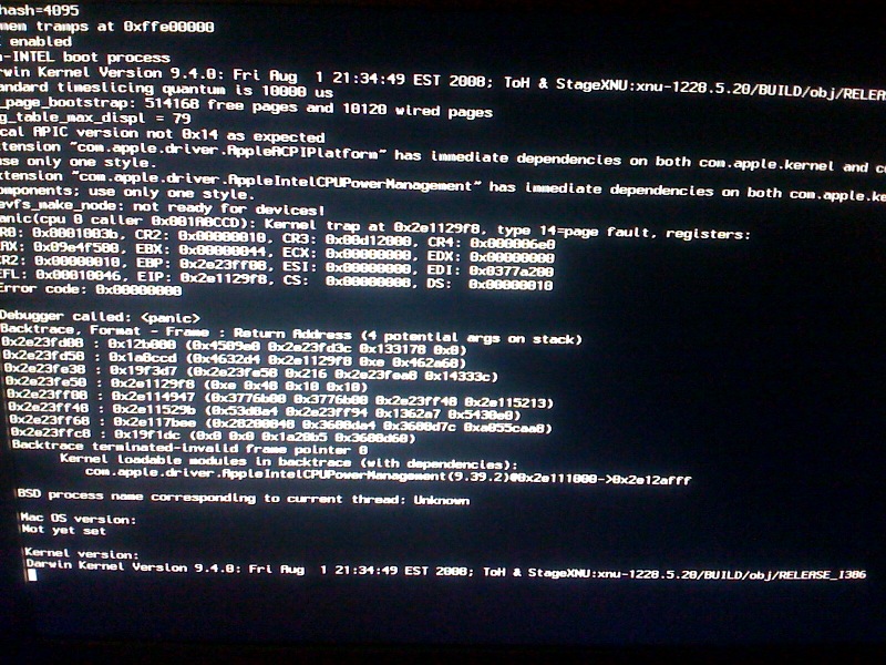

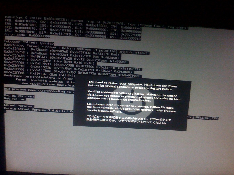

MGJulius Posted September 27, 2008 Share Posted September 27, 2008 Is there any way you can find out whats after "com.apple.driver.AppleIntel..." Cuase the restart screen is blocking it Can you type this next time as well "Graphics Mode"="No" -v Link to comment Share on other sites More sharing options...
Lord Norr Posted September 27, 2008 Author Share Posted September 27, 2008 Ok. I got this Link to comment Share on other sites More sharing options...
MGJulius Posted September 27, 2008 Share Posted September 27, 2008 Ok, Boot back into the iDeneb disc; open the terminal; and type this in rm -rf /Volumes/YourOSXDrive/System/Library/Extensions/AppleIntelCPUPowerManagement.kext Make sure you replace YourOSXDrive with the name of your mac drive Good luck Link to comment Share on other sites More sharing options...

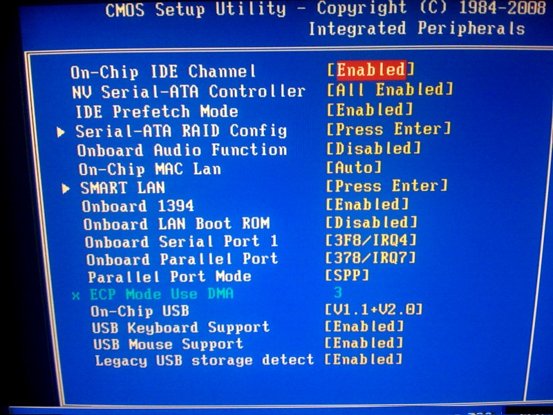

Fergo Posted September 27, 2008 Share Posted September 27, 2008 tried that and now it doesn't reset. However it now gives me the "waiting for root device" message. Almost there. I was having this problem. I solved by changing my SATA configuration in BIOS from IDE to AHCI. After that the system booted fine with iDeneb 1.3. Fergo Link to comment Share on other sites More sharing options...
maclinux Posted September 27, 2008 Share Posted September 27, 2008 Yep, that should do it Link to comment Share on other sites More sharing options...
Lord Norr Posted September 27, 2008 Author Share Posted September 27, 2008 Ok, Boot back into the iDeneb disc; open the terminal; and type this in rm -rf /Volumes/YourOSXDrive/System/Library/Extensions/AppleIntelCPUPowerManagement.kext Make sure you replace YourOSXDrive with the name of your mac drive Good luck Ok, just tried that. Rebooted and still getting the exact same messae I was having this problem. I solved by changing my SATA configuration in BIOS from IDE to AHCI. After that the system booted fine with iDeneb 1.3. Fergo I dont have that option I dont think. Attached is what my BIOS shows me. Link to comment Share on other sites More sharing options...
maclinux Posted September 27, 2008 Share Posted September 27, 2008 After you deleted the AppleIntelCPUPowerManagement.kext, you booted with the -f -v options? IYou also tried the VIA-SB only option when you installed? I would look into the Sata raid option (for the AHCI configuration), but I'm not really sure nforce has that option. Link to comment Share on other sites More sharing options...
