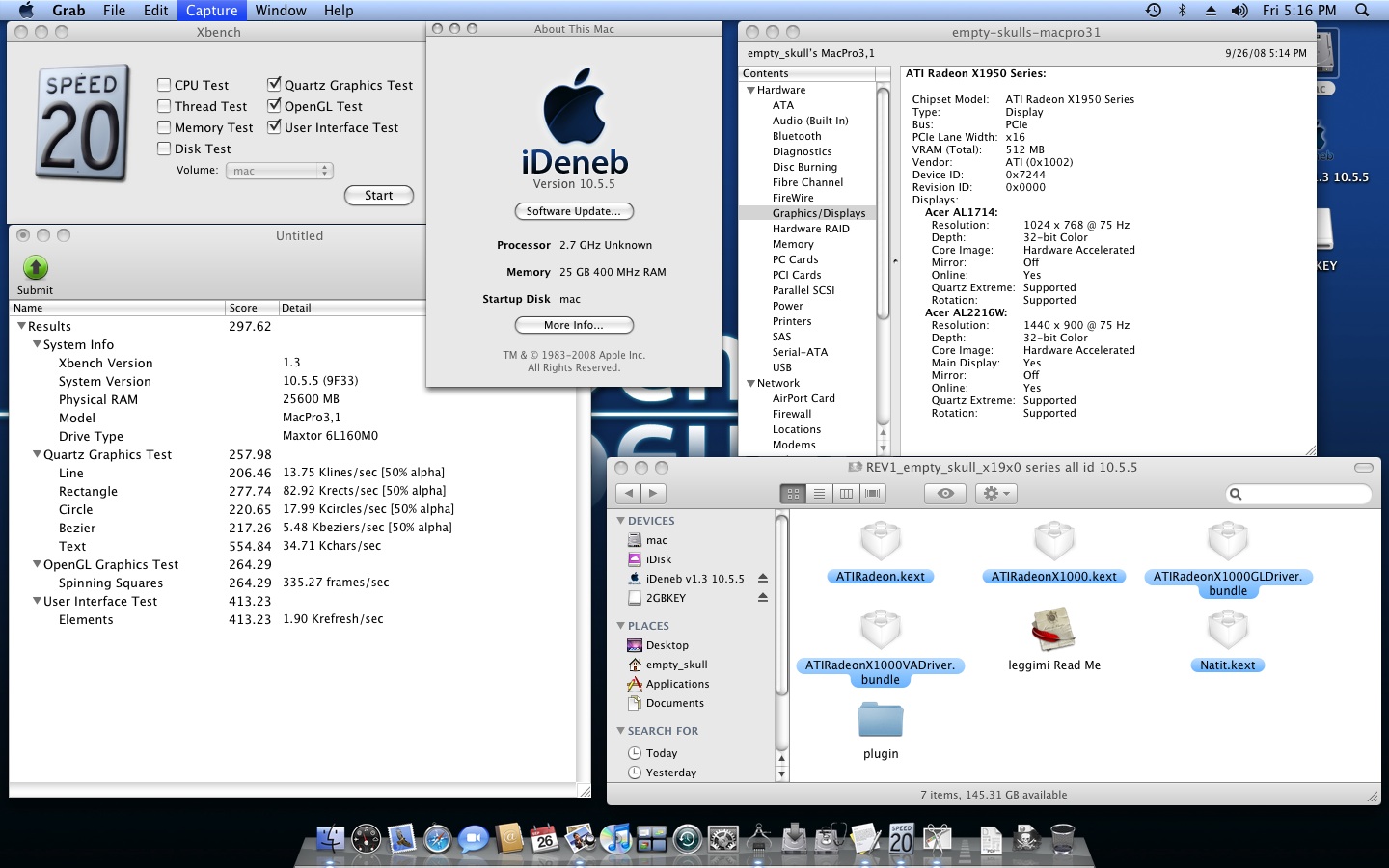

empty skull Posted September 23, 2008 Share Posted September 23, 2008 - ID sopportati da questo pacchetto x serie 19x0 : - Supported 19x0 series Id : 0x72401002 0x72431002 0x72441002 0x72451002 0x72461002 0x72471002 0x72481002 0x72491002 0x724a1002 0x724b1002 0x724c1002 0x724d1002 0x724e1002 0x724f1002 0x724A1002 0x724B1002 0x724C1002 0x724D1002 0x724E1002 0x724F1002 0x72801002 0x724b : work 0x7244 : work DOWNLOAD REV 1 FIX BUG whit leopard 10.5.5 Per informazioni rifatevi al file presente in : leggimi Read Me read_me_leggimi.html For info read read_me_leggimi.html , in the leggimi Read Me folder . Per favore postate i vostri risulatati qui . Please Post your result here ! Grazie mepty Skull . Link to comment https://www.insanelymac.com/forum/topic/127629-driver-x19x0-series-all-id-1055-rev-1-out-fix-bug-to-1055/ Share on other sites More sharing options...

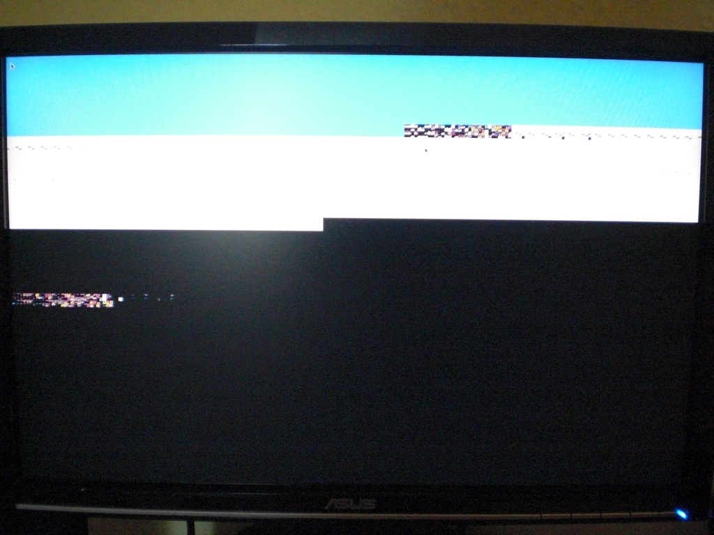

Areandres Posted September 27, 2008 Share Posted September 27, 2008 Thank you empty skull This drivers dont work. Everytime i got this Picture when i boot. I modify many times. Realy i dont have any solution. Link to comment https://www.insanelymac.com/forum/topic/127629-driver-x19x0-series-all-id-1055-rev-1-out-fix-bug-to-1055/#findComment-908049 Share on other sites More sharing options...
empty skull Posted September 27, 2008 Author Share Posted September 27, 2008 sorry ... but for your card is impossibol this kest work ... your card require the ATI2000 kext .. restar whit -x and delte my kext pealse .. Link to comment https://www.insanelymac.com/forum/topic/127629-driver-x19x0-series-all-id-1055-rev-1-out-fix-bug-to-1055/#findComment-908077 Share on other sites More sharing options...

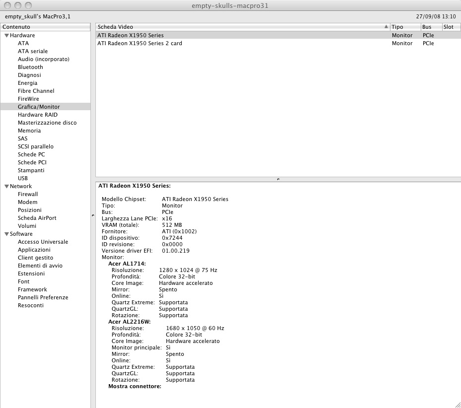

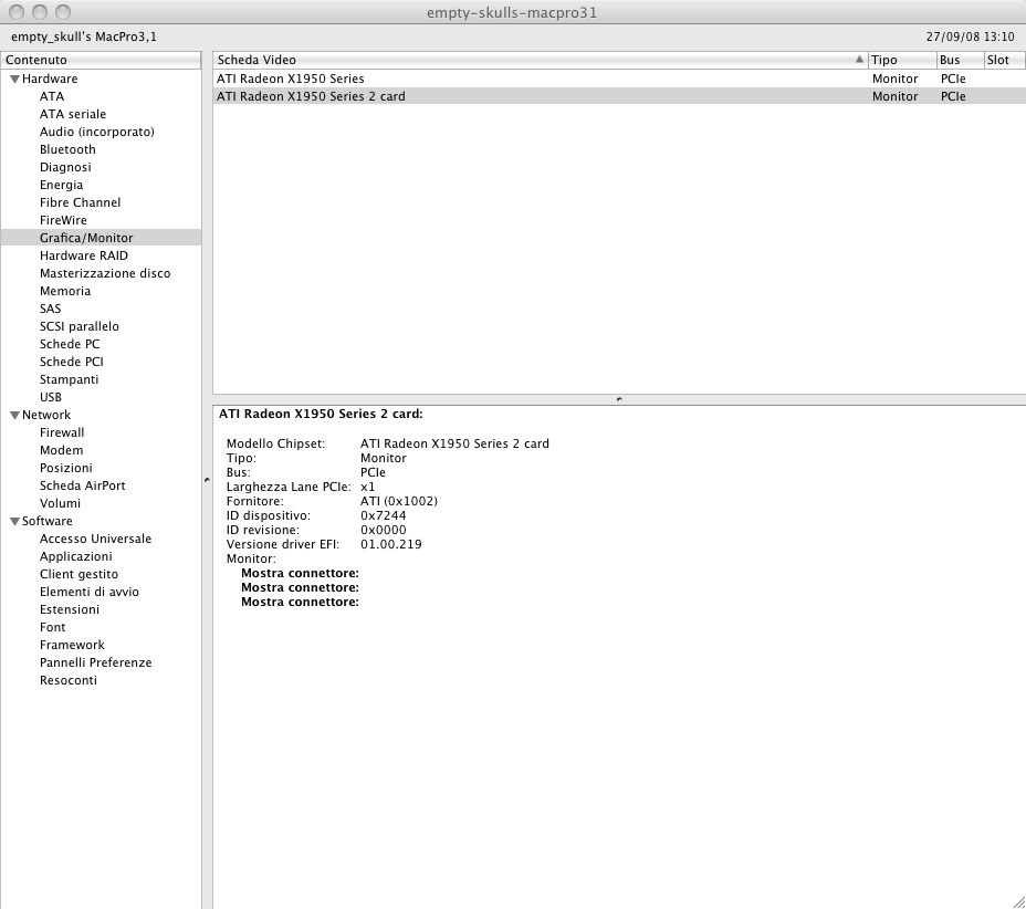

empty skull Posted October 12, 2008 Author Share Posted October 12, 2008 for test this is two efi string : - please remove natit.kext - for dual card x19x0 post your resolut if work for you ! - put your bus id : for example : PciRoot(0x1)/Pci(0x1,0x0)/Pci(0x0,0x0) 1 : test efi empty_skull for dual card <?xml version="1.0" encoding="UTF-8"?> <!DOCTYPE plist PUBLIC "-//Apple//DTD PLIST 1.0//EN" "http://www.apple.com/DTDs/PropertyList-1.0.dtd"> <plist version="1.0"> <dict> <key>PciRoot(0x1)/Pci(0x1,0x0)/Pci(0x0,0x0)</key> <dict> <key>@0,AAPL,boot-display</key> <data> </data> <key>@0,can-hot-plug</key> <data> </data> <key>@0,compatible</key> <string>ATY,Alopias</string> <key>@0,connector-type</key> <data> AAAABA== </data> <key>@0,device_type</key> <string>display</string> <key>@0,display-connect-flags</key> <data> AAAAAA== </data> <key>@0,name</key> <string>ATY,Display-A</string> <key>@1,AAPL,boot-display</key> <data> </data> <key>@1,can-hot-plug</key> <data> </data> <key>@1,compatible</key> <string>ATY,Alopias</string> <key>@1,connector-type</key> <data> AAAABA== </data> <key>@1,device_type</key> <string>display</string> <key>@1,display-connect-flags</key> <data> AAAAAA== </data> <key>@1,name</key> <string>ATY,Display-B</string> <key>ATY,MCLK</key> <string>0x0009eb10</string> <key>ATY,MRT</key> <data> cAAAAAAAfwBoAACAAAEAAGkAAIAAAQAA/////wIAAABgAACA/i8PAv////8C AAAAYAAAgP4vDxL/////AgAAAGgAAICAAQAAaQAAgIABAABoAACAgAAAAGkA AICAAAAAaAAAgAAAAABpAACAAAAAAHAAAAAAAH8AaAAAgAABAABpAACAAAEA AP////8CAAAAYAAAgP4vDwL/////AgAAAGAAAID+Lw8S/////wIAAABoAACA gAEAAGkAAICAAQAAaAAAgIAAAABpAACAgAAAAGgAAIAAAAAAaQAAgAAAAABw AAAAAAB/AAgAAIASRAADdgAAgAAAAgB2AACAqEABAHYAAIAzBxEA/////xQA AAB2AACAMwYBAHYAAIAzBgMAdgAAgDMGAwB2AACAMwYDAHYAAIAzBhMACAAA gBJEAIMKAACAIiIHAGAAAIDuPw8S4AAAgDMGAAA= </data> <key>built-in</key> <data> AA== </data> <key>device_type</key> <string>ATy, RadeonX1900 </string> <key>model</key> <string>Graphics by empty_skull</string> <key>name</key> <string>ATY,AlopiasParent</string> <key>rm_multiboard_capable</key> <data> AAAAAQ== </data> <key>rom-revision</key> <string>NVinject test empty_skull</string> <key>ATY,DeviceID</key> <string>0x7244</string> <key>ATY,EFICompileDate</key> <string>Aug 18 2006</string> <key>ATY,EFIHWInitStatus</key> <string>0x00000000</string> <key>ATY,EFIOrientation</key> <string>0x08</string> <key>IOPCIMatch</key> <string>0x72441002</string> <---- here your id <key>IOMatchCategory</key> <string>IOFramebuffer</string> <key>IOPCIMatch</key> <string>display</string> <key>IOPCIMatch</key> <string></string> <key>IOProbeScore</key> <integer>0</integer> <key>IOProviderClass</key> <string>IOPCIDevice</string> </dict> <key>PciRoot(0x1)/Pci(0x6,0x0)/Pci(0x0,0x0)</key> <dict> <key>@0,AAPL,boot-display</key> <data> </data> <key>@0,can-hot-plug</key> <data> </data> <key>@0,compatible</key> <string>ATY,Alopias_B</string> <key>@0,connector-type</key> <data> AAAABA== </data> <key>@0,device_type</key> <string>display</string> <key>@0,display-connect-flags</key> <data> AAAAAA== </data> <key>@0,name</key> <string>ATY,Display-A</string> <key>@1,AAPL,boot-display</key> <data> </data> <key>@1,can-hot-plug</key> <data> </data> <key>@1,compatible</key> <string>ATY,Alopias_B</string> <key>@1,connector-type</key> <data> AAAABA== </data> <key>@1,device_type</key> <string>display</string> <key>@1,display-connect-flags</key> <data> AAAAAA== </data> <key>@1,name</key> <string>ATY,Display-B</string> <key>ATY,MCLK</key> <string>0x0009eb10</string> <key>ATY,MRT</key> <data> cAAAAAAAfwBoAACAAAEAAGkAAIAAAQAA/////wIAAABgAACA/i8PAv////8C AAAAYAAAgP4vDxL/////AgAAAGgAAICAAQAAaQAAgIABAABoAACAgAAAAGkA AICAAAAAaAAAgAAAAABpAACAAAAAAHAAAAAAAH8AaAAAgAABAABpAACAAAEA AP////8CAAAAYAAAgP4vDwL/////AgAAAGAAAID+Lw8S/////wIAAABoAACA gAEAAGkAAICAAQAAaAAAgIAAAABpAACAgAAAAGgAAIAAAAAAaQAAgAAAAABw AAAAAAB/AAgAAIASRAADdgAAgAAAAgB2AACAqEABAHYAAIAzBxEA/////xQA AAB2AACAMwYBAHYAAIAzBgMAdgAAgDMGAwB2AACAMwYDAHYAAIAzBhMACAAA gBJEAIMKAACAIiIHAGAAAIDuPw8S4AAAgDMGAAA= </data> <key>built-in</key> <data> AA== </data> <key>device_type</key> <string>ATy, RadeonX1900 </string> <key>model</key> <string>Graphics by empty_skull</string> <key>name</key> <string>ATY,Alopias_BParent</string> <key>rm_multiboard_capable</key> <data> AAAAAQ== </data> <key>rom-revision</key> <string>NVinject test empty_skull</string> <key>ATY,DeviceID</key> <string>0x7244</string> <key>ATY,EFICompileDate</key> <string>Aug 18 2006</string> <key>ATY,EFIHWInitStatus</key> <string>0x00000000</string> <key>ATY,EFIOrientation</key> <string>0x08</string> <key>IOPCIMatch</key> <string>0x72441002</string> <------ here your id <key>IOMatchCategory</key> <string>IOFramebuffer</string> <key>IOPCIMatch</key> <string>display</string> <key>IOPCIMatch</key> <string>0x000010de&0x0000ffff 0x00001002&0x0000ffff</string> <key>IOProbeScore</key> <integer>0</integer> <key>IOProviderClass</key> <string>IOPCIDevice</string> </dict> </dict> </plist> this is the hex for boot plist : bd1700000100000002000000d90b00002c00000002010c00d041030a010000000101060000060101 60000007fff04001e0000004100540059002c00560065006e0064006f00720049004400000006000 0002101c0000006400650076006900630065005f0074007900700065000000150000004154592c41 c6f70696173506172656e74220000004100540059002c00450046004900560065007200730069006 006e0000000e00000030312e30302e313430001e000000730061007600650064002d0063006f006e 066006900670000000401000027048200170700b72704820017070093483f400670084000c000b00 e20401000300b00440060003483f400670084000c000b004e20401000300b0044006000300000000 00000000000000000000000000000000000000000000000d8b766486710000010000008680100000 00000006000000b89c420218000000d8b76648689c4202206f7907206f7907e8b766481800000000 0000006020000f8b7664800000000000000000000000000000000000000000000000000000000583 7f478220000010000008680100000100000006000000020001000100010044c94406c4ed3b000100 00040c9440644c94406cdee3b000300020002000200a468e7052a0000004100540059002c0050004 00490043006f006e0066006900670053007000610063006500000004010000021049720700100000 0000340000000080000e0011000000000b2f00000000000000000000000000000000002104972000 b0f05000000000000000000100000000000000000000000000000210497201580206000000001080 100a00f000010080000010d000440000111000000000000000000000000000000000000000005008 00000000000000000000000000000000000000000000000000000000000000000000000000000000 00000000000000000000000000000000000000000000000000000000000000000000000000000000 00000000000000000000000000000000000000000000000000000000000000000000000000000000 000000022000000400031002c006400650076006900630065005f00740079007000650000000b000 00646973706c617928000000400030002c0063006f006e006e006500630074006f0072002d007400 90070006500000008000000000200002c0000004100540059002c004d0065006d00560065006e006 006f00720049004400460075006c006c00000008000000ff80ffff1a0000004100540059002c0048 057004700500049004f00000008000000a3da0300180000004100540059002c00430061007200640 23000000110000003130392d4135323032372d303020000000400031002c0063006f006d00700061 07400690062006c00650000000f0000004154592c416c6f7069617314000000400030002c006e006 006d00650000000f0000004154592c416c6f706961732e000000400030002c004100410050004c00 c0062006f006f0074002d0064006900730070006c0061007900000008000000010000001a0000004 004f005000430049004d0061007400630068000000080000000210447214000000400031002c006e 061006d00650000000f0000004154592c416c6f70696173160000004100540059002c00530043004 004b00000008000000c027090020000000400030002c0063006f006d00700061007400690062006c 0650000000f0000004154592c416c6f70696173140000004100540059002c004d005200540000005 0100007000000000007f0068000080000100006900008000010000ffffffff0200000060000080fe f0f02ffffffff0200000060000080fe2f0f12ffffffff02000000680000808001000069000080800 00006800008080000000690000808000000068000080000000006900008000000000700000000000 f0068000080000100006900008000010000ffffffff0200000060000080fe2f0f02ffffffff02000 0060000080fe2f0f12ffffffff020000006800008080010000690000808001000068000080800000 06900008080000000680000800000000069000080000000007000000000007f00080000801244000 760000800000020076000080a84001007600008033071100ffffffff140000007600008033060100 60000803306030076000080330603007600008033060300760000803306130008000080124400830 0000802222070060000080ee3f0f12e0000080330600001a0000004100540059002c005200650066 043004c004b000000080000008c0a00002a0000004100540059002c004500460049004f007200690 65006e0074006100740069006f006e000000050000000828000000400031002c0063006f006e006e 06500630074006f0072002d007400790070006500000008000000040000002400000041005400590 2c004d0065006d00560065006e0064006f0072004900440000000600000002003000000041005400 9002c004600720061006d0065004200750066006600650072004f006600660073006500740000000 000000e0000000240000004100540059002c0045004600490052006500730074006f007200650064 000000800000008000000360000004100410050004c002c006100750078002d0070006f007700650 72002d0063006f006e006e0065006300740065006400000008000000010000002200000056005200 1004d002c0074006f00740061006c00730069007a006500000008000000000000102200000041005 0059002c004500460049005000720065005200420042004d000000080000000f0000001e00000041 0540059002c004400650076006900630065004900440000000600000044723200000041004100500 4c002c006200610063006b006c0069006700680074002d0063006f006e00740072006f006c000000 8000000000000000e0000006e0061006d0065000000150000004154592c416c6f706961735061726 6e74240000004100540059002c0045004600490050006f00730074005200420042004d0000000800 0004f440000340000004100540059002c00520065006700690073007400650072005300700061006 0065004f0066006600730065007400000008000000f0b2000022000000400030002c006400650076 06900630065005f00740079007000650000000b000000646973706c61790e0000004d00560041004 0000004400000027048200170700b72704820017070093483f400670084000c000b004e204010003 0b00440060003483f400670084000c000b004e20401000300b00440060003100000006d006f00640 65006c0000002200000041545920526164656f6e2058313935307874207365636f6e642063617264 8000000400030002c004100540059002c0045004600490044006900730070006c006100790000000 000000564741422400000049004f004d006100740063006800430061007400650067006f00720079 0000011000000494f4672616d65627566666572160000004100540059002c0052006f006d0023000 00120000003131332d4135323032372d313430160000004100540059002c004d0043004c004b0000 00800000010eb0900280000004100540059002c0049004f00530070006100630065004f006600660 730065007400000008000000000010002c0000004100540059002c00450046004900480057004900 e006900740053007400610074007500730000000800000000000000200000004100540059002c004 006f00700079007200690067006800740000002d000000436f707972696768742041544920546563 86e6f6c6f6769657320496e632e20323030352d323030362a0000004100540059002c00450046004 0043006f006d00700069006c006500440061007400650000000f0000004175672031382032303036 60000004100540059002c0050006c006100740066006f0072006d0049006e0066006f00000084000 00010000000000000000000000000000000000000000000000000000000000000000000000000000 00000000000000000000000000000000000000000000000000000000000000000000000000000000 00000000000000000000000000000000000000000000000000000000000000000000000000000000 000000000000000d80b00002c00000002010c00d041030a010000000101060000010101060000007 ff04001e0000004100540059002c00560065006e0064006f0072004900440000000600000002101c 000006400650076006900630065005f0074007900700065000000150000004154592c416c6f70696 73506172656e74220000004100540059002c00450046004900560065007200730069006f006e0000 00e00000030312e30302e313430001e000000730061007600650064002d0063006f006e006600690 670000000401000027048200170700b72704820017070093483f400670084000c000b004e2040100 300b00440060003483f400670084000c000b004e20401000300b0044006000300000000000000000 00000000000000000000000000000000000000d8b766486710000010000008680100000100000006 00000b89c420218000000d8b76648689c4202206f7907206f7907e8b766481800000000000000060 0000f8b766480000000000000000000000000000000000000000000000000000000058397f478220 00010000008680100000100000006000000020001000100010044c94406c4ed3b000100000040c94 0644c94406cdee3b000300020002000200a468e7052a0000004100540059002c0050004300490043 06f006e0066006900670053007000610063006500000004010000021049720700100000000003400 0000080000e0011000000000b2f000000000000000000000000000000000021049720000b0f05000 000000000000001000000000000000000000000000002104972015802060000000010801100a00f0 0010080000010d000440000111000000000000000000000000000000000000000005008000000000 00000000000000000000000000000000000000000000000000000000000000000000000000000000 00000000000000000000000000000000000000000000000000000000000000000000000000000000 00000000000000000000000000000000000000000000000000000000000000000000000000000002 000000400031002c006400650076006900630065005f00740079007000650000000b000000646973 06c617928000000400030002c0063006f006e006e006500630074006f0072002d007400790070006 00000008000000000200002c0000004100540059002c004d0065006d00560065006e0064006f0072 049004400460075006c006c00000008000000ff80ffff1a0000004100540059002c0048005700470 500049004f00000008000000a3da0300180000004100540059002c00430061007200640023000000 10000003130392d4135323032372d303020000000400031002c0063006f006d00700061007400690 62006c00650000000f0000004154592c416c6f7069617314000000400030002c006e0061006d0065 000000f0000004154592c416c6f706961732e000000400030002c004100410050004c002c0062006 006f0074002d0064006900730070006c0061007900000008000000010000001a00000049004f0050 0430049004d0061007400630068000000080000000210447214000000400031002c006e0061006d0 650000000f0000004154592c416c6f70696173160000004100540059002c00530043004c004b0000 008000000c027090020000000400030002c0063006f006d00700061007400690062006c006500000 0f0000004154592c416c6f70696173140000004100540059002c004d005200540000005c01000070 0000000007f0068000080000100006900008000010000ffffffff0200000060000080fe2f0f02fff ffff0200000060000080fe2f0f12ffffffff02000000680000808001000069000080800100006800 080800000006900008080000000680000800000000069000080000000007000000000007f0068000 80000100006900008000010000ffffffff0200000060000080fe2f0f02ffffffff02000000600000 0fe2f0f12ffffffff020000006800008080010000690000808001000068000080800000006900008 80000000680000800000000069000080000000007000000000007f00080000801244000376000080 000020076000080a84001007600008033071100ffffffff140000007600008033060100760000803 06030076000080330603007600008033060300760000803306130008000080124400830a00008022 2070060000080ee3f0f12e0000080330600001a0000004100540059002c0052006500660043004c0 4b000000080000008c0a00002a0000004100540059002c004500460049004f007200690065006e00 4006100740069006f006e000000050000000828000000400031002c0063006f006e006e006500630 74006f0072002d00740079007000650000000800000004000000240000004100540059002c004d00 5006d00560065006e0064006f007200490044000000060000000200300000004100540059002c004 00720061006d0065004200750066006600650072004f0066006600730065007400000008000000e0 00000240000004100540059002c0045004600490052006500730074006f007200650064000000080 000008000000360000004100410050004c002c006100750078002d0070006f007700650072002d00 3006f006e006e006500630074006500640000000800000001000000220000005600520041004d002 0074006f00740061006c00730069007a00650000000800000000000010220000004100540059002c 04500460049005000720065005200420042004d000000080000000f0000001e00000041005400590 2c00440065007600690063006500490044000000060000004472320000004100410050004c002c00 200610063006b006c0069006700680074002d0063006f006e00740072006f006c000000080000000 0000000e0000006e0061006d0065000000150000004154592c416c6f70696173506172656e742400 0004100540059002c0045004600490050006f00730074005200420042004d000000080000004f440 00340000004100540059002c0052006500670069007300740065007200530070006100630065004f 066006600730065007400000008000000f0b2000022000000400030002c006400650076006900630 65005f00740079007000650000000b000000646973706c61790e0000004d00560041004400000044 0000027048200170700b72704820017070093483f400670084000c000b004e20401000300b004400 0003483f400670084000c000b004e20401000300b00440060003100000006d006f00640065006c00 0002100000041545920526164656f6e2058313935307874206669727374206361726428000000400 30002c004100540059002c0045004600490044006900730070006c00610079000000080000005647 1422400000049004f004d006100740063006800430061007400650067006f0072007900000011000 00494f4672616d65627566666572160000004100540059002c0052006f006d002300000012000000 131332d4135323032372d313430160000004100540059002c004d0043004c004b000000080000001 eb0900280000004100540059002c0049004f00530070006100630065004f00660066007300650074 0000008000000000010002c0000004100540059002c004500460049004800570049006e006900740 53007400610074007500730000000800000000000000200000004100540059002c0043006f007000 9007200690067006800740000002d000000436f707972696768742041544920546563686e6f6c6f6 69657320496e632e20323030352d323030362a0000004100540059002c0045004600490043006f00 d00700069006c006500440061007400650000000f000000417567203138203230303626000000410 540059002c0050006c006100740066006f0072006d0049006e0066006f0000008400000001000000 00000000000000000000000000000000000000000000000000000000000000000000000000000000 00000000000000000000000000000000000000000000000000000000000000000000000000000000 00000000000000000000000000000000000000000000000000000000000000000000000000000000 0000 2 : test efi id 7244 <?xml version="1.0" encoding="UTF-8"?> <!DOCTYPE plist PUBLIC "-//Apple//DTD PLIST 1.0//EN" "http://www.apple.com/DTDs/PropertyList-1.0.dtd"> <plist version="1.0"> <dict> <key>PciRoot(0x1)/Pci(0x1,0x0)/Pci(0x0,0x0)</key> <dict> <key>@0,AAPL,boot-display</key> <string>0x00000001</string> <key>@0,ATY,EFIDisplay</key> <string>0x42414756</string> <key>@0,compatible</key> <string>ATY,Alopias</string> <key>@0,connector-type</key> <string>0x00000200</string> <key>@0,device_type</key> <string>display</string> <key>@0,name</key> <string>ATY,Alopias</string> <key>@1,compatible</key> <string>ATY,Alopias</string> <key>@1,connector-type</key> <string>0x00000004</string> <key>@1,device_type</key> <string>display</string> <key>@1,name</key> <string>ATY,Alopias</string> <key>AAPL,aux-power-connected</key> <string>0x00000001</string> <key>AAPL,backlight-control</key> <string>0x00000000</string> <key>ATY,Card#</key> <string>109-A52027-00</string> <key>ATY,Copyright</key> <string>Copyright ATI Technologies Inc. 2005-2006</string> <key>ATY,DeviceID</key> <string>0x7244</string> <key>ATY,EFICompileDate</key> <string>Aug 18 2006</string> <key>ATY,EFIHWInitStatus</key> <string>0x00000000</string> <key>ATY,EFIOrientation</key> <string>0x08</string> <key>ATY,EFIPostRBBM</key> <string>0x0000444f</string> <key>ATY,EFIPreRBBM</key> <string>0x0000000f</string> <key>ATY,EFIRestored</key> <string>0x00000008</string> <key>ATY,EFIVersion</key> <data> MDEuMDAuMTQwAA== </data> <key>ATY,FrameBufferOffset</key> <string>0x000000e0</string> <key>ATY,HWGPIO</key> <string>0x0003daa3</string> <key>ATY,IOSpaceOffset</key> <string>0x00100000</string> <key>ATY,MCLK</key> <string>0x0009eb10</string> <key>ATY,MRT</key> <data> cAAAAAAAfwBoAACAAAEAAGkAAIAAAQAA/////wIAAABgAACA/i8PAv////8C AAAAYAAAgP4vDxL/////AgAAAGgAAICAAQAAaQAAgIABAABoAACAgAAAAGkA AICAAAAAaAAAgAAAAABpAACAAAAAAHAAAAAAAH8AaAAAgAABAABpAACAAAEA AP////8CAAAAYAAAgP4vDwL/////AgAAAGAAAID+Lw8S/////wIAAABoAACA gAEAAGkAAICAAQAAaAAAgIAAAABpAACAgAAAAGgAAIAAAAAAaQAAgAAAAABw AAAAAAB/AAgAAIASRAADdgAAgAAAAgB2AACAqEABAHYAAIAzBxEA/////xQA AAB2AACAMwYBAHYAAIAzBgMAdgAAgDMGAwB2AACAMwYDAHYAAIAzBhMACAAA gBJEAIMKAACAIiIHAGAAAIDuPw8S4AAAgDMGAAA= </data> <key>ATY,MemVendorID</key> <string>0x0002</string> <key>ATY,MemVendorIDFull</key> <string>0xffff80ff</string> <key>ATY,PCIConfigSpace</key> <data> AhBJcgcAEAAAAAADQAAAAAgAAOABEAAAAACy8AAAAAAAAAAAAAAAAAAAAAAC EElyAACw8FAAAAAAAAAAAAEAAAAAAAAAAAAAAAAAAAIQSXIBWAIGAAAAABCA EQCgDwAAEAgAAAENAARAAAERAAAAAAAAAAAAAAAAAAAAAAAAAAAFAIAAAAAA AAAAAAAAAAAAAAAAAAAAAAAAAAAAAAAAAAAAAAAAAAAAAAAAAAAAAAAAAAAA AAAAAAAAAAAAAAAAAAAAAAAAAAAAAAAAAAAAAAAAAAAAAAAAAAAAAAAAAAAA AAAAAAAAAAAAAAAAAAAAAAAAAAAAAAAAAAAAAAAAAA== </data> <key>ATY,PlatformInfo</key> <data> AQAAAAAAAAAAAAAAAAAAAAAAAAAAAAAAAAAAAAAAAAAAAAAAAAAAAAAAAAAA AAAAAAAAAAAAAAAAAAAAAAAAAAAAAAAAAAAAAAAAAAAAAAAAAAAAAAAAAAAA AAAAAAAAAAAAAAAAAAAAAAAAAAAAAAAAAAAAAAAAAAAAAAAAAAA= </data> <key>ATY,RefCLK</key> <string>0x00000a8c</string> <key>ATY,RegisterSpaceOffset</key> <string>0x0000b2f0</string> <key>ATY,Rom#</key> <string>113-A52027-140</string> <key>ATY,SCLK</key> <string>0x000927c0</string> <key>ATY,VendorID</key> <string>0x1002</string> <key>IOMatchCategory</key> <string>IOFramebuffer</string> <key>IOPCIMatch</key> <string>0x72441002</string> <----- here your id <key>MVAD</key> <data> JwSCABcHALcnBIIAFwcAk0g/QAZwCEAAwACwBOIEAQADALAEQAYAA0g/QAZw CEAAwACwBOIEAQADALAEQAYAAw== </data> <key>VRAM,totalsize</key> <string>0x10000000</string> <key>device_type</key> <string>ATY,AlopiasParent</string> <key>model</key> <string>ATY Radeon X1950xt first card</string> <key>name</key> <string>ATY,AlopiasParent</string> <key>saved-config</key> <data> JwSCABcHALcnBIIAFwcAk0g/QAZwCEAAwACwBOIEAQADALAEQAYAA0g/QAZw CEAAwACwBOIEAQADALAEQAYAAwAAAAAAAAAAAAAAAAAAAAAAAAAAAAAAAAAA AADYt2ZIZxAAABAAAAhoAQAAAQAAAAYAAAC4nEICGAAAANi3ZkhonEICIG95 ByBveQfot2ZIGAAAAAAAAAAGAgAA+LdmSAAAAAAAAAAAAAAAAAAAAAAAAAAA AAAAAAAAAABYOX9HgiAAABAAAAhoAQAAAQAAAAYAAAACAAEAAQABAETJRAbE 7TsAAQAAAEDJRAZEyUQGze47AAMAAgACAAIApGjnBQ== </data> </dict> <key>PciRoot(0x1)/Pci(0x6,0x0)/Pci(0x0,0x0)</key> <dict> <key>@0,AAPL,boot-display</key> <string>0x00000001</string> <key>@0,ATY,EFIDisplay</key> <string>0x42414756</string> <key>@0,compatible</key> <string>ATY,Alopias</string> <key>@0,connector-type</key> <string>0x00000200</string> <key>@0,device_type</key> <string>display</string> <key>@0,name</key> <string>ATY,Alopias</string> <key>@1,compatible</key> <string>ATY,Alopias</string> <key>@1,connector-type</key> <string>0x00000004</string> <key>@1,device_type</key> <string>display</string> <key>@1,name</key> <string>ATY,Alopias</string> <key>AAPL,aux-power-connected</key> <string>0x00000001</string> <key>AAPL,backlight-control</key> <string>0x00000000</string> <key>ATY,Card#</key> <string>109-A52027-00</string> <key>ATY,Copyright</key> <string>Copyright ATI Technologies Inc. 2005-2006</string> <key>ATY,DeviceID</key> <string>0x7244</string> <key>ATY,EFICompileDate</key> <string>Aug 18 2006</string> <key>ATY,EFIHWInitStatus</key> <string>0x00000000</string> <key>ATY,EFIOrientation</key> <string>0x08</string> <key>ATY,EFIPostRBBM</key> <string>0x0000444f</string> <key>ATY,EFIPreRBBM</key> <string>0x0000000f</string> <key>ATY,EFIRestored</key> <string>0x00000008</string> <key>ATY,EFIVersion</key> <data> MDEuMDAuMTQwAA== </data> <key>ATY,FrameBufferOffset</key> <string>0x000000e0</string> <key>ATY,HWGPIO</key> <string>0x0003daa3</string> <key>ATY,IOSpaceOffset</key> <string>0x00100000</string> <key>ATY,MCLK</key> <string>0x0009eb10</string> <key>ATY,MRT</key> <data> cAAAAAAAfwBoAACAAAEAAGkAAIAAAQAA/////wIAAABgAACA/i8PAv////8C AAAAYAAAgP4vDxL/////AgAAAGgAAICAAQAAaQAAgIABAABoAACAgAAAAGkA AICAAAAAaAAAgAAAAABpAACAAAAAAHAAAAAAAH8AaAAAgAABAABpAACAAAEA AP////8CAAAAYAAAgP4vDwL/////AgAAAGAAAID+Lw8S/////wIAAABoAACA gAEAAGkAAICAAQAAaAAAgIAAAABpAACAgAAAAGgAAIAAAAAAaQAAgAAAAABw AAAAAAB/AAgAAIASRAADdgAAgAAAAgB2AACAqEABAHYAAIAzBxEA/////xQA AAB2AACAMwYBAHYAAIAzBgMAdgAAgDMGAwB2AACAMwYDAHYAAIAzBhMACAAA gBJEAIMKAACAIiIHAGAAAIDuPw8S4AAAgDMGAAA= </data> <key>ATY,MemVendorID</key> <string>0x0002</string> <key>ATY,MemVendorIDFull</key> <string>0xffff80ff</string> <key>ATY,PCIConfigSpace</key> <data> AhBJcgcAEAAAAAADQAAAAAgAAOABEAAAAACy8AAAAAAAAAAAAAAAAAAAAAAC EElyAACw8FAAAAAAAAAAAAEAAAAAAAAAAAAAAAAAAAIQSXIBWAIGAAAAABCA EQCgDwAAEAgAAAENAARAAAERAAAAAAAAAAAAAAAAAAAAAAAAAAAFAIAAAAAA AAAAAAAAAAAAAAAAAAAAAAAAAAAAAAAAAAAAAAAAAAAAAAAAAAAAAAAAAAAA AAAAAAAAAAAAAAAAAAAAAAAAAAAAAAAAAAAAAAAAAAAAAAAAAAAAAAAAAAAA AAAAAAAAAAAAAAAAAAAAAAAAAAAAAAAAAAAAAAAAAA== </data> <key>ATY,PlatformInfo</key> <data> AQAAAAAAAAAAAAAAAAAAAAAAAAAAAAAAAAAAAAAAAAAAAAAAAAAAAAAAAAAA AAAAAAAAAAAAAAAAAAAAAAAAAAAAAAAAAAAAAAAAAAAAAAAAAAAAAAAAAAAA AAAAAAAAAAAAAAAAAAAAAAAAAAAAAAAAAAAAAAAAAAAAAAAAAAA= </data> <key>ATY,RefCLK</key> <string>0x00000a8c</string> <key>ATY,RegisterSpaceOffset</key> <string>0x0000b2f0</string> <key>ATY,Rom#</key> <string>113-A52027-140</string> <key>ATY,SCLK</key> <string>0x000927c0</string> <key>ATY,VendorID</key> <string>0x1002</string> <key>IOMatchCategory</key> <string>IOFramebuffer</string> <key>IOPCIMatch</key> <string>0x72441002</string> <----- here your id <key>MVAD</key> <data> JwSCABcHALcnBIIAFwcAk0g/QAZwCEAAwACwBOIEAQADALAEQAYAA0g/QAZw CEAAwACwBOIEAQADALAEQAYAAw== </data> <key>VRAM,totalsize</key> <string>0x10000000</string> <key>device_type</key> <string>ATY,AlopiasParent</string> <key>model</key> <string>ATY Radeon X1950xt second card</string> <key>name</key> <string>ATY,AlopiasParent</string> <key>saved-config</key> <data> JwSCABcHALcnBIIAFwcAk0g/QAZwCEAAwACwBOIEAQADALAEQAYAA0g/QAZw CEAAwACwBOIEAQADALAEQAYAAwAAAAAAAAAAAAAAAAAAAAAAAAAAAAAAAAAA AADYt2ZIZxAAABAAAAhoAQAAAQAAAAYAAAC4nEICGAAAANi3ZkhonEICIG95 ByBveQfot2ZIGAAAAAAAAAAGAgAA+LdmSAAAAAAAAAAAAAAAAAAAAAAAAAAA AAAAAAAAAABYOX9HgiAAABAAAAhoAQAAAQAAAAYAAAACAAEAAQABAETJRAbE 7TsAAQAAAEDJRAZEyUQGze47AAMAAgACAAIApGjnBQ== </data> </dict> </dict> </plist> this is the hex for boot plist : bd1700000100000002000000d90b00002c00000002010c00d041030a010000000101060000060101 60000007fff04001e0000004100540059002c00560065006e0064006f00720049004400000006000 0002101c0000006400650076006900630065005f0074007900700065000000150000004154592c41 c6f70696173506172656e74220000004100540059002c00450046004900560065007200730069006 006e0000000e00000030312e30302e313430001e000000730061007600650064002d0063006f006e 066006900670000000401000027048200170700b72704820017070093483f400670084000c000b00 e20401000300b00440060003483f400670084000c000b004e20401000300b0044006000300000000 00000000000000000000000000000000000000000000000d8b766486710000010000008680100000 00000006000000b89c420218000000d8b76648689c4202206f7907206f7907e8b766481800000000 0000006020000f8b7664800000000000000000000000000000000000000000000000000000000583 7f478220000010000008680100000100000006000000020001000100010044c94406c4ed3b000100 00040c9440644c94406cdee3b000300020002000200a468e7052a0000004100540059002c0050004 00490043006f006e0066006900670053007000610063006500000004010000021049720700100000 0000340000000080000e0011000000000b2f00000000000000000000000000000000002104972000 b0f05000000000000000000100000000000000000000000000000210497201580206000000001080 100a00f000010080000010d000440000111000000000000000000000000000000000000000005008 00000000000000000000000000000000000000000000000000000000000000000000000000000000 00000000000000000000000000000000000000000000000000000000000000000000000000000000 00000000000000000000000000000000000000000000000000000000000000000000000000000000 000000022000000400031002c006400650076006900630065005f00740079007000650000000b000 00646973706c617928000000400030002c0063006f006e006e006500630074006f0072002d007400 90070006500000008000000000200002c0000004100540059002c004d0065006d00560065006e006 006f00720049004400460075006c006c00000008000000ff80ffff1a0000004100540059002c0048 057004700500049004f00000008000000a3da0300180000004100540059002c00430061007200640 23000000110000003130392d4135323032372d303020000000400031002c0063006f006d00700061 07400690062006c00650000000f0000004154592c416c6f7069617314000000400030002c006e006 006d00650000000f0000004154592c416c6f706961732e000000400030002c004100410050004c00 c0062006f006f0074002d0064006900730070006c0061007900000008000000010000001a0000004 004f005000430049004d0061007400630068000000080000000210447214000000400031002c006e 061006d00650000000f0000004154592c416c6f70696173160000004100540059002c00530043004 004b00000008000000c027090020000000400030002c0063006f006d00700061007400690062006c 0650000000f0000004154592c416c6f70696173140000004100540059002c004d005200540000005 0100007000000000007f0068000080000100006900008000010000ffffffff0200000060000080fe f0f02ffffffff0200000060000080fe2f0f12ffffffff02000000680000808001000069000080800 00006800008080000000690000808000000068000080000000006900008000000000700000000000 f0068000080000100006900008000010000ffffffff0200000060000080fe2f0f02ffffffff02000 0060000080fe2f0f12ffffffff020000006800008080010000690000808001000068000080800000 06900008080000000680000800000000069000080000000007000000000007f00080000801244000 760000800000020076000080a84001007600008033071100ffffffff140000007600008033060100 60000803306030076000080330603007600008033060300760000803306130008000080124400830 0000802222070060000080ee3f0f12e0000080330600001a0000004100540059002c005200650066 043004c004b000000080000008c0a00002a0000004100540059002c004500460049004f007200690 65006e0074006100740069006f006e000000050000000828000000400031002c0063006f006e006e 06500630074006f0072002d007400790070006500000008000000040000002400000041005400590 2c004d0065006d00560065006e0064006f0072004900440000000600000002003000000041005400 9002c004600720061006d0065004200750066006600650072004f006600660073006500740000000 000000e0000000240000004100540059002c0045004600490052006500730074006f007200650064 000000800000008000000360000004100410050004c002c006100750078002d0070006f007700650 72002d0063006f006e006e0065006300740065006400000008000000010000002200000056005200 1004d002c0074006f00740061006c00730069007a006500000008000000000000102200000041005 0059002c004500460049005000720065005200420042004d000000080000000f0000001e00000041 0540059002c004400650076006900630065004900440000000600000044723200000041004100500 4c002c006200610063006b006c0069006700680074002d0063006f006e00740072006f006c000000 8000000000000000e0000006e0061006d0065000000150000004154592c416c6f706961735061726 6e74240000004100540059002c0045004600490050006f00730074005200420042004d0000000800 0004f440000340000004100540059002c00520065006700690073007400650072005300700061006 0065004f0066006600730065007400000008000000f0b2000022000000400030002c006400650076 06900630065005f00740079007000650000000b000000646973706c61790e0000004d00560041004 0000004400000027048200170700b72704820017070093483f400670084000c000b004e204010003 0b00440060003483f400670084000c000b004e20401000300b00440060003100000006d006f00640 65006c0000002200000041545920526164656f6e2058313935307874207365636f6e642063617264 8000000400030002c004100540059002c0045004600490044006900730070006c006100790000000 000000564741422400000049004f004d006100740063006800430061007400650067006f00720079 0000011000000494f4672616d65627566666572160000004100540059002c0052006f006d0023000 00120000003131332d4135323032372d313430160000004100540059002c004d0043004c004b0000 00800000010eb0900280000004100540059002c0049004f00530070006100630065004f006600660 730065007400000008000000000010002c0000004100540059002c00450046004900480057004900 e006900740053007400610074007500730000000800000000000000200000004100540059002c004 006f00700079007200690067006800740000002d000000436f707972696768742041544920546563 86e6f6c6f6769657320496e632e20323030352d323030362a0000004100540059002c00450046004 0043006f006d00700069006c006500440061007400650000000f0000004175672031382032303036 60000004100540059002c0050006c006100740066006f0072006d0049006e0066006f00000084000 00010000000000000000000000000000000000000000000000000000000000000000000000000000 00000000000000000000000000000000000000000000000000000000000000000000000000000000 00000000000000000000000000000000000000000000000000000000000000000000000000000000 000000000000000d80b00002c00000002010c00d041030a010000000101060000010101060000007 ff04001e0000004100540059002c00560065006e0064006f0072004900440000000600000002101c 000006400650076006900630065005f0074007900700065000000150000004154592c416c6f70696 73506172656e74220000004100540059002c00450046004900560065007200730069006f006e0000 00e00000030312e30302e313430001e000000730061007600650064002d0063006f006e006600690 670000000401000027048200170700b72704820017070093483f400670084000c000b004e2040100 300b00440060003483f400670084000c000b004e20401000300b0044006000300000000000000000 00000000000000000000000000000000000000d8b766486710000010000008680100000100000006 00000b89c420218000000d8b76648689c4202206f7907206f7907e8b766481800000000000000060 0000f8b766480000000000000000000000000000000000000000000000000000000058397f478220 00010000008680100000100000006000000020001000100010044c94406c4ed3b000100000040c94 0644c94406cdee3b000300020002000200a468e7052a0000004100540059002c0050004300490043 06f006e0066006900670053007000610063006500000004010000021049720700100000000003400 0000080000e0011000000000b2f000000000000000000000000000000000021049720000b0f05000 000000000000001000000000000000000000000000002104972015802060000000010801100a00f0 0010080000010d000440000111000000000000000000000000000000000000000005008000000000 00000000000000000000000000000000000000000000000000000000000000000000000000000000 00000000000000000000000000000000000000000000000000000000000000000000000000000000 00000000000000000000000000000000000000000000000000000000000000000000000000000002 000000400031002c006400650076006900630065005f00740079007000650000000b000000646973 06c617928000000400030002c0063006f006e006e006500630074006f0072002d007400790070006 00000008000000000200002c0000004100540059002c004d0065006d00560065006e0064006f0072 049004400460075006c006c00000008000000ff80ffff1a0000004100540059002c0048005700470 500049004f00000008000000a3da0300180000004100540059002c00430061007200640023000000 10000003130392d4135323032372d303020000000400031002c0063006f006d00700061007400690 62006c00650000000f0000004154592c416c6f7069617314000000400030002c006e0061006d0065 000000f0000004154592c416c6f706961732e000000400030002c004100410050004c002c0062006 006f0074002d0064006900730070006c0061007900000008000000010000001a00000049004f0050 0430049004d0061007400630068000000080000000210447214000000400031002c006e0061006d0 650000000f0000004154592c416c6f70696173160000004100540059002c00530043004c004b0000 008000000c027090020000000400030002c0063006f006d00700061007400690062006c006500000 0f0000004154592c416c6f70696173140000004100540059002c004d005200540000005c01000070 0000000007f0068000080000100006900008000010000ffffffff0200000060000080fe2f0f02fff ffff0200000060000080fe2f0f12ffffffff02000000680000808001000069000080800100006800 080800000006900008080000000680000800000000069000080000000007000000000007f0068000 80000100006900008000010000ffffffff0200000060000080fe2f0f02ffffffff02000000600000 0fe2f0f12ffffffff020000006800008080010000690000808001000068000080800000006900008 80000000680000800000000069000080000000007000000000007f00080000801244000376000080 000020076000080a84001007600008033071100ffffffff140000007600008033060100760000803 06030076000080330603007600008033060300760000803306130008000080124400830a00008022 2070060000080ee3f0f12e0000080330600001a0000004100540059002c0052006500660043004c0 4b000000080000008c0a00002a0000004100540059002c004500460049004f007200690065006e00 4006100740069006f006e000000050000000828000000400031002c0063006f006e006e006500630 74006f0072002d00740079007000650000000800000004000000240000004100540059002c004d00 5006d00560065006e0064006f007200490044000000060000000200300000004100540059002c004 00720061006d0065004200750066006600650072004f0066006600730065007400000008000000e0 00000240000004100540059002c0045004600490052006500730074006f007200650064000000080 000008000000360000004100410050004c002c006100750078002d0070006f007700650072002d00 3006f006e006e006500630074006500640000000800000001000000220000005600520041004d002 0074006f00740061006c00730069007a00650000000800000000000010220000004100540059002c 04500460049005000720065005200420042004d000000080000000f0000001e00000041005400590 2c00440065007600690063006500490044000000060000004472320000004100410050004c002c00 200610063006b006c0069006700680074002d0063006f006e00740072006f006c000000080000000 0000000e0000006e0061006d0065000000150000004154592c416c6f70696173506172656e742400 0004100540059002c0045004600490050006f00730074005200420042004d000000080000004f440 00340000004100540059002c0052006500670069007300740065007200530070006100630065004f 066006600730065007400000008000000f0b2000022000000400030002c006400650076006900630 65005f00740079007000650000000b000000646973706c61790e0000004d00560041004400000044 0000027048200170700b72704820017070093483f400670084000c000b004e20401000300b004400 0003483f400670084000c000b004e20401000300b00440060003100000006d006f00640065006c00 0002100000041545920526164656f6e2058313935307874206669727374206361726428000000400 30002c004100540059002c0045004600490044006900730070006c00610079000000080000005647 1422400000049004f004d006100740063006800430061007400650067006f0072007900000011000 00494f4672616d65627566666572160000004100540059002c0052006f006d002300000012000000 131332d4135323032372d313430160000004100540059002c004d0043004c004b000000080000001 eb0900280000004100540059002c0049004f00530070006100630065004f00660066007300650074 0000008000000000010002c0000004100540059002c004500460049004800570049006e006900740 53007400610074007500730000000800000000000000200000004100540059002c0043006f007000 9007200690067006800740000002d000000436f707972696768742041544920546563686e6f6c6f6 69657320496e632e20323030352d323030362a0000004100540059002c0045004600490043006f00 d00700069006c006500440061007400650000000f000000417567203138203230303626000000410 540059002c0050006c006100740066006f0072006d0049006e0066006f0000008400000001000000 00000000000000000000000000000000000000000000000000000000000000000000000000000000 00000000000000000000000000000000000000000000000000000000000000000000000000000000 00000000000000000000000000000000000000000000000000000000000000000000000000000000 0000 for this moment this is my info ( don't work the monitor of second card ... ) : ATY Radeon X1950xt first card: Modello Chipset: ATY Radeon X1950xt first card Tipo: Monitor Bus: PCIe Larghezza Lane PCIe: x16 VRAM (totale): 512 MB Fornitore: ATI (0x1002) ID dispositivo: 0x7244 ID revisione: 0x0000 Revisione ROM: 113-A52027-140 Versione driver EFI: 01.00.140 Monitor: Acer AL1714: Risoluzione: 1280 x 1024 @ 75 Hz Profondità: Colore 32-bit Core Image: Hardware accelerato Mirror: Spento Online: Sì Quartz Extreme: Supportata QuartzGL: Supportata Rotazione: Supportata Acer AL2216W: Risoluzione: 1680 x 1050 @ 60 Hz Profondità: Colore 32-bit Core Image: Hardware accelerato Monitor principale: Sì Mirror: Spento Online: Sì Quartz Extreme: Supportata QuartzGL: Supportata Rotazione: Supportata ATY Radeon X1950xt second card: Modello Chipset: ATY Radeon X1950xt second card Tipo: Monitor Bus: PCIe Larghezza Lane PCIe: x16 VRAM (totale): 256 MB Fornitore: ATI (0x1002) ID dispositivo: 0x7244 ID revisione: 0x0000 Revisione ROM: 113-A52027-140 Versione driver EFI: 01.00.140 Monitor: Mostra connettore: Mostra connettore: Link to comment https://www.insanelymac.com/forum/topic/127629-driver-x19x0-series-all-id-1055-rev-1-out-fix-bug-to-1055/#findComment-927225 Share on other sites More sharing options...
s3phir0th115 Posted October 16, 2008 Share Posted October 16, 2008 Just wanted to thank you for allowing me to experience a fully functional Mac OS X. Here are my results as you request. I hope you'll be keeping this up to date as Mac releases continue. I really enjoy the OS now. Proof.tiff Link to comment https://www.insanelymac.com/forum/topic/127629-driver-x19x0-series-all-id-1055-rev-1-out-fix-bug-to-1055/#findComment-932315 Share on other sites More sharing options...
empty skull Posted October 16, 2008 Author Share Posted October 16, 2008 but you have two card ? but why you pci slot is 8x ? Link to comment https://www.insanelymac.com/forum/topic/127629-driver-x19x0-series-all-id-1055-rev-1-out-fix-bug-to-1055/#findComment-932825 Share on other sites More sharing options...
s3phir0th115 Posted October 16, 2008 Share Posted October 16, 2008 I have only one Radeon X1950XT installed with only one display. I just don't have another monitor for the other port. As for why it's reporting 8x, I have no idea. It works fine and all though, so I'm not worried about it. Link to comment https://www.insanelymac.com/forum/topic/127629-driver-x19x0-series-all-id-1055-rev-1-out-fix-bug-to-1055/#findComment-933171 Share on other sites More sharing options...
