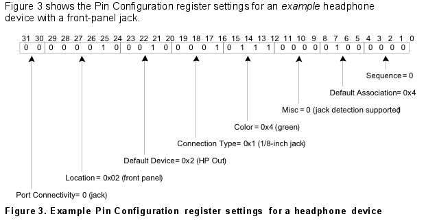

Zappadoc Posted April 8, 2006 Share Posted April 8, 2006 If i understand the register as to be set like this: line out 0x0421421F: 00 000100 0010 0001 0100 0010 0001 1111 line in 0x04811020 (CfgDflt default): 00 000100 1000 0001 0001 0000 0010 0000 line in 0x04A11021 (CfgCurr Current): 00 000100 1010 0001 0001 0000 0010 0001 default config for headphone from pinconfig.doc: 00 000010 0010 0001 0111 0000 0100 0000 Link to comment https://www.insanelymac.com/forum/topic/11202-sigmatel-high-definition-audio-intel-945-chipset/page/3/#findComment-91644 Share on other sites More sharing options...

Zappadoc Posted April 8, 2006 Share Posted April 8, 2006 According to the pinconfig doc (see below) and my result on line in and out the default association must be 0xF (first 1111 binary) so I think that at the top of info plist I must declare the codec with SPDIF_In = 15 (0xF) PinConfig.pdf Link to comment https://www.insanelymac.com/forum/topic/11202-sigmatel-high-definition-audio-intel-945-chipset/page/3/#findComment-91808 Share on other sites More sharing options...
