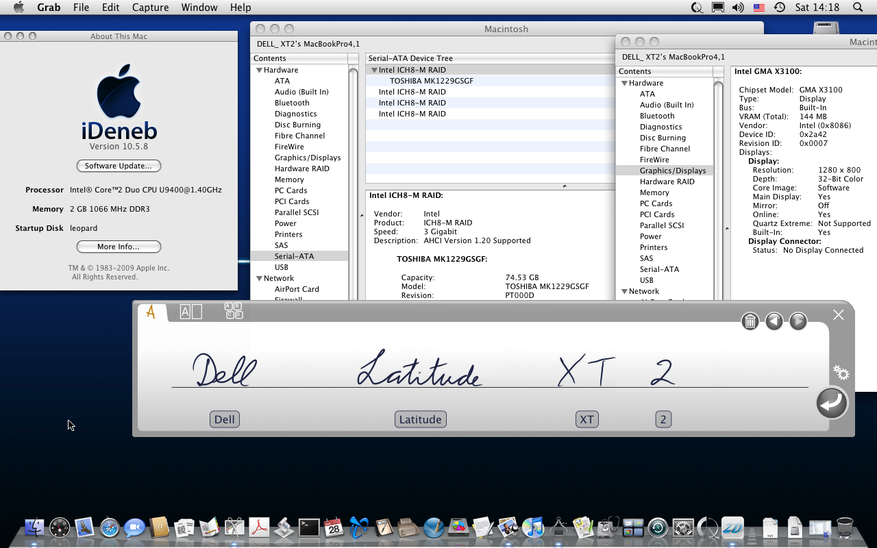

pegasys Posted August 28, 2010 Share Posted August 28, 2010 I owned a XT2 for a while recently - here's some info about a leopard install that I did. Compared to the original XT (ati chipset, hard drive not seen) it was straightforward - apart from a boot1 error. Used iDeneb v1.6, (10.5.8), other than the items already selected at the customise screen, I also selected 'intel ahci' and 'voodoo ps2' (otherwise you get a 'waiting for boot device' and 'no keyboard found' messages). Voodoo hda works great for audio. To get the correct resolution for the x4500 graphics I used the 'GMA4500_Native_Resolution.zip' at the start of this thread: http://www.insanelymac.com/forum/index.php?showtopic=192830 (Graphics properties then showed that I had a X3100 card!) Pen, Touch, mouse Pen and touch worked perfectly in leopard with no problems - thanks again to bognan_adnan's kext - but note that on the Windows partition I had the single touch (multi gesture) ntrig driver installed (therefore the digitiser firmware was also single touch - when you install ntrig drivers in windows, the ntrig digitiser firmware is also updated). I then installed the current multi touch ntrig drivers in windows to see what effect the multitouch firmware would have in leopard. On booting back into leopard, everything seemed normal (trackpad, mouse buttons, pen) - until I touched the screen - then the left mouse button stopped working and touch calibration would be completely out. Touching the screen with the pen would bring everything back to normal. So I reinstalled the single touch drivers/firmware NB it's usually recommended to uninstall current ntrig software before installing different ntrig software and to remove the battery and hold the power button down for 2 mins to remove the firmware (but please check for yourself what the correct procedure might be!). Link to comment Share on other sites More sharing options...
cuuler Posted September 3, 2010 Share Posted September 3, 2010 I owned a XT2 for a while recently - here's some info about a leopard install that I did. Compared to the original XT (ati chipset, hard drive not seen) it was straightforward - apart from a boot1 error. Used iDeneb v1.6, (10.5.8), other than the items already selected at the customise screen, I also selected 'intel ahci' and 'voodoo ps2' (otherwise you get a 'waiting for boot device' and 'no keyboard found' messages). Voodoo hda works great for audio. To get the correct resolution for the x4500 graphics I used the 'GMA4500_Native_Resolution.zip' at the start of this thread: http://www.insanelymac.com/forum/index.php?showtopic=192830 (Graphics properties then showed that I had a X3100 card!) Pen, Touch, mouse Pen and touch worked perfectly in leopard with no problems - thanks again to bognan_adnan's kext - but note that on the Windows partition I had the single touch (multi gesture) ntrig driver installed (therefore the digitiser firmware was also single touch - when you install ntrig drivers in windows, the ntrig digitiser firmware is also updated). I then installed the current multi touch ntrig drivers in windows to see what effect the multitouch firmware would have in leopard. On booting back into leopard, everything seemed normal (trackpad, mouse buttons, pen) - until I touched the screen - then the left mouse button stopped working and touch calibration would be completely out. Touching the screen with the pen would bring everything back to normal. So I reinstalled the single touch drivers/firmware NB it's usually recommended to uninstall current ntrig software before installing different ntrig software and to remove the battery and hold the power button down for 2 mins to remove the firmware (but please check for yourself what the correct procedure might be!). hey pegasys, have you tried touch-base.com for the multi-touch driver? they custom build touch screen drivers for you and give you free trials to see if they work. Also, how fast does osx run on the xt? Link to comment Share on other sites More sharing options...
