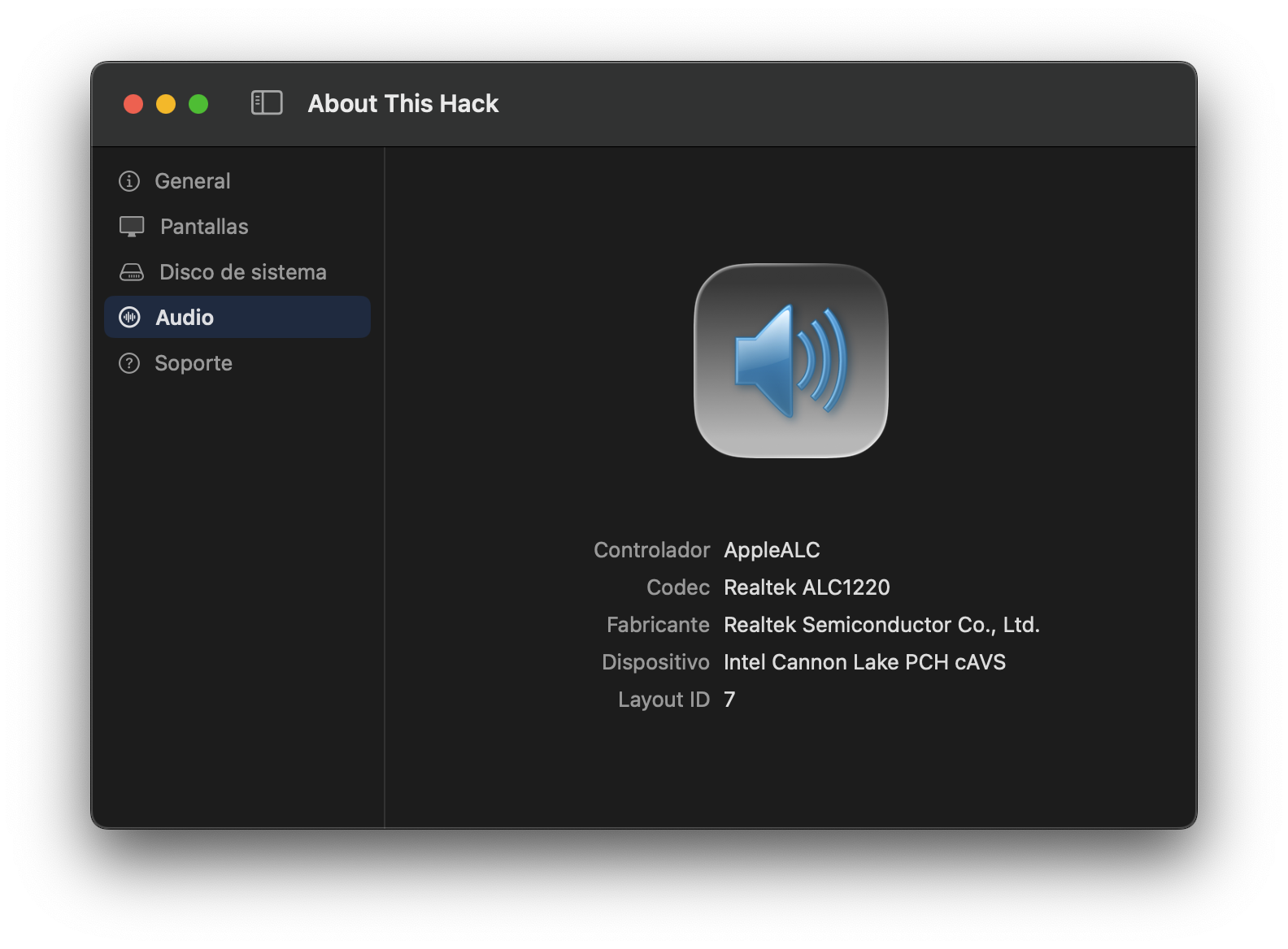

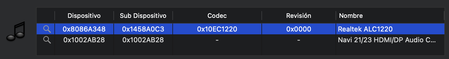

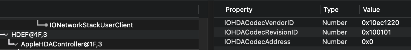

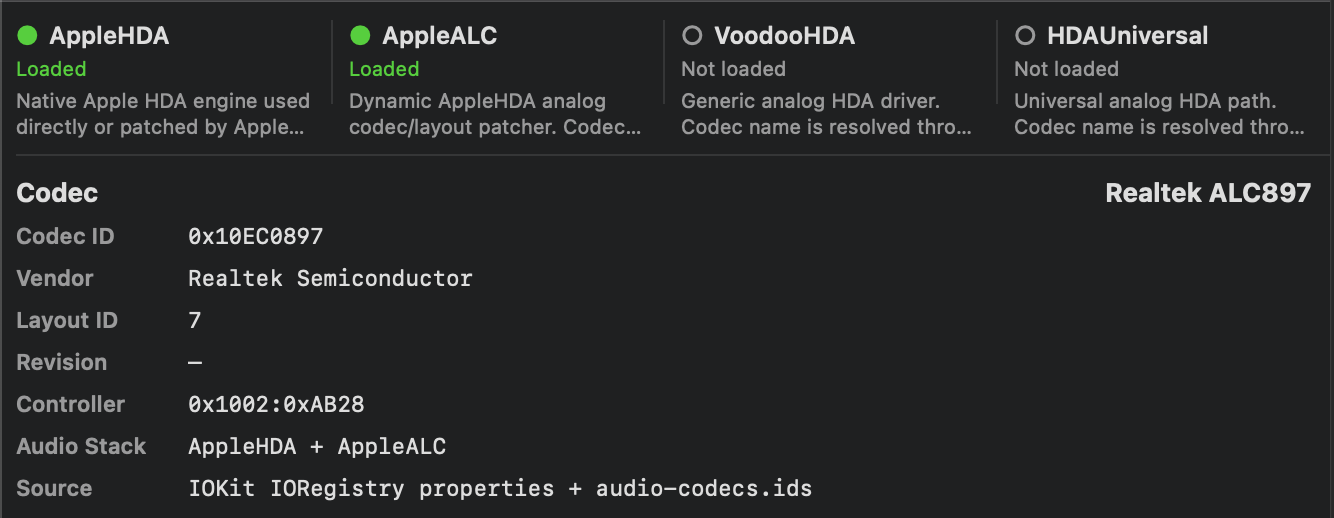

  2. @MaLd0n I have an issue with codce-info, just in case you want to check in. This is Sonoma with AppleALC. No root patches. I'm sure that my onboard code is ALC1220. It's what I see in IOReg, Hackintool and ATH. But codec-info says that my codec is ALC897. Attached the logs. HDAUniversal-Test-Logs-2026-07-03_13-45-01.zip
