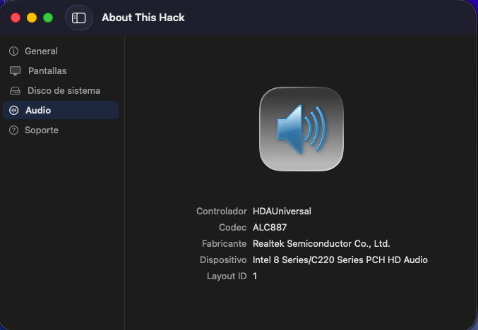

I re-tested UniversalHDA and VoodooHDA.kext 4.0 (in separate test volumes) just to be sure I am accurately reporting my test results. Through multiple sleep/wake cycles, macOS silently enters/exits sleep when using VoodooHDA.kext 4.0, but makes a loud "pop" with UniversalHDA. This is not enough of a problem to warrant much effort (my opinion), but I'm just reporting in case you want to fix. Note my tests are performed after updating to 26.6 Beta (25G5057c). The previous test was performed with 26.6 Beta (25G5052e). Attached are new logs collected with HDAUniversal-Collector after repeated sleep/wake cycles using HDAUniversal. The zip generated by Collect-HDAUniversal.command: attached Your codec model: Conexant CX20632 Your layout-id: 20 macOS version: 26.6 Beta (25G5057c) Bootloader used: Open Core 1.0.7 Whether the kext is installed in /Library/Extensions: Yes A clear description of the problem: On transition to sleep, audio generates a loud "tick"/"pop"; On wake, audio generates a loud "tick"/"pop". I do not observe this with VoodooHDA 4.0 or with AppleALC/AppleHDA. Steps to reproduce the issue: Sleep and listen for loud "tick"/'pop"; Wake and listen for loud "tick"/"pop" EDIT: Note that when using VoodooHDA.kext 4.0, the HP EliteDesk 800 G4 Mini requires DisableInputMonitor=True to avoid loud "pop" on macOS startup. EDIT2: @MaLd0n I think I have additional information that might offer a clue about what's going on. With HDAUniversal when my HP EliteDesk 800 G4 Mini enters sleep, the audio is not "completely off." When sleeping with HDAUniversal, there is an audio "buzzing" (from the speakers) that modulates in sync with the flashing power LED (flashing during sleep). With VoodooHDA, the audio is completely silent - there is no audio "buzzing" sound from the speaker when sleeping. HDAUniversal-Test-Logs-2026-07-07_15-26-06.zip

I need to test it, but it will be after the holidays. I have three computers where it works perfectly. My question is: On all three computers, I have both Tahoe and Tahoe beta with the corresponding AppleHDA patches and both Intel and Broadcom Wi-Fi. My question is, is there any way to disable AppleALC and PCI or boot-arg injection so that it only loads on the system where I installed the kext? Or is my only option to create a bootable USB drive to test it on the hard drive of one of the three computers where I have the operating system installed? I'm not sure if this is the right question.
