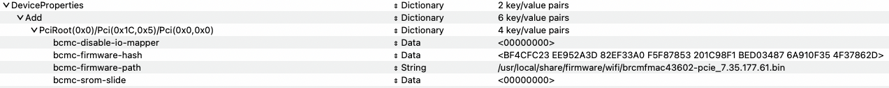

  2. but is AppleVTD activated? (it should, because I guess it would cause a KP otherwise) I've only added the mandatory properties according the documentation: disable-io-mapper, firmwre-hash, firmware-path and srom-slide (would only be required for 4350 chips but doesn't hurt) you can verify if the kext is loaded with kextstat + you can grep the bcmc related log entries (Acidanthera's debug enhancer is required for dmesg) kextstat | grep bcmc sudo dmesg | grep bcmc

  6. @schrup21 I tweaked a bit my config.plist file removing a device property line "bcmc-srom-slide" that I defined as 00000000 and added the property "bcmc-disable-io-mapper" defined as 00000000 which is what you add. The computer now arrives at the desktop but frozen, which is different from what I was experiencing, as before the computer was freezing on a black screen that shows up after the Apple logo disappears. I verified again the boot args and device properties and nothing else has been messed AFAIK. wifi.log.zip
