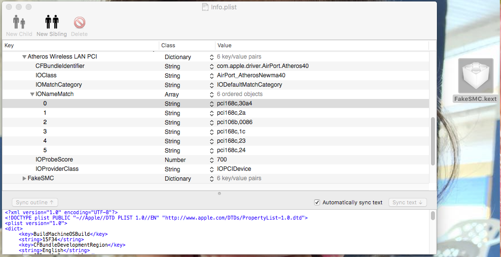

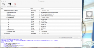

Hi all,
For me (P5K mobo + Atheros PCI card ) airport is 100% ok in 64 and 32 bits with the netkas fix :
http://files.netkas....rosFix.kext.zip
Install in /E/E/ et add your chipset vendor Id in /Extra/Extensions/AtherosFix.kext/Contents/Info.plist
ie: mine is 168c,1a
<dict>
				 <key>Atheros i386</key>
				 <dict>
						 <key>CFBundleIdentifier</key>
						 <string>com.apple.driver.AirPort.Atheros</string>
						 <key>IOClass</key>
						 <string>AirPort_AthrFusion</string>
						 <key>IOMatchCategory</key>
						 <string>IODefaultMatchCategory</string>
						 <key>IONameMatch</key>
						 <array>
								 <string>pci168c,1a</string>
								 <string>pci168c,13</string>
						 </array>
						 <key>IOProbeScore</key>
						 <integer>65000</integer>
						 <key>IOProviderClass</key>
						 <string>IOPCIDevice</string>
				 </dict>
				 <key>Atheros x86_64</key>
				 <dict>
						 <string>com.apple.driver.AirPort.Atheros21</string>
						 <key>IOClass</key>
						 <string>AirPort_AthrFusion21</string>
						 <array>
						 </array>
						 <integer>60000</integer>
				 </dict>
		 </dict>

ok so I have found the Extra/extensions (I did not think about "hidden" files) I have played around with it I guess what I need to know is from about this mac /more info/airport card it says "wireless card type AirPort Extreme (0x168C, 0x137A) my windows device ID PCI\VEN_168C&DEV_001C&SUBSYS_137A103C&REV_01
PCI\VEN_168C&DEV_001C&CC_020000
so I guess my question is what should I add to the plist? I am not as experienced as most of you guys any help would be very nice :)
